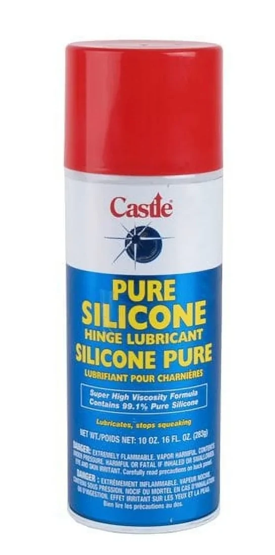

When using silicone spray make sure you find the one that is 99% pure. Many others use too many distillates that's not adding to the lubrication.

I used Armoral on my 2020 and it work well.
