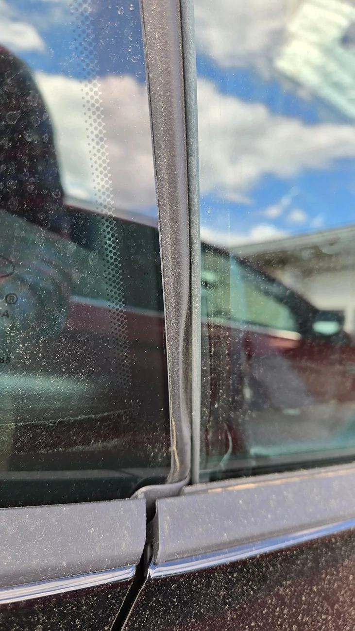

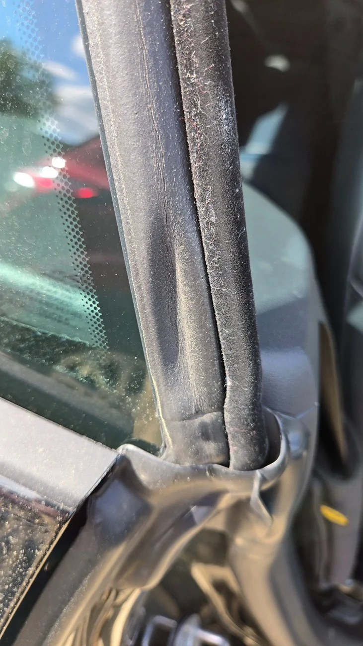

I took mine in for service a couple weeks ago and they lubed the window seals. That seemed to help for the first few days but it also got silicone grease all over my windows and the sweeps. The windows also stopped sealing after a few uses. The seal on the front of the rear window is actually deformed. I assume it's hitting something when it goes down. After telling me that Ford probably wouldn't cover it under warranty, they did. The dealership ordered a new seal for the window and I just need to schedule an appointment to have it installed. I'm going to ask them to check the window alignment because I think it's going to be a recurring issue. I attached photos of the deformed seal.
