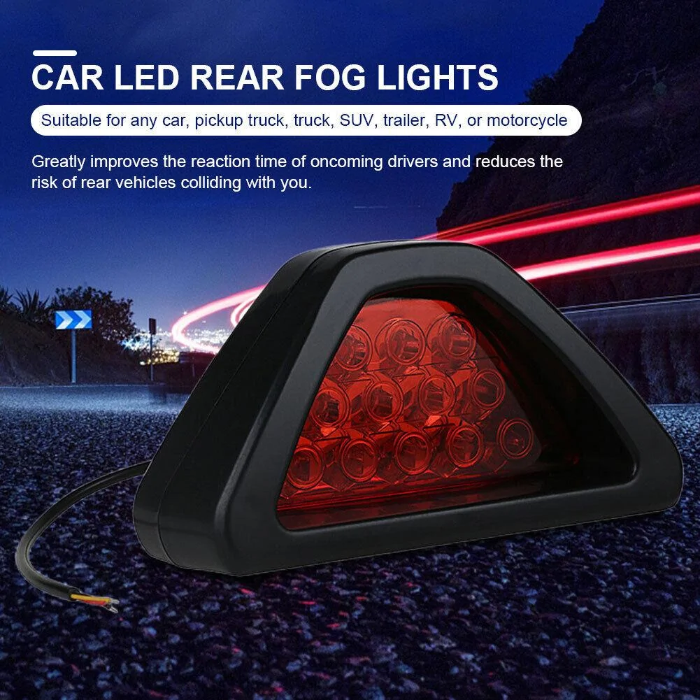

Relax pals… Focus on the original topic
Think you can hook up some sort of bright red led lights… but wiring them is probably annoying.
S650 Mustang Rear fog lights IMG_5169
Yeah, I guess it needs to be wired because the European law says as followed:
- Rear fog light mandatory
- Rear fog light should only work when headlights are on and should go off when headlights are off.
- Fog light switch on the dash with a orange light on the switch to know that the fog lights are turned on.
4,852
2,675
I think as you initially indicated there is a thread over on 6g re switch and light and maybe even forscan but the question remains re compatibility with 7g.
https://www.mustang6g.com/forums/threads/mustang-2017-us-to-eu-spec-rear-fog-light.117176/

This must be hard wired. Does it work with forescan?
