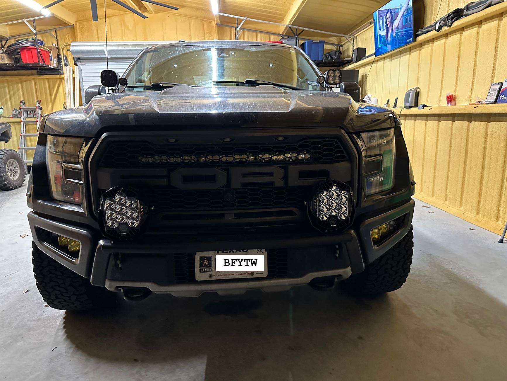

1k is enough to temporarily blind someone up close. For reference, Baja Designs Squadron pros are 4900 lumens each. The squadron ‘sport’ are half that. I used those for chase lights on my Raptor. They hurt to look at from about 60 yards away.
Baja also makes SAE fog lights at 2400 / light, and they’re pretty respectable.
My point here is that at you’re looking at something 6x as powerful.
Yes, they absolutely will mess with oncoming drivers, notably on hills. as you crest a hill and start coming down, the fixed beams angle down right into the oncoming driver’s eyes. Normal headlights aren’t typically that powerful to cause a problem, but if you’re carrying weight / cargo and changing the aim of the lights, you will not have many on road friends.

3) Beam. (not Jim) if you are campaigning a true wide beam fog, you absolutely should have a vertical cut off. The rear facing lights on my Rap are wide cornering - throwing light in every direction. They’re 2400 LM each and when I had them on the front were fantastic for illustrating road side critters, but absolutely SUCK in actual fog because they create a white out - like your high beams. Ditto for snow, or dust.
if they’re spots, you won’t have as much coverage of the area you’re not aiming at. But you will get more forward projection. If you check out the lights on my Rap, I have 6x squadron pro lights, 4 of them are amber covered. Those are combo lights spot/corner and aimed very low. They’re great in fog but I still dim them in oncoming traffic because again, easy to night blind an oncoming vehicle.
