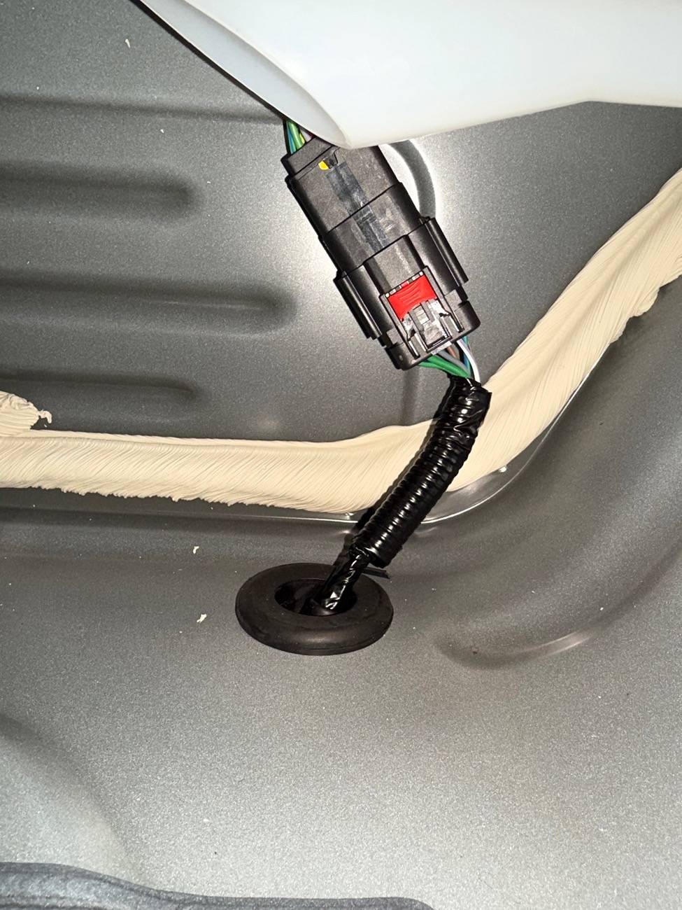

I would not think so either but what do I know. For that fact, I could be looking at the wrong harness but that is the only harness that runs through the trunk and looks to plug into my active exhaust. Does your Mustang have Active exhaust? A picture of the harness on a DH or PP would be good.
My buddy sent this pic from a dark horse. Little hard to tell but it looks like the wires coming out look the same as a non pp with active

From the angle provided, it looks the same. Maybe I have the wrong harness but that is the only harness extending through the trunk. It connects to the active exhaust, backup camera, and the charcoal canister from what I can tell. I'll look some more this evening.

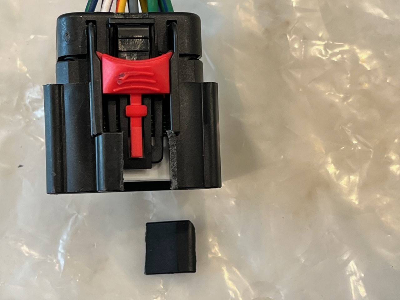

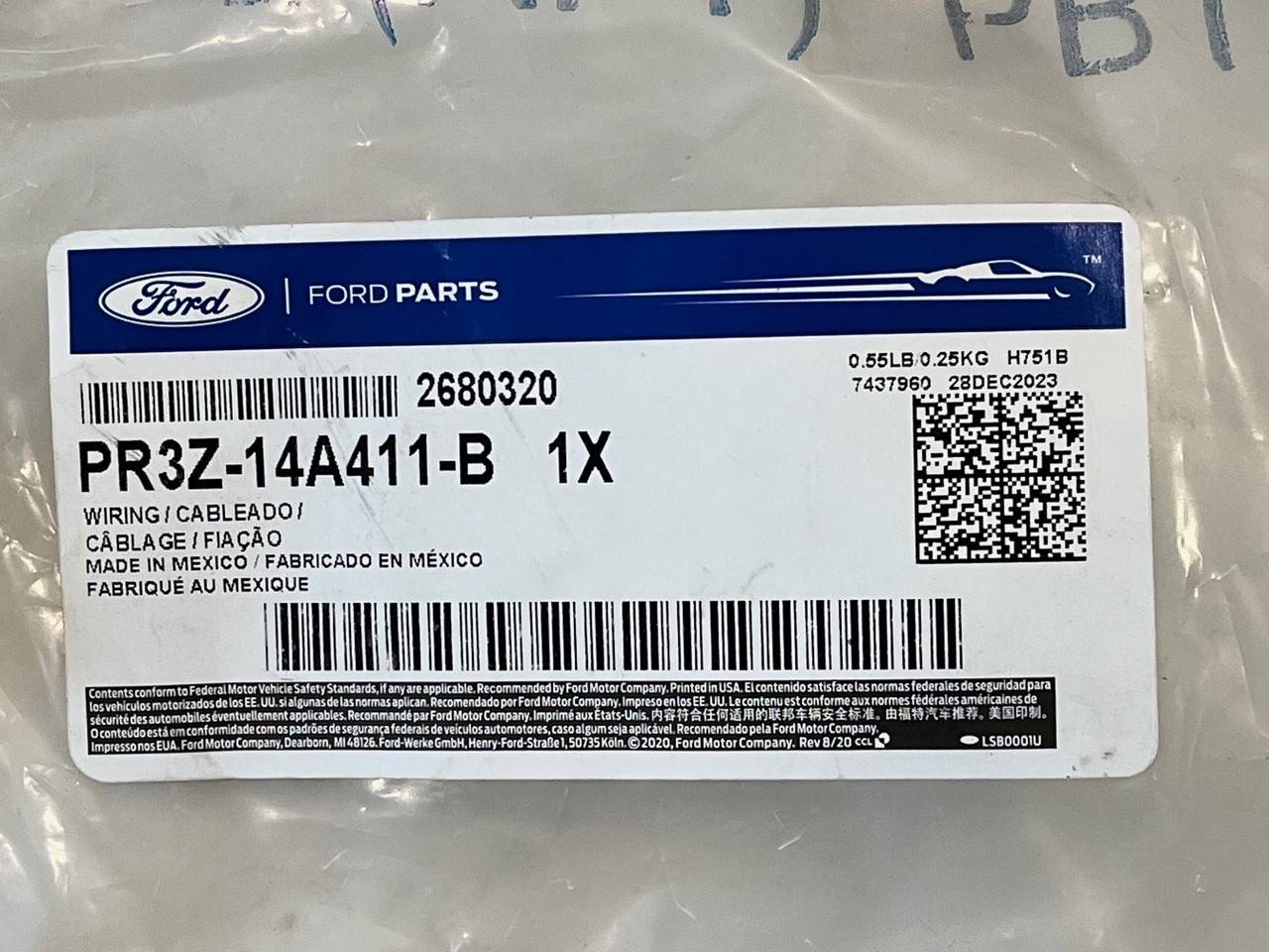

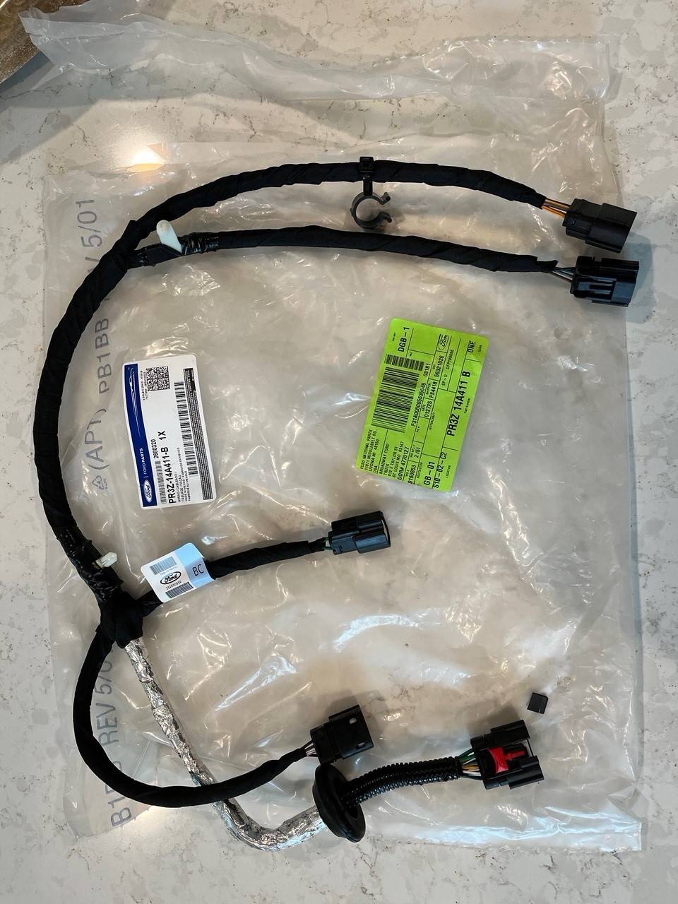

Harness arrived today. Unfortunately, the main harness connector was broken so I am attempting to send it back. That being said, from what I can tell it appears to only be the replacement harness that runs through the trunk and connects to the active exhaust and charcoal filter. It does not have the pigtail connector that would extend to the rear differential and connect to the temp sensor. Unless someone has pictures of the harness and routing, my next step would be the dealership.

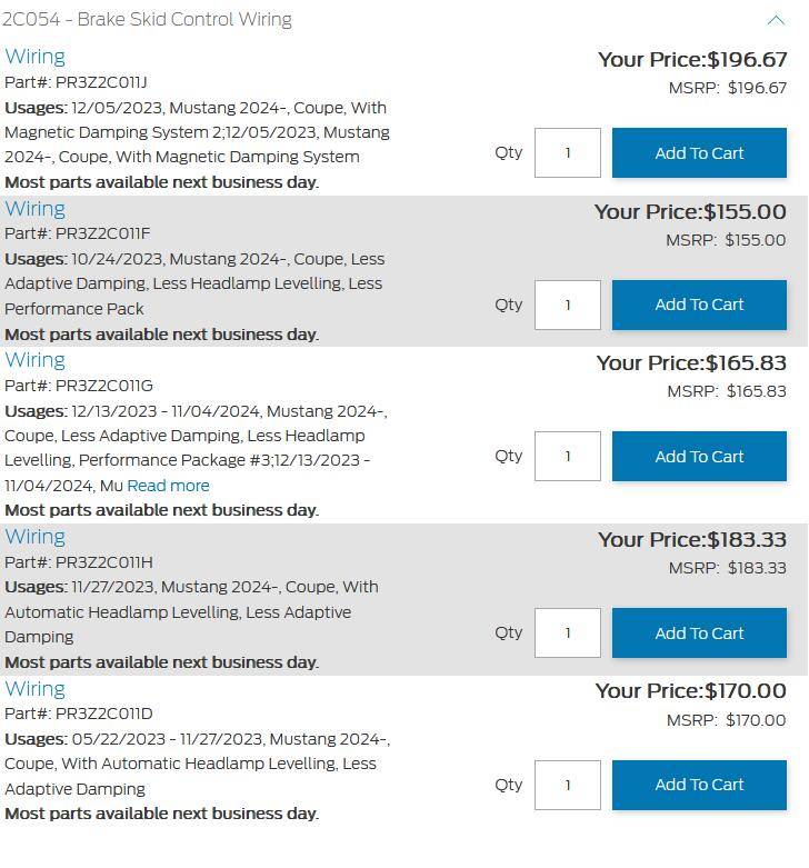

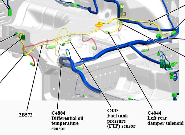

Looking at the wiring diagram I am seeing another jumper that could possibly be the one for the diff section 2C054.
That blue connector that points towards the front of the car looks to be in the same position as pictures of the connector on the pp or dark horse. Reading the descriptions of the part I see something about headlight leveling and adaptive dampening. I am confused about the headlight leveling as i am confused if that is part of a magneride adjustment system.
I believe that the correct harness is the part number that ends in G which is https://parts.ford.com/shop/en/us/wiring-(convertible-coupe)-p-pr3z2c011g?pdp=y#/sectionId:854266145 . The one that ends in J probably has the diff plug too as magneride is only possible with PP.

I searched the part number for the wire harness you bought and saw the diagram on ford parts website
https://parts.ford.com/shop/en/us/wire-looms-and-connectors/wire-jumper-50l-(coupe)-p-pr3z14a411b?catalogId=251&dealerId=24400&storeId=1405&langId=-1&krypto=4fVWXk24ozPwYpOfnfqkUdcEWenRa1JDTfQ913hmoIyAoUjsYMATT0/vJsQOptiIEK9N2XMoZsaZReJw8W8Fe/4jjlyCc5sPoqhuXoyKZdk=
Unfortunately i havent had the time yet to remove the interior pieces to confirm that it could possibly route to the diff but i will send an update when i can. I do believe that this wire is towards the front of the trunk as i have gutted the car to do some racing and vaguely remember a harness around that location. I am also going to add the differential cooler but dont know whether to get the dark horse oem or steeda as ive seen that both use the same cooler housing.
looks like you're right. i was wrong about the wiring harness. so the good news is we now know what harness it is. the bad news is that this harness looks to be rather complicated to uninstall and reinstall. looks like the harness in question is PR3Z-2C011-G. sorry again @Cool66 for giving you the wrong part number
