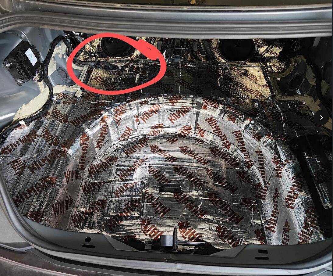

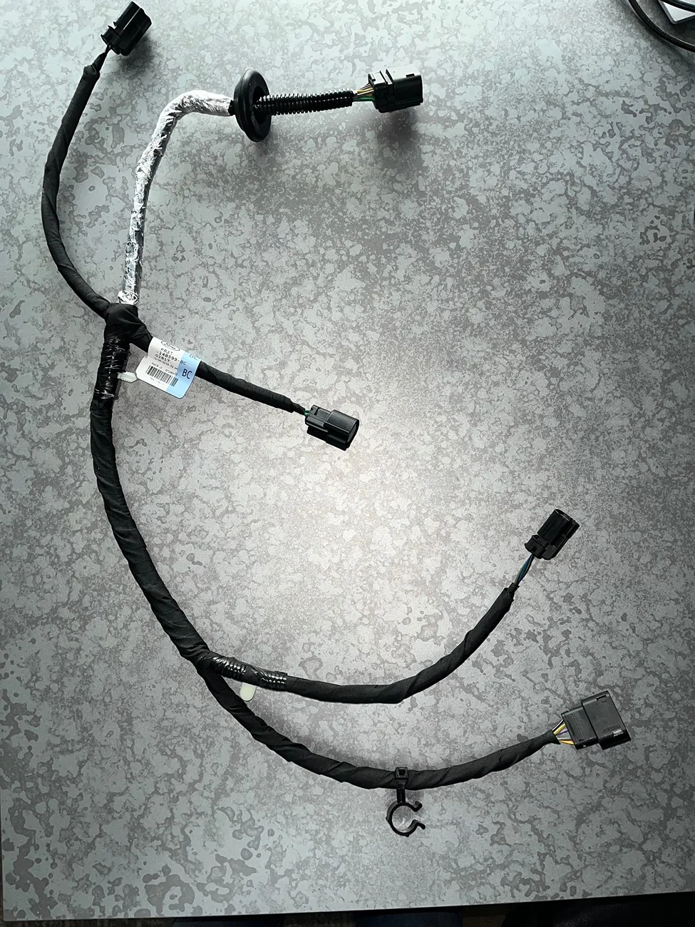

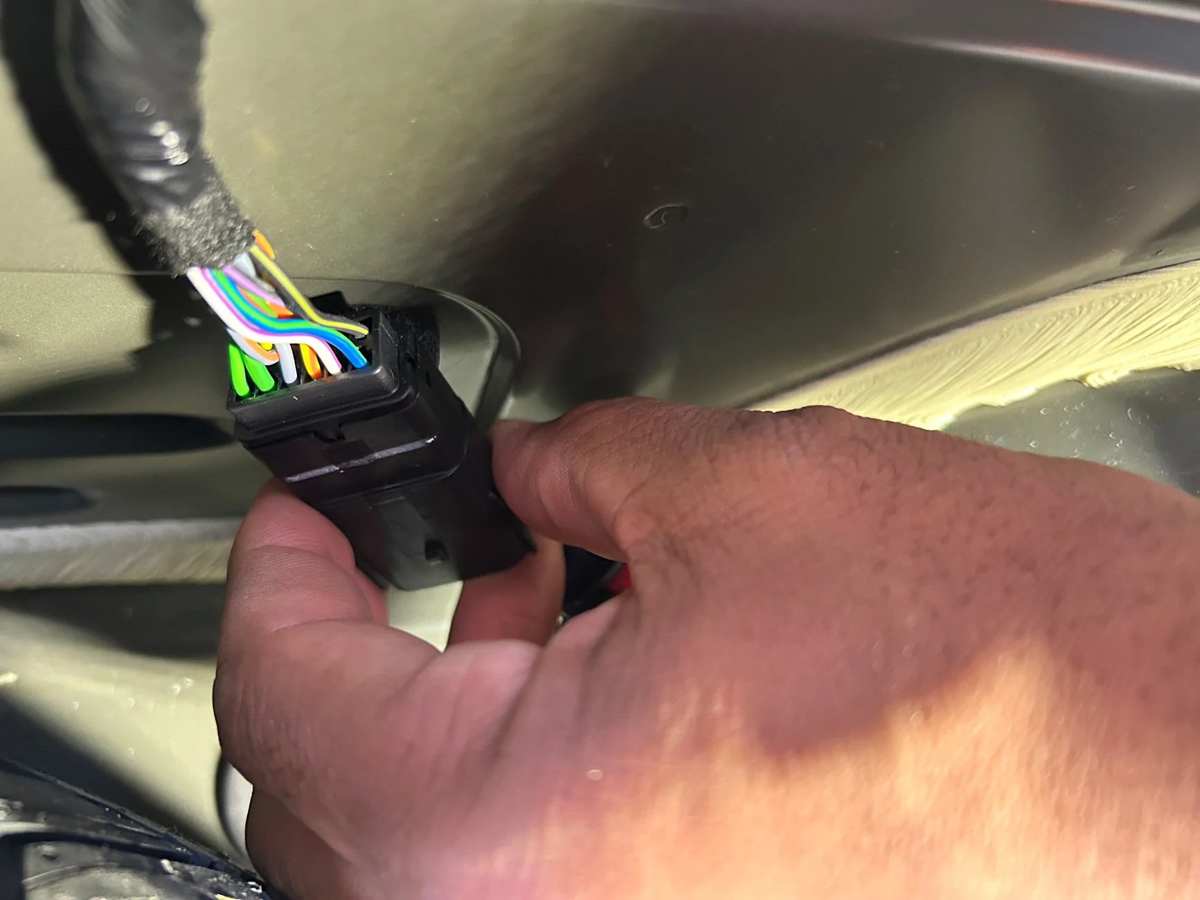

The portion of the harness running through the port in the truck, are those for the rear abs?
I’ll be taking the rear seats and the trunk lining out tomorrow and will port the pictures.

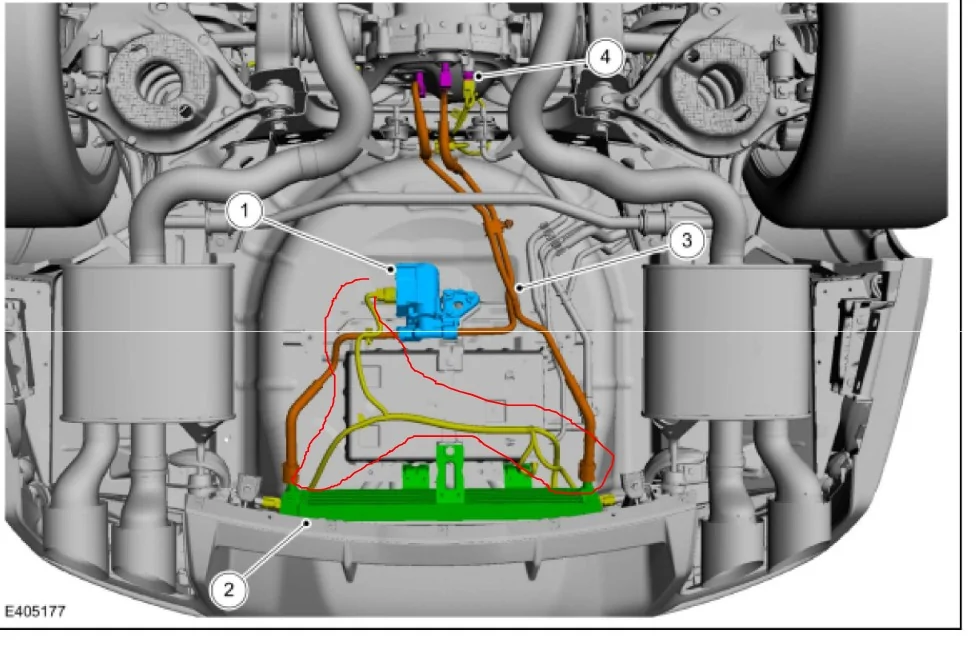

I have not. Have you made any progress? I just installed the PP radiator to complete the PP engine upgrades. Next step is the rear differential cooler. I have the harness that controls the pump as well as the diff temp sensor. I need to remove the back seat and locate the harness the temp sensor plugs into. Slow process. I can say the PP radiator made the difference in my oil temps. The algorithm that calculates the oil temp is tied to the the coolant temp. We ran the roval at Charlotte two weeks ago and oil temps never got above 225. Rear differential cooler is all I need at this point. Will also be adding the DH Track Pack rear diffuser at the same time.

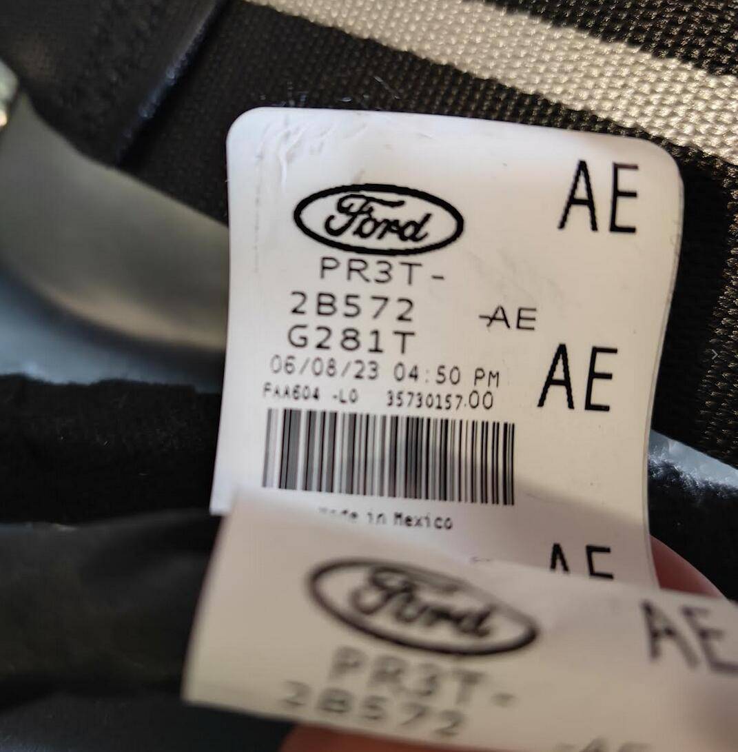

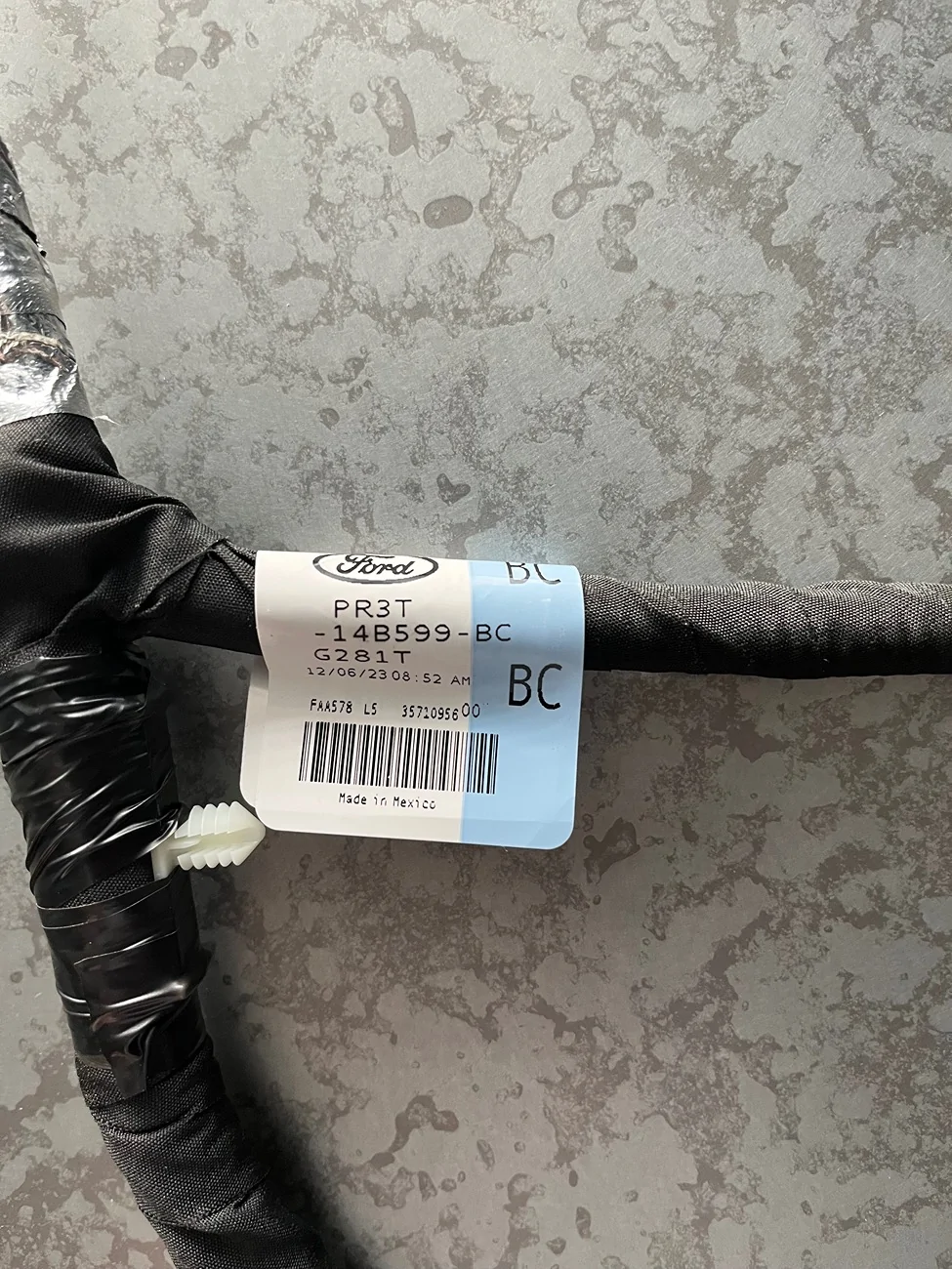

I plan on doing the upgraded radiator then if that’s what controls the oil temp. I already did the oil cooler. This is the part number for the PP radiator regardless of its auto or manual? PR3Z-8005-A
68
2,085
3,071
https://performance.ford.com/conten...Horse-R-Homologation-Version-5-06.14.2024.pdf

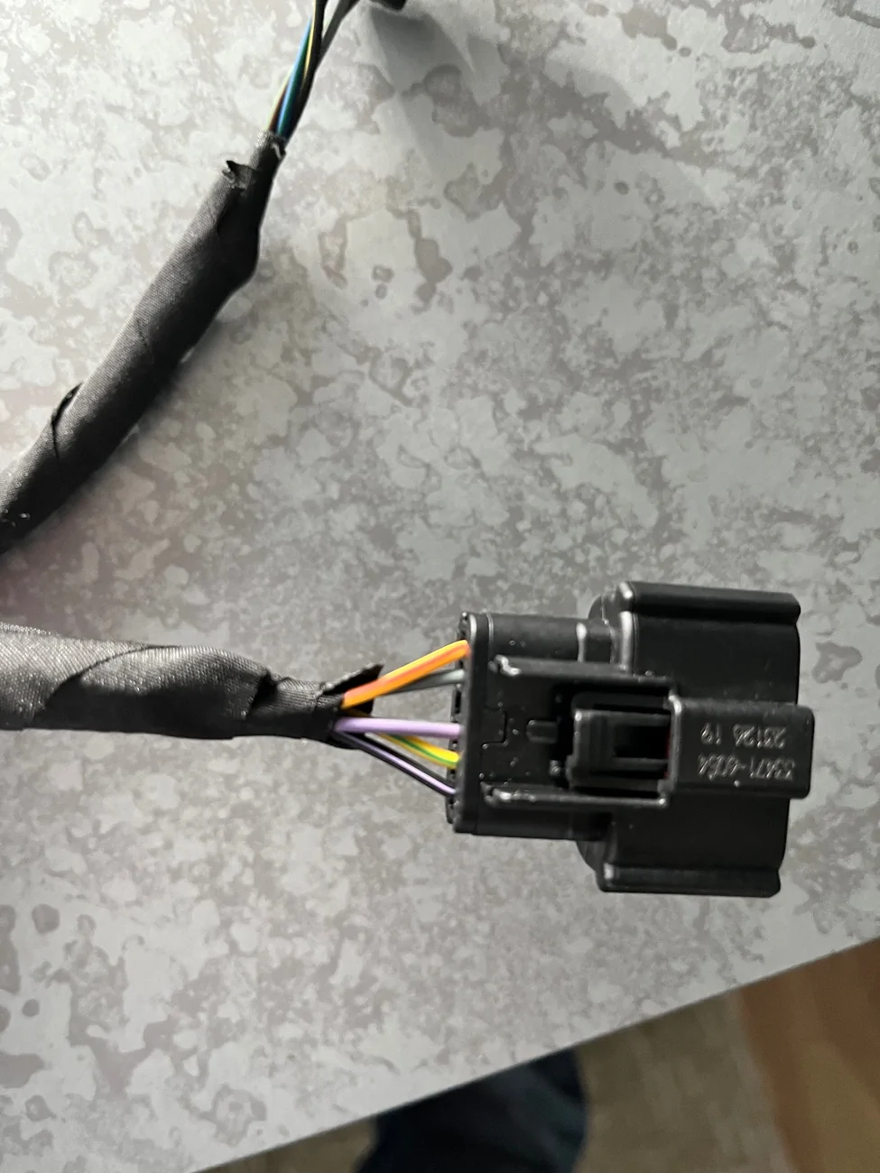

Wierdly i am struggling to find the part thats linked to this number but i am now sure i am looking at the right harness.

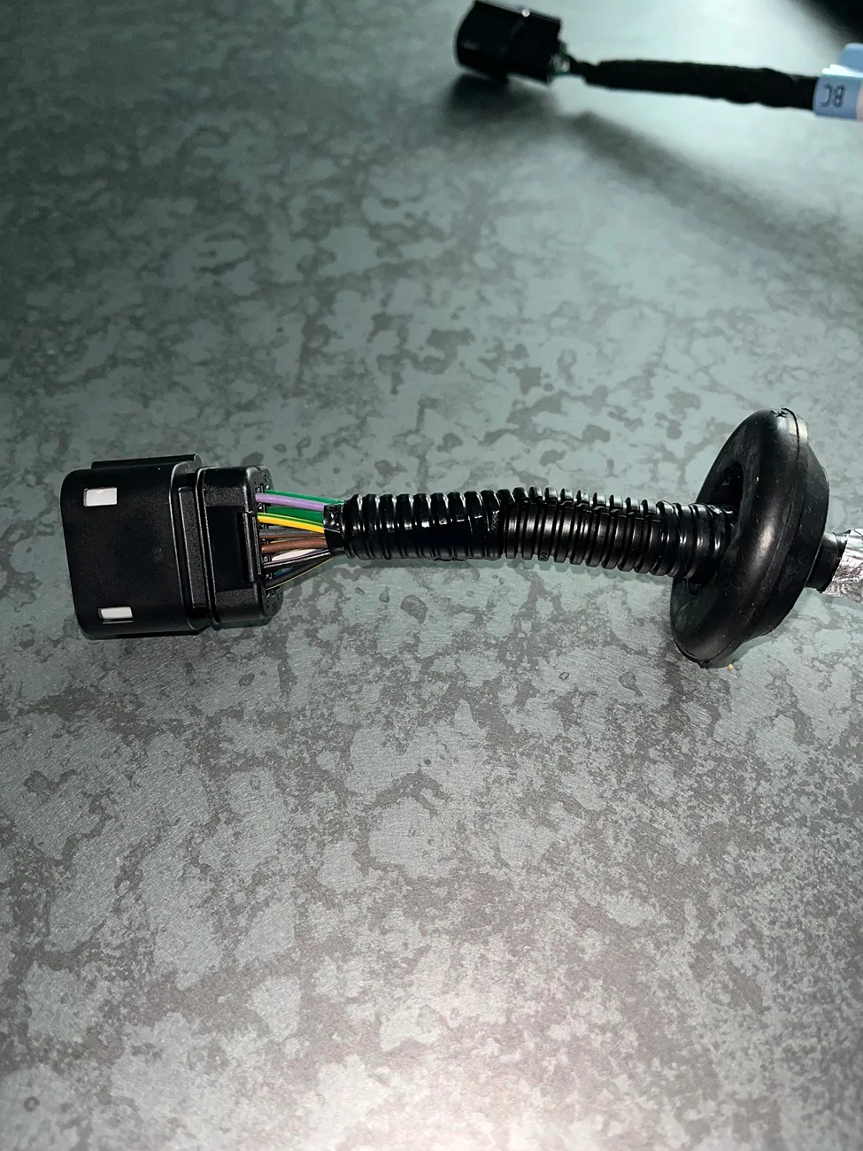

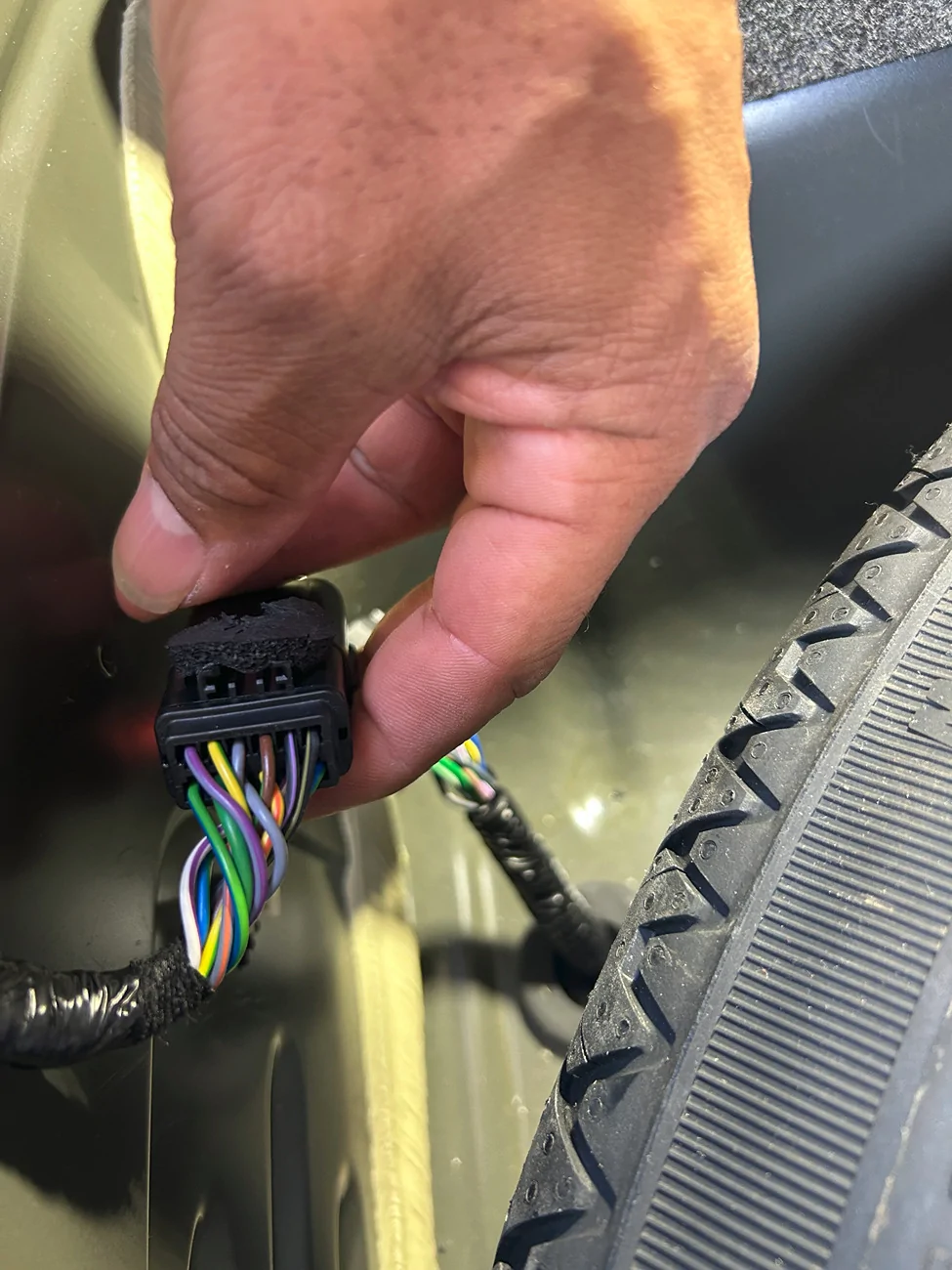

the reason why you are having a hard time is because that is an engineering number. i looked up that engineering base number using my DH VIN and found this for that harness: PR3Z-2C011-E. due to the fact every DH has Magneride, and only the DH has the differential cooler, if that is the correct harness for the diff temp sensor, it will have unused plugs where the Magneride dampers would normally plug in. i also managed to find a PDF from Ford Performance that lists all the parts used in the Dark Horse R, and this line caught my eye
