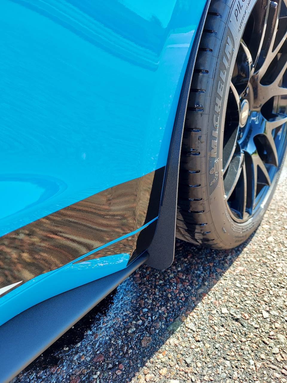

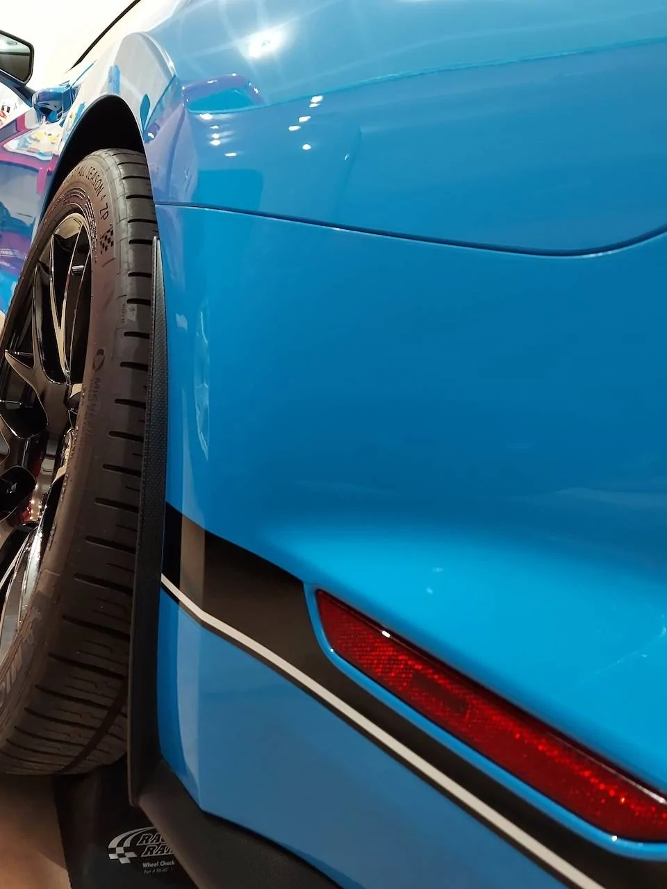

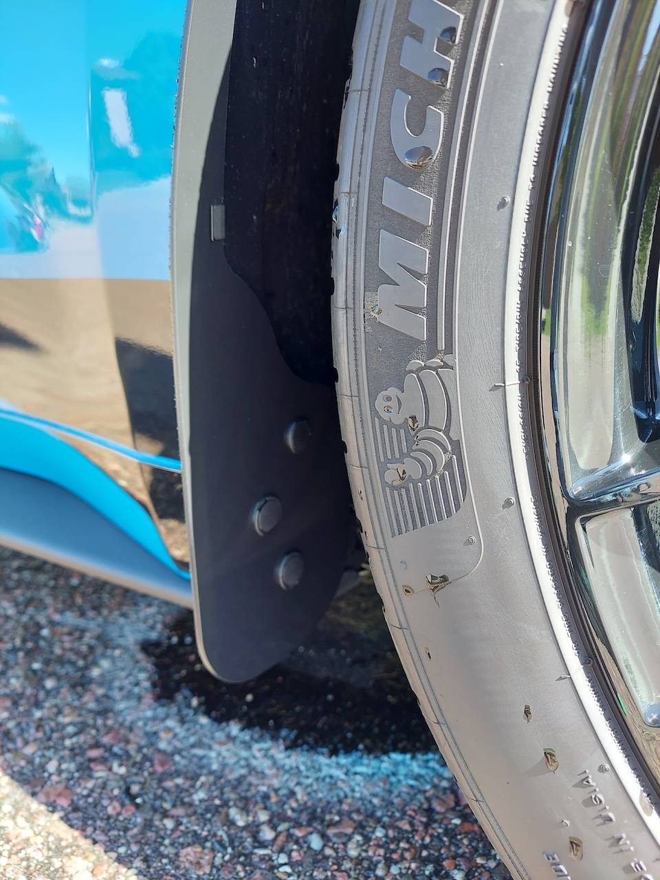

Did you do in front of the rear tires, where the fender bulges out?
Yes. I'm fortunate in that my budget allowed for complete PPF coverage. Setting that example aside...
From behind the front tire to in front of the rear tire, I could see a strip of PPF being installed there, the length of the rocker area. The height of the PPF could be what that person was comfortable with. A foot? And then a like strip from behind the rear tire to the end of the panel.
Another option would be to install PPF behind the front wheel and in front of the rear wheel, large enough bits the client would be happy with. Special sections only. The full length of the rocker panel seems better though. Before installing some front flaps, I was noticing water and debris spray all along the rocker's path. And one piece would appear better, give better coverage.
Any stripes involved are yet another variable. I consider my factory rocker stripes as sacrificial layer. They are not protected. I expect to have them removed and replaced when the PPF gets refreshed around the 10 year mark. One can have the stripes PPF'd as well, but I didn't feel the money spent would be worth it.
Finally, some fender flaps. The factory rear flap on my car was working fine at preventing most things from being kicked up behind. But up front, the factory wheel arc flares were lacking in some places and aspects; they were not wide enough. I recently installed some front flaps from ZL1 Add-Ons. The stripes were looking OK, but I realized with no protection, they'd need to be replaced sooner than expected. The front and rear flaps are keeping things from getting chewed up at the most stressed areas: right behind the wheels.
So...a layered defense. Flaps take the worst of anything the road has to offer, with PPF taking on whatever makes it past.
All this gets to the discussion with the installer. While I've given some ideas, a detailer with experience probably has several more, from placement to thickness of the PPF. They could also do a few quotes for comparison, between plotter-cut panel coverage from templates to custom section jobs.
