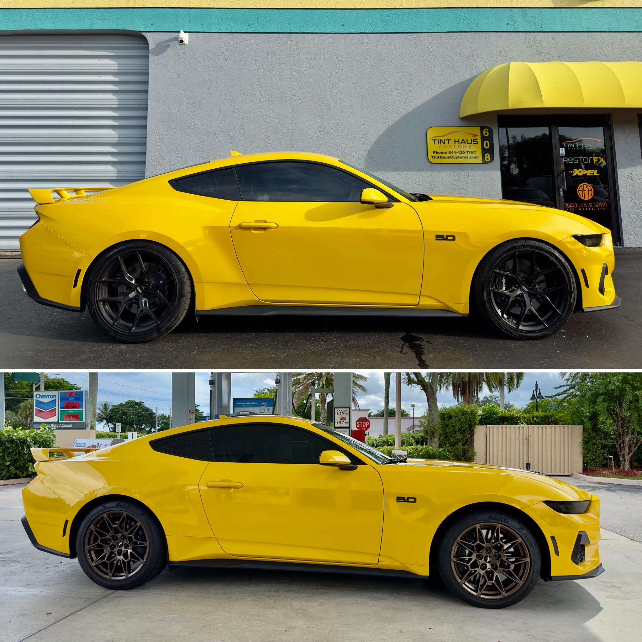

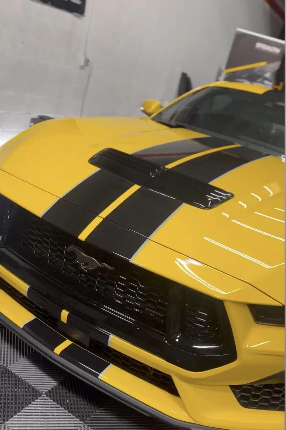

Haven’t had any issues, ford replaced seat, carpet
Since done a few mods
glad to hear! I was wondering how it was going with your situation
