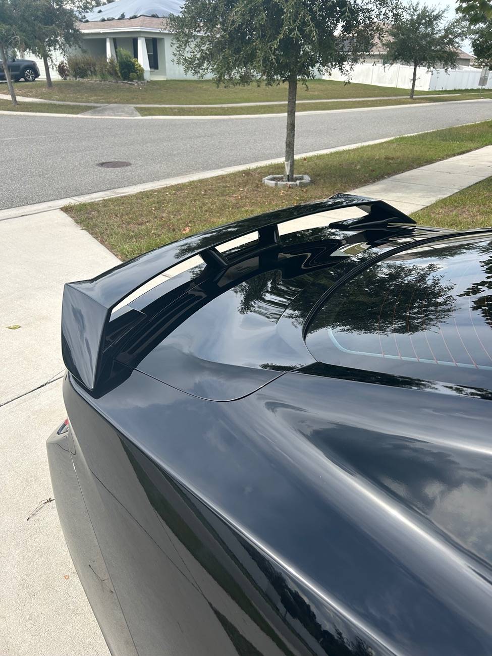

@Mikestang24 had the right idea:
After you clean off all of the double-sided tape from your car and your new spoiler, lay down the new 1/2" double-sided tape onto the wing, but leave on the backing with a good 8" of extra backing to grab later. (originally there are three sections of tape across the wing, but I put it all the way across)
Once all of the hardware (don't forget the camera) is transferred over, lay the module down in place and start all of the nuts/bolts but do not tighten them. Make sure that extra 8" of backing for the double-sided tape is sticking out and once the hardware is close to being tight, slowly pull the backing off of the tape... and voilà, the spoiler is perfectly in place, and the double-sided tape is secure. Tighten all of the hardware and you're done!
Huge and amazing difference!

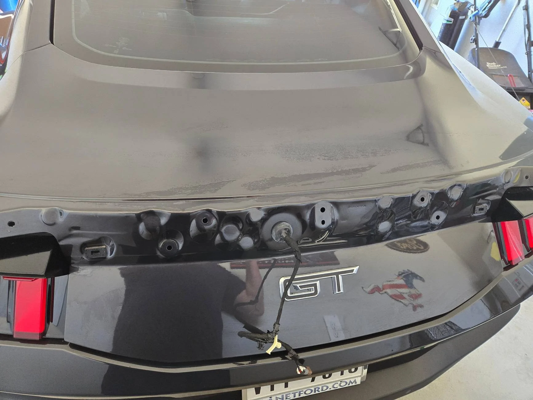

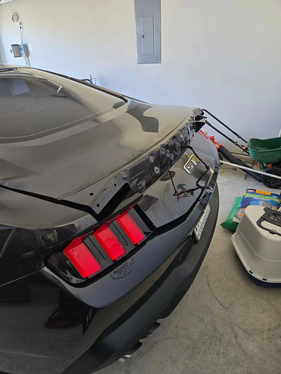

Happy new year. Got mine few days ago. Few questions:
1) do I have to remove the black foam/tape that is already there? and if so what should be replaced with ? 3M which part number is the best but also way to remove later on if decided?
2) Also the side of the trunk has two red patches , it seems that those haven't been used. Should they also be used?

  1. I removed all signs of double-sided tape both from the new spoiler and the car. This was the most time-consuming part of the entire install, but worth it to me. I used one of the ends of the plastic removal tools in the one link below and Goo Gone. Spray it on, let it sit, scrape and wipe off until it's all gone. Then, apply the new strip all the way across (link to what worked perfectly below). I know there are gaps in the tape that was on there, but I just put it all the way across. Leave long 12-inch "tails" of the red part of the tape on each side. Don't forget to swap over the camera and any other hardware! Then, when installing the new spoiler, lay it into place and start all of the bolts/nuts (make sure the tails are hanging out on both sides). Get them all snug so the wing isn't moving around... and then using the tails of the red part of the tape, slowly pull it out from both sides to the center. The spoiler will be perfectly lined up for the tape. Press it down good and finish tightening the nuts/bolts.
  2. My new spoiler had those two red patches/pads on each side, too. The stock one had something, but it wasn't sticky like the double-sided tape. I didn't remove a backing on those patches (if there is one), and just installed it the way it is in your picture.

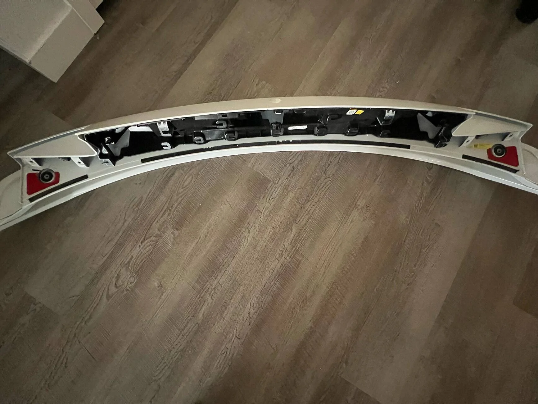

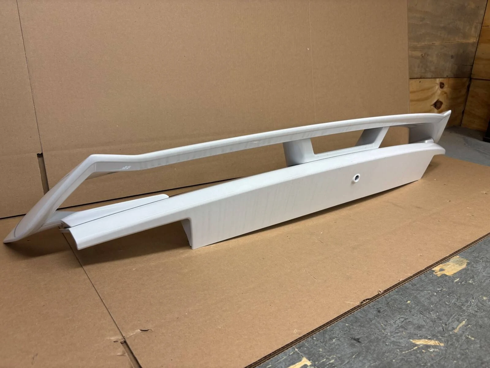

With these off take spoilers from BMZ, the vertical marks (that are especially apparent on Oxford White), are they simply dirt/grease that cleans off?
S650 Mustang Performance pack rear wing s-l1600
Or something else that necessitates a respray?
