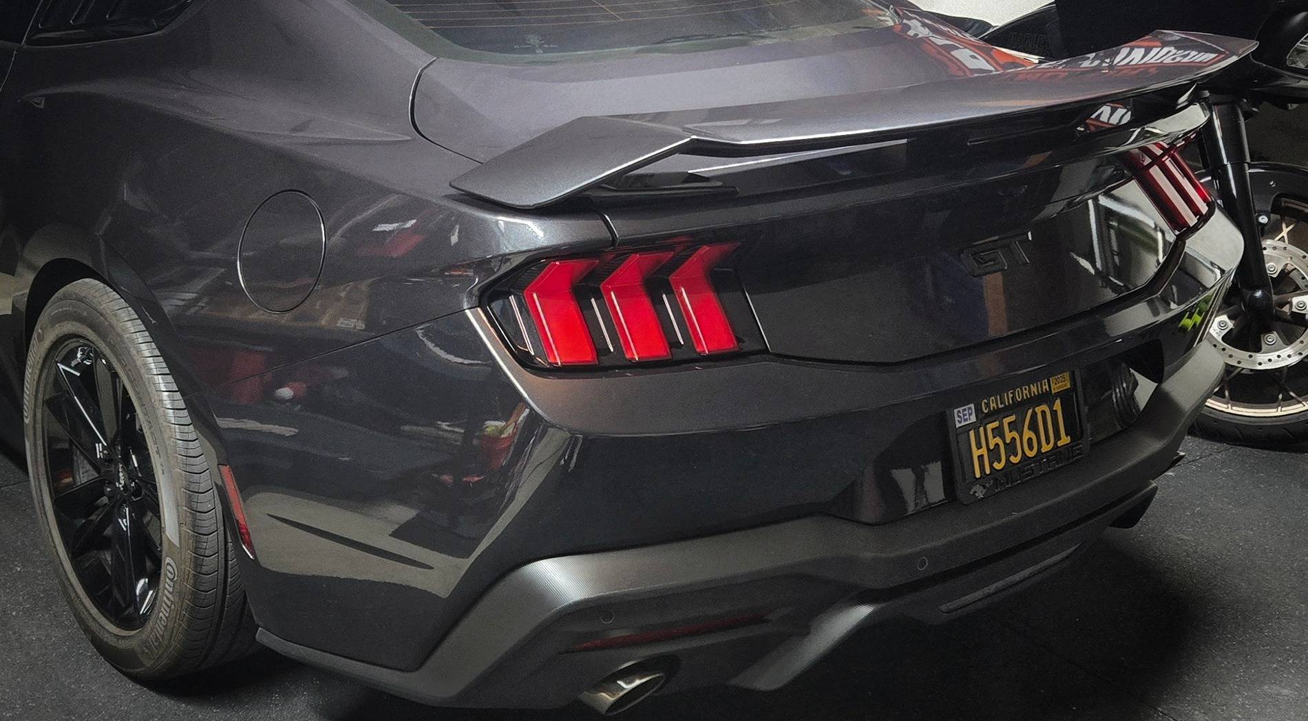

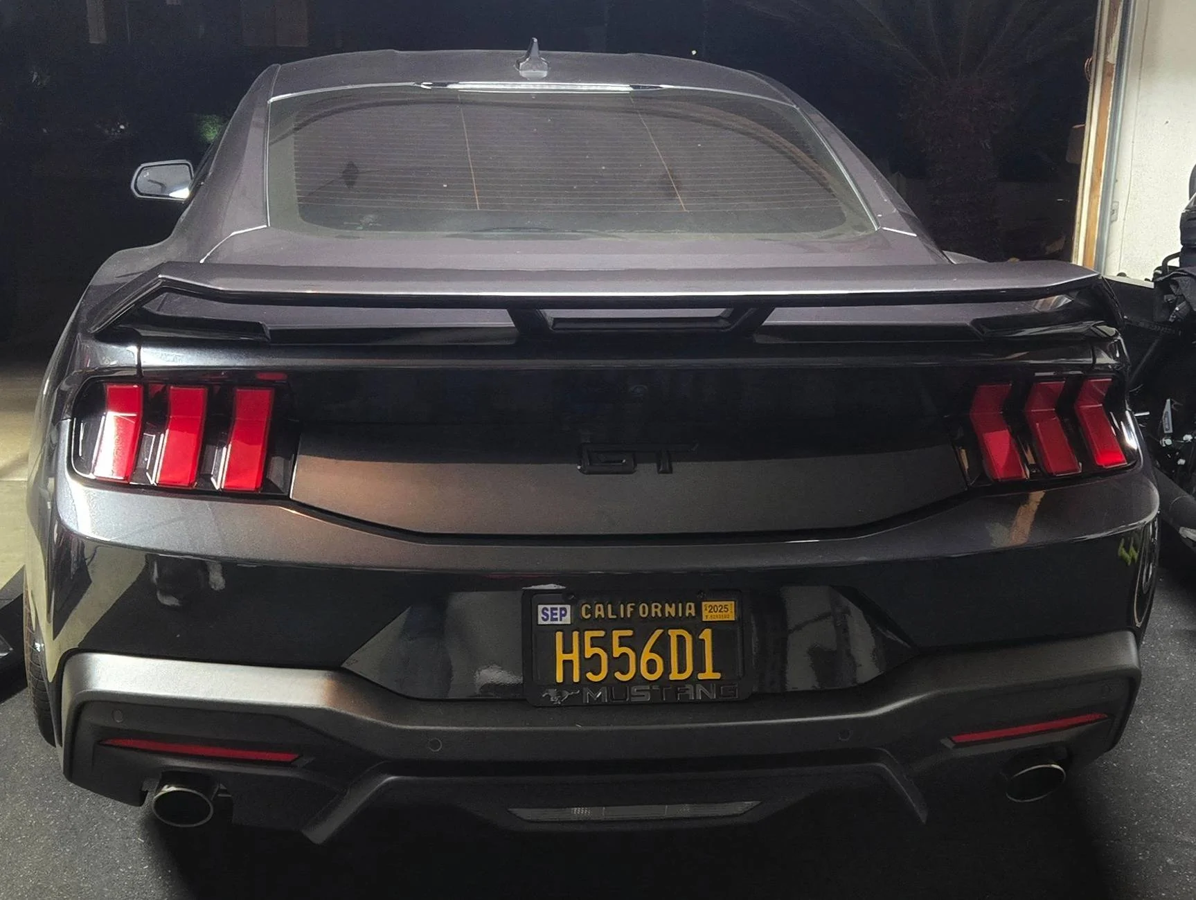

Mine came in yesterday. Came with module attached. Anybody got any info on camera removal and install on new unit?

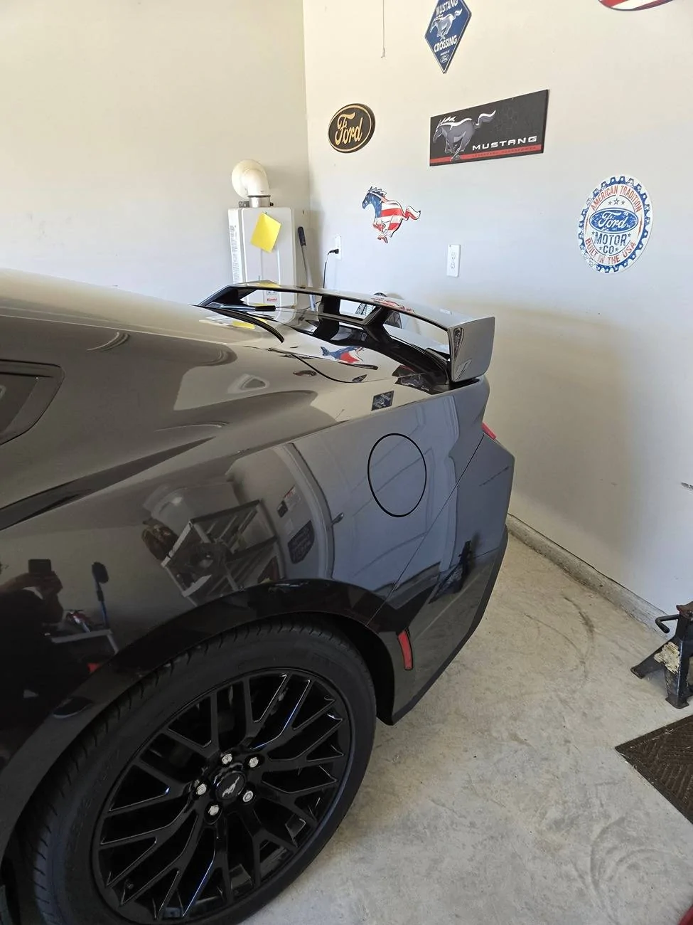

The entire module. It was easier that way. You'll have to remove the hardware off your existing module as well as the camera, but easy peasy. I didn't break anything! Is yours color matched? Looks like it would be a bitch to remove blade from module, as well as the new spoiler from its module. I needed 5ft of 1/2" 3m double sided black tape from auto parts store. I'd recommended a plastic scraper as well and solvent to remove residue from the old tape.

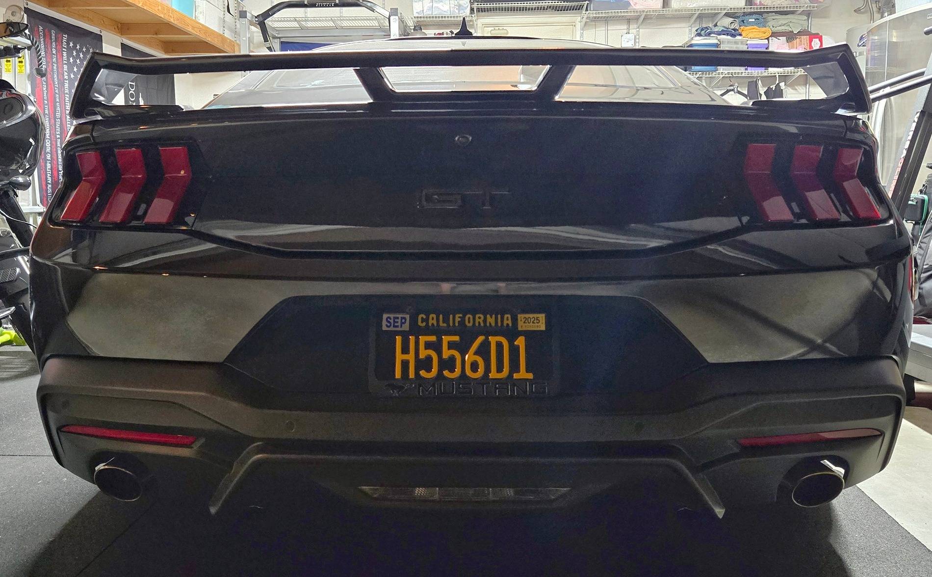

Just installed. Very easy. Very impressed with condition.
