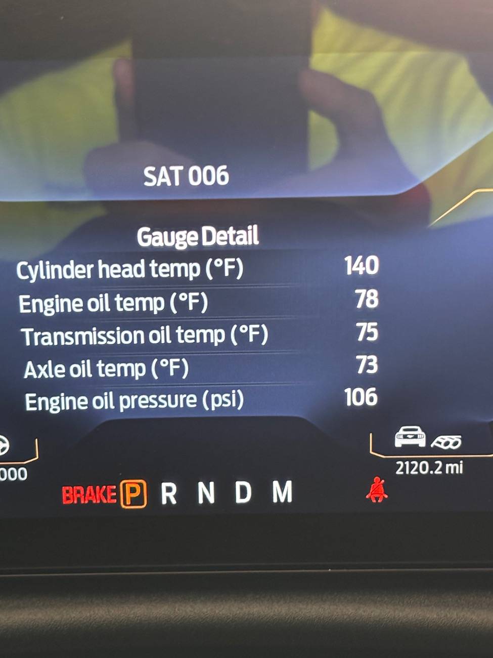

At cold engine start up my oil pressure runs between 105-110.
Is that normal for a cold engine? And should I wait until it drops down in the normal range before driving?
3,012
2,994
1. Your oil pressure gauge isn't a real gauge (edit: mixed this up with the previous cars where it could be a pressure switch and not pressure sensor)
2. 100psi is normal at cold start
3. No need to wait. Start it and go
It's normal. Your oil won't get to "normal" temperatures just idling. Drive the car, watch the gauge and take note of how long it takes to get to normal driving temps. It take a while.

He's asking about PSI not temp.
You're right, AZ_Ryan.
My bad on that but as his oil comes up to temp., the oil pressure will drop to "normal" as it warms up and thins out some. Hot oil flows quicker (viscosity) and pressure will fall back in to his "normal" zone. As we know, a cold engine will show higher pressure at idle until the oil heats up through driving. Long reply to my honest mistake.
That pressure is normal. No need to wait until driving.
On cold starts, I personally like to wait until the initial idle kick down (around 1k) before driving but that's just my OCD. It only takes about 30 seconds or so depending in ambient temps.

The presure is real.
I think he means the oil temp. It's an algorithm that the computer interprets based on the engine info. There is no dedicated temp sensor for the oil.
that would make more sense, lol.
i was gonna say, no way they’d calculate the pressure based on the other sensors, hahah.
