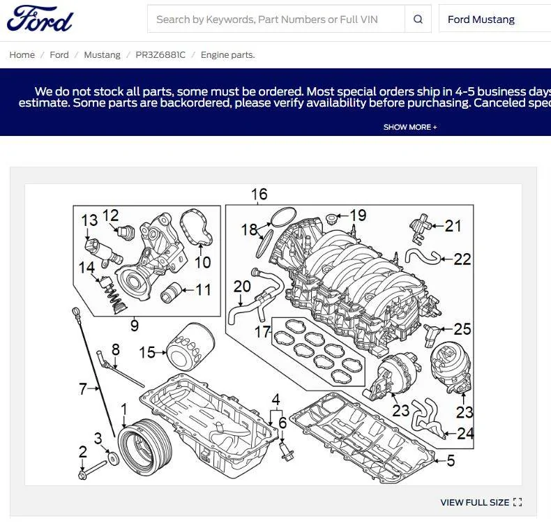

Does anyone know if the oil cooler on the DH/PP is active 24/7? Or does is get activated once it hits a certain temp and deactive below a certain temp? Im worried about the winter months that it will never get up to temp.
Yes, I do know for sure. The Dark Horse with the oil cooler does have a thermostatic Valve in the filter mount assembly. Although Ford does not announce the temperature of operation, I can verify that at the track the valve closes off the oil cooler flow @ 204°F. Understand this, Ford built this valve assembly to always allow some bypass into the cooler so there is never a thermal shock when it initially opens.
#14 is the thermostatic valve
Junkyard Dog
Jun 3, 2025
2,985
2,485
What does it mean that "at the track the valve closes off the oil cooler flow @ 204°F?" How did you confirm this?
