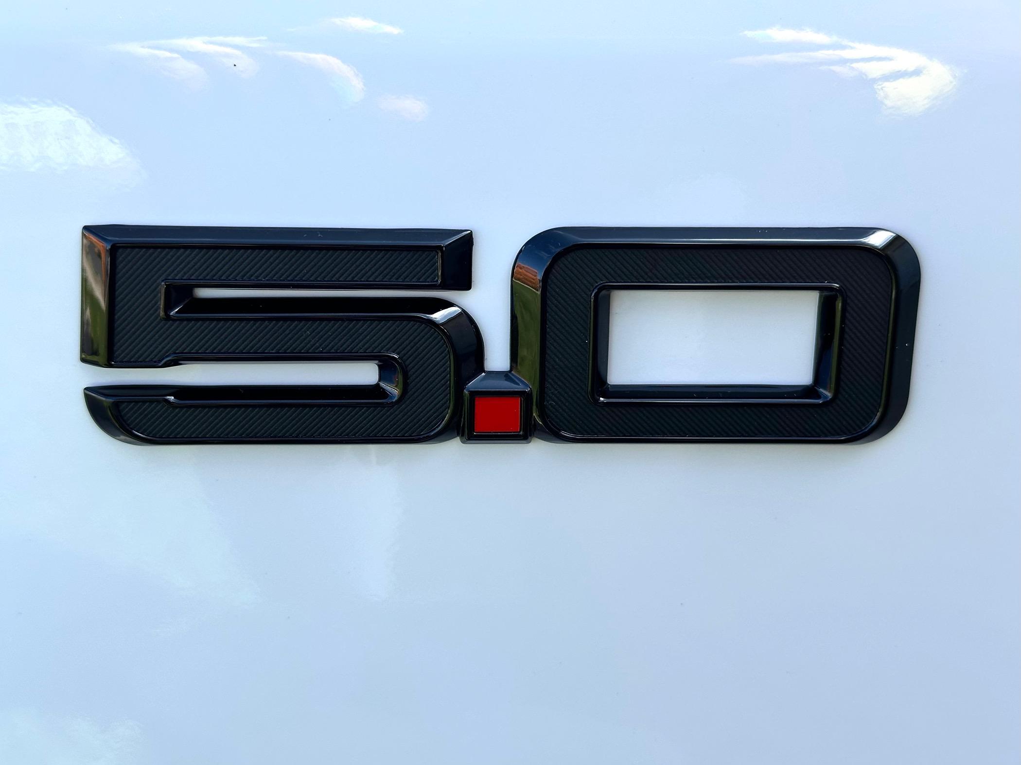

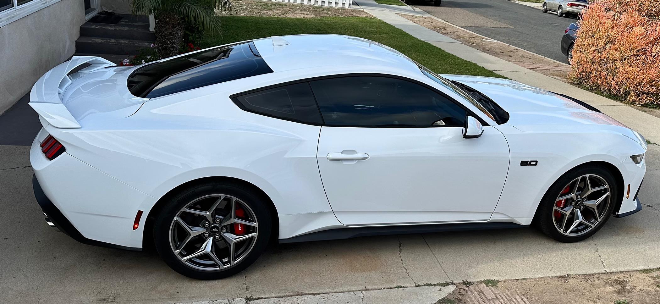

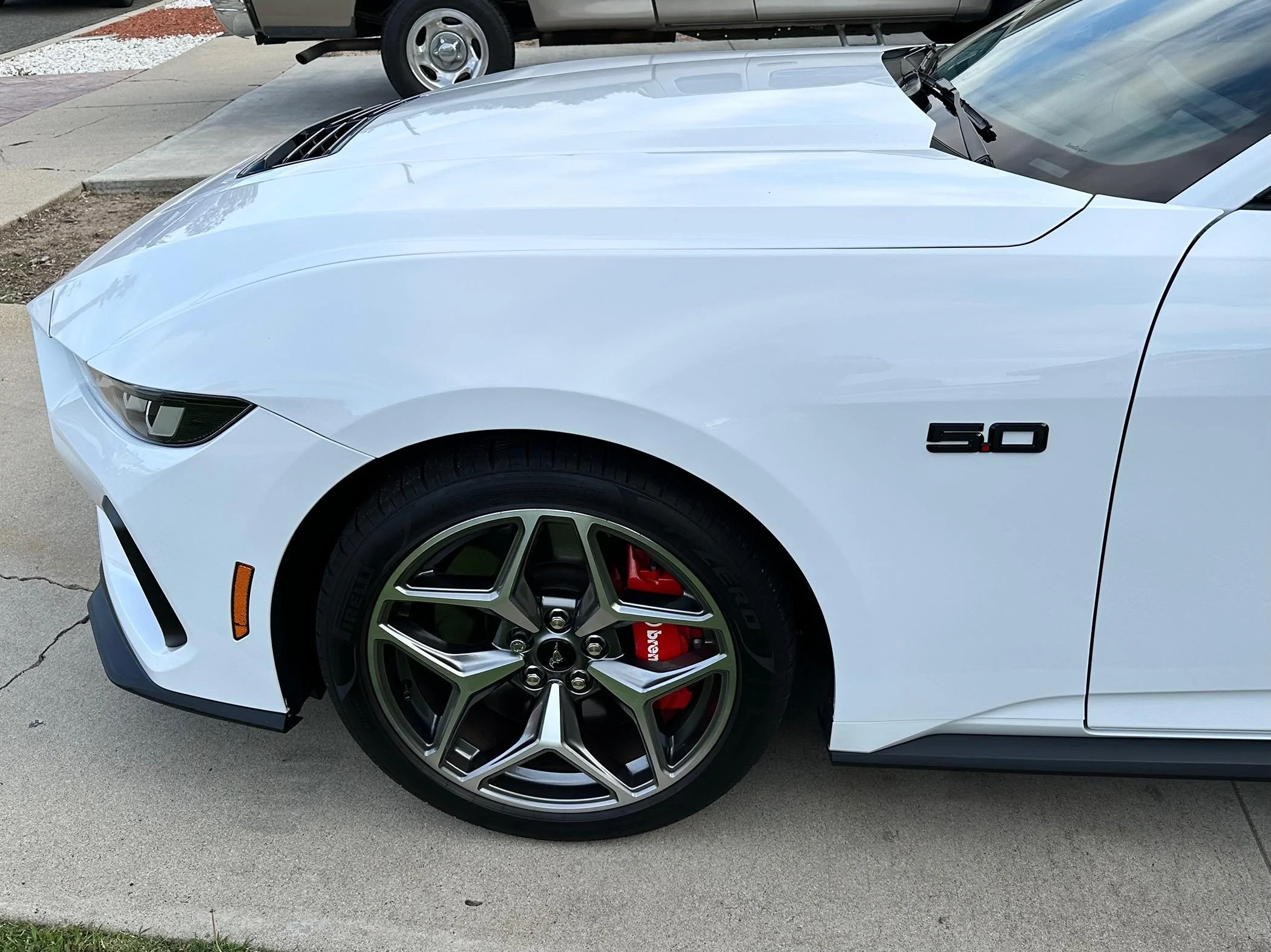

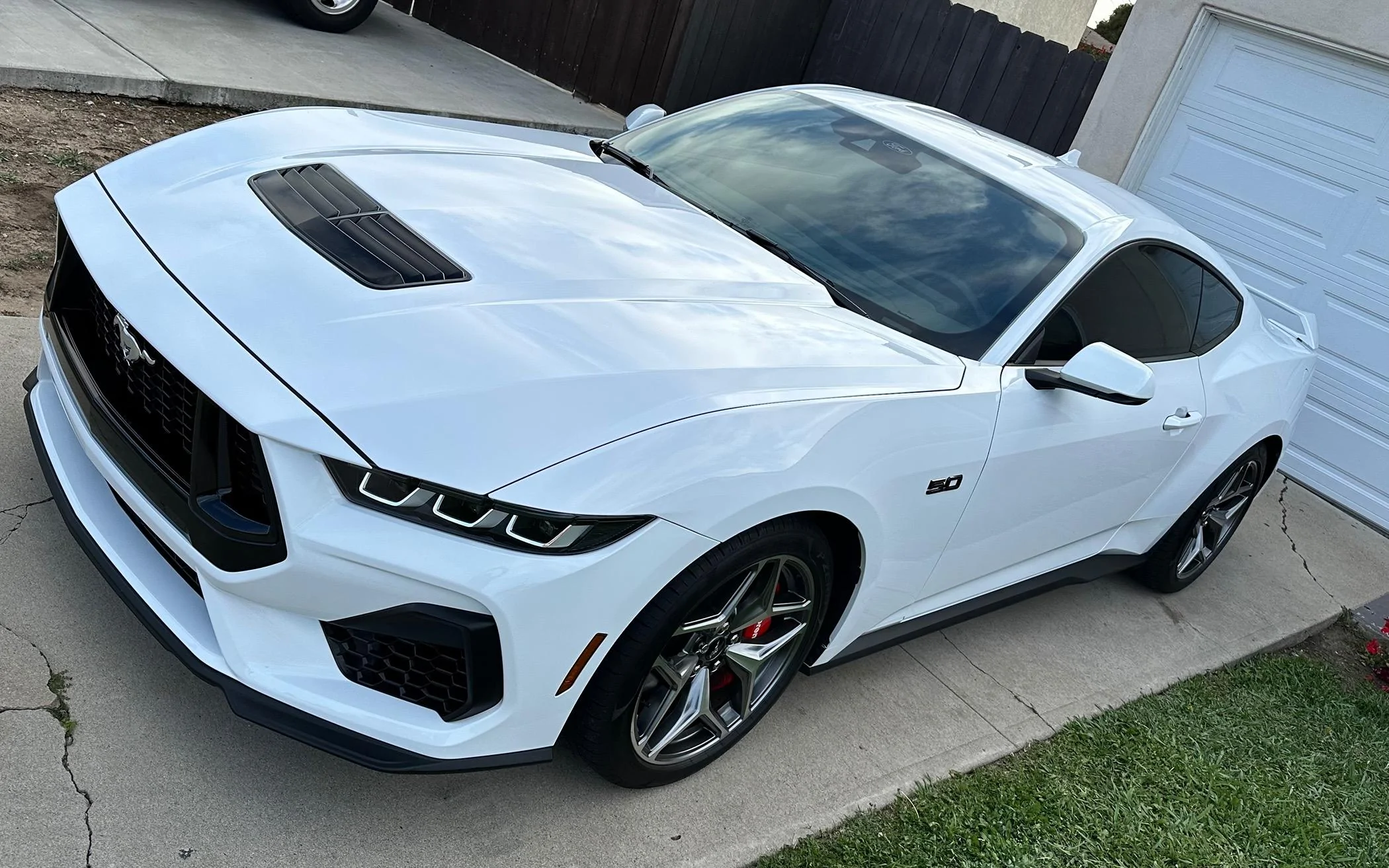

Just got done installing my Nite Pony Performance badges. The metallic stock ones were nice, but these match the gloss front grille and hood vent together better. And I think on white in particular they look especially cool. Purchased them from Levittown Ford Parts.
The install was fairly easy. I placed painter’s tape around each badge and then fishing line to saw thru the backing adhesive. I then used plastic pry tools to gently help lift them from the car. What took the longest is getting all the adhesive residue off. One tip is to let each side of the car warm up in the sun so the adhesive becomes easier to cut through and remove.

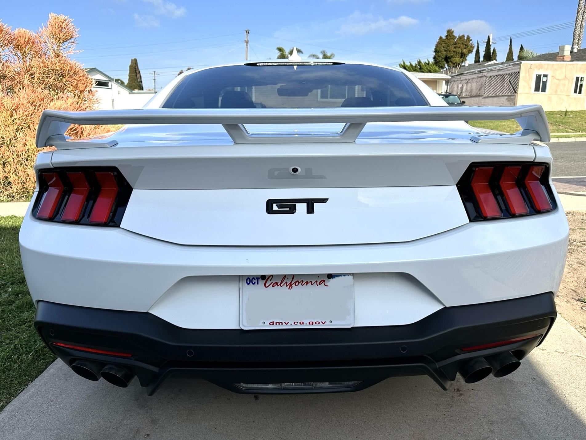

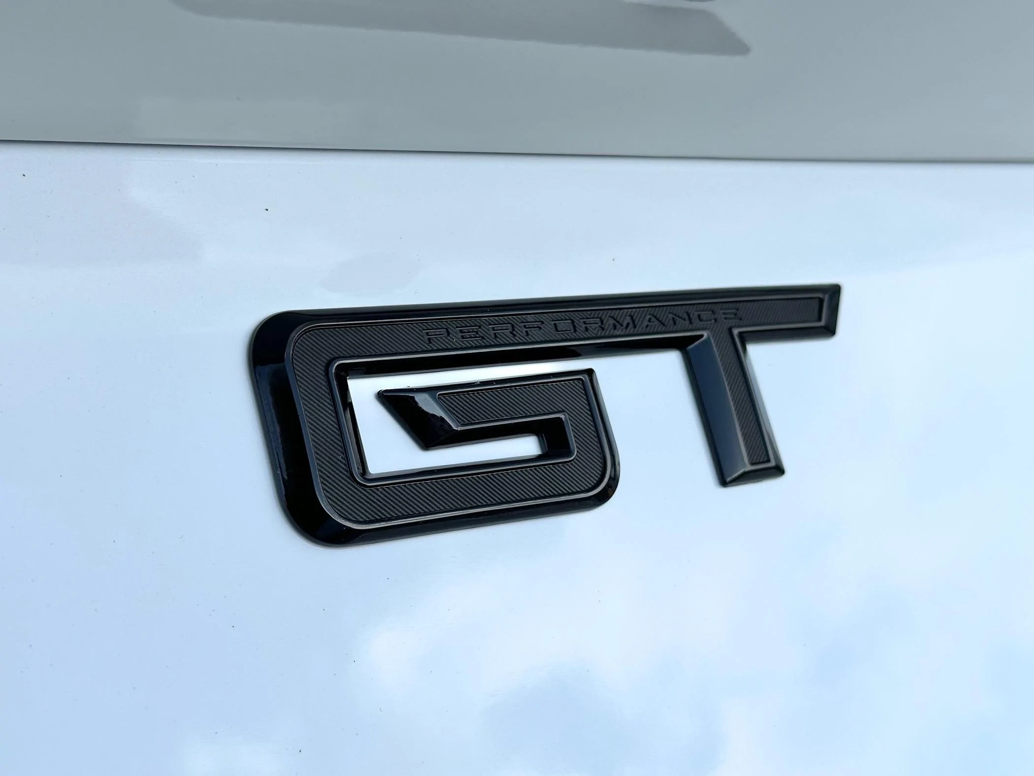

Also, the rear GT emblem was a bit tricky because the top peg behind the badge is smaller than the hole drilled into the car, so I had to take some time to try and align carefully.

car looks sick man

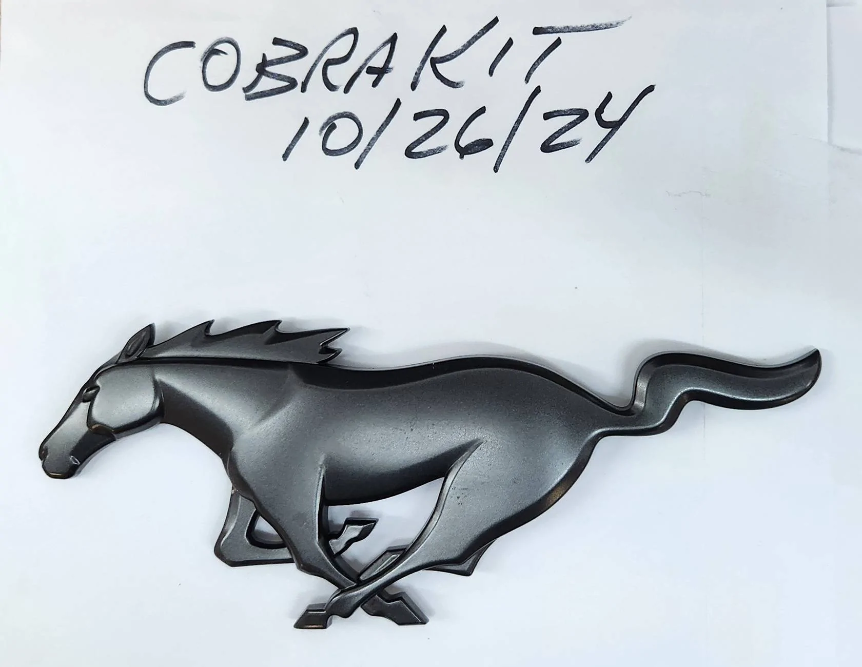

do you have any idea where I could find a rear nite pony (black) pony emblem for my eco??
literally everywhere only has grille emblems and nothing for the deck lid
