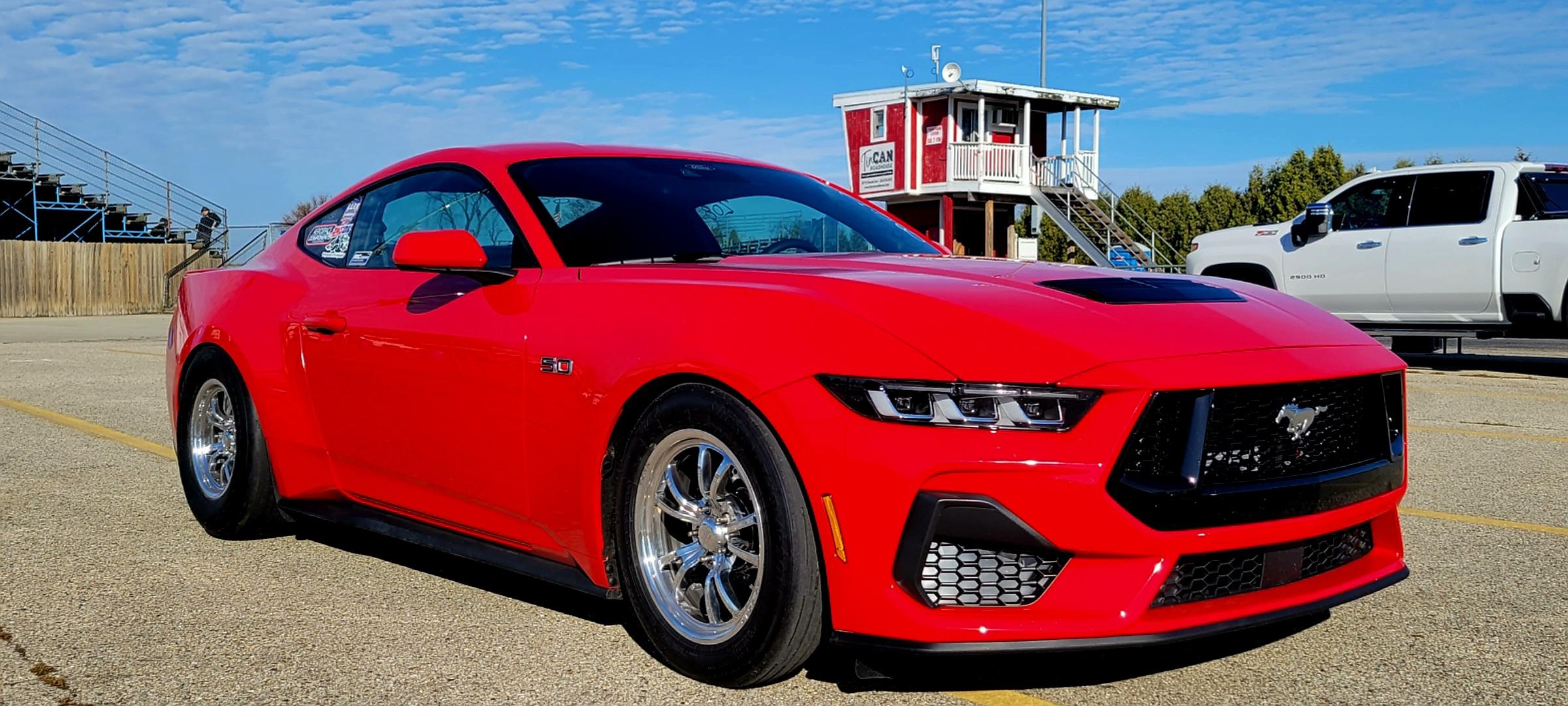

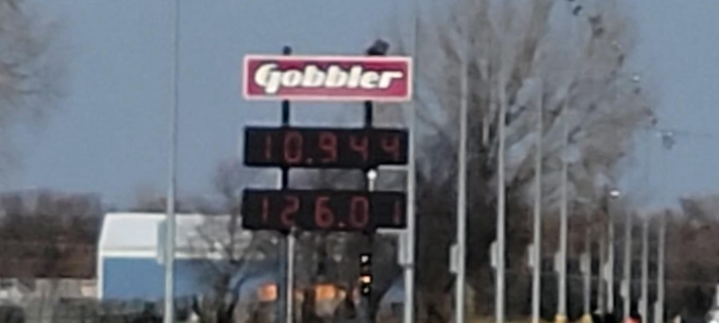

Quickest and fastest 24GT with factory tune, stock convertor On pump gas.
2024 Mustang GT.
Stock tune
Pump gas 93
10 speed
Stock convertor
3.55 gear
RC Components wheels
Mickey Thompson tires
Aerospace Components Inc. Drag brakes
Steeda springs
Carbon fiber drive shaft
2M fabrication headers
Herfurth Aluminum Racing Mufflers
K&N air filters
Anti gravity battery
Misc. Weight loss car weighs #3240
Ran a 10.94@126 today
Very nice time indeed.
Very Sharp looking Mustang.
I hope you ran it with an almost Empty Tank?
We only have 91 octane here.
It might be because of the Altitude. Don’t really know for sure.

Please excuse my ignorance but what is a stock converter?
Stock torque converter- some will install a higher RPM torque converter which will allow them to bring the RPMs up further when staging the car ....
The A10 has such a low 1st gear- you really have to have the suspension dialed in and be on a tire to need one...
They took a TON of weight out of that car to get it down to 3240

Yeah, I’d like to know what was done to get down to that weight. OP mentions drag brakes, a carbon driveshaft, removing the rear seat, and a lighter battery, but I imagine there has to be more.

Can you tell us what model number or link the Anti gravity battery you are using in the S650? Their website isn't narrowing by make and model really. Did you have to build mounts or anything to keep it in place being I'm assuming the anti gravity battery is physically smaller than stock?

Really no issues fitting the 2m Headers? I've read so many horror stories , but that price point is so tempting.
