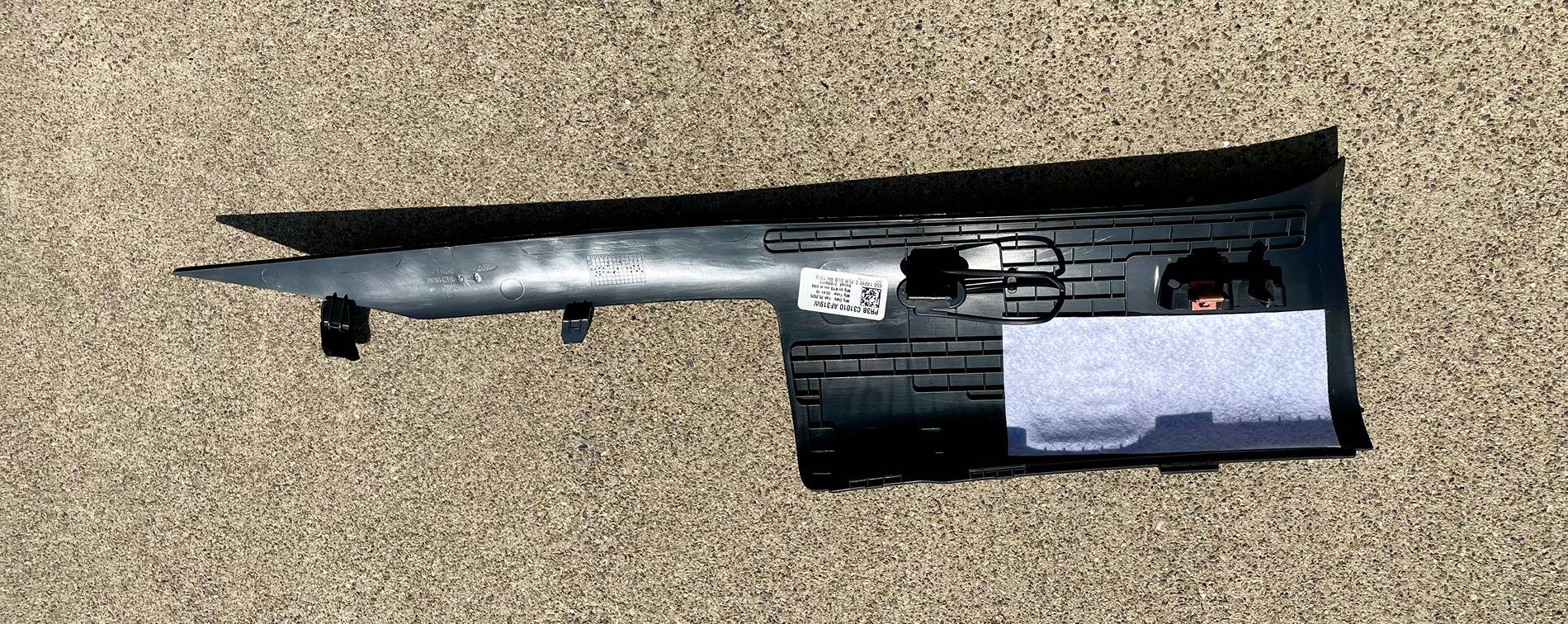

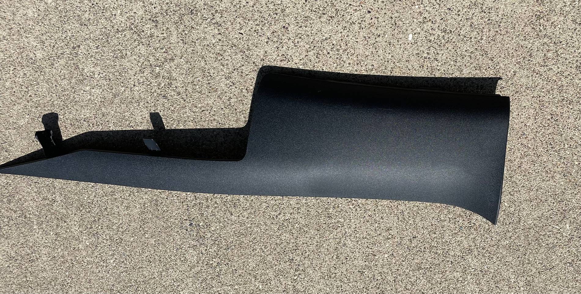

Can anyone identify this trim piece I found in the trunk of my new 2025 Mustang GT? I have not found any obvious trim missing in the car.

Easy when putting the part number in Google.
Pillar trim panel.

looks like a seatbelt cover thingy for the b pillar

Thanks everyone. I can’t find any trim missing in my car, so I’ll have to believe that there is a new Mustang running around without its B-pillar trim.

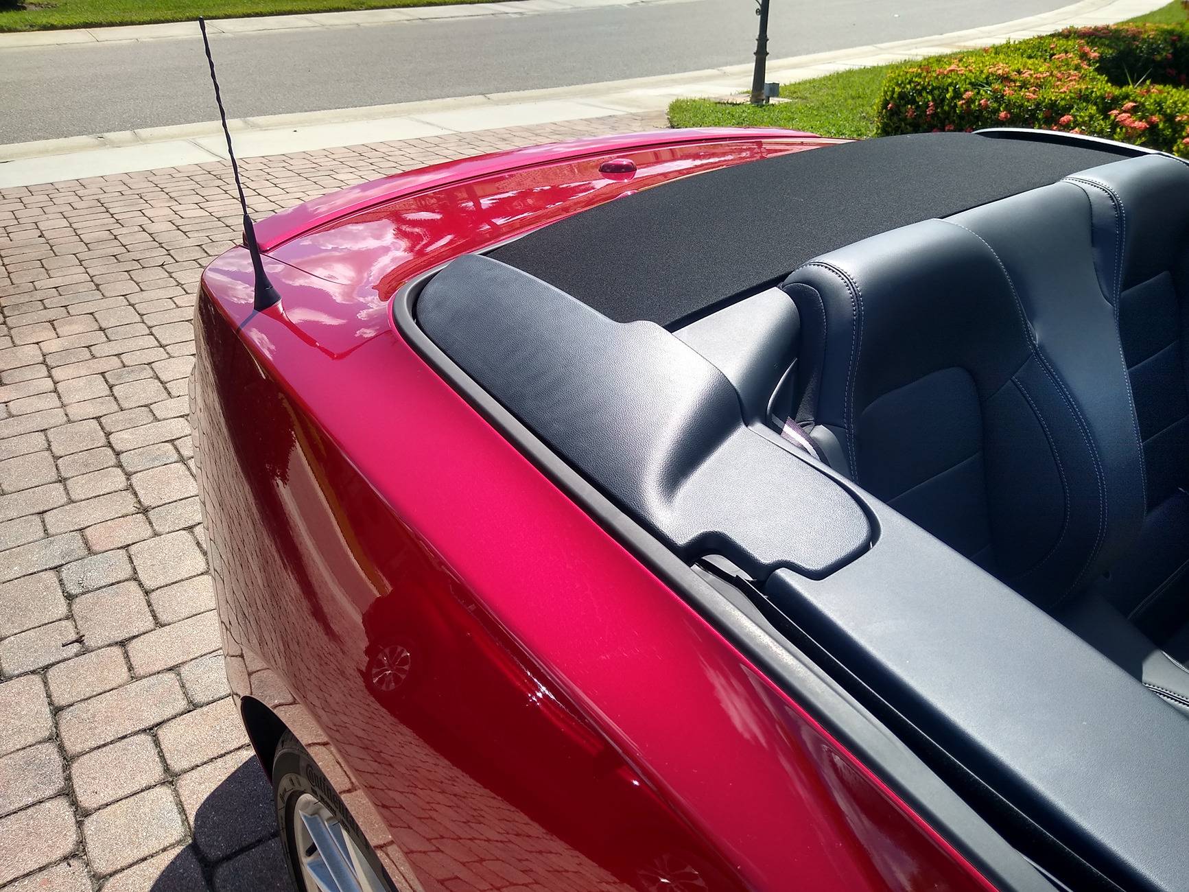

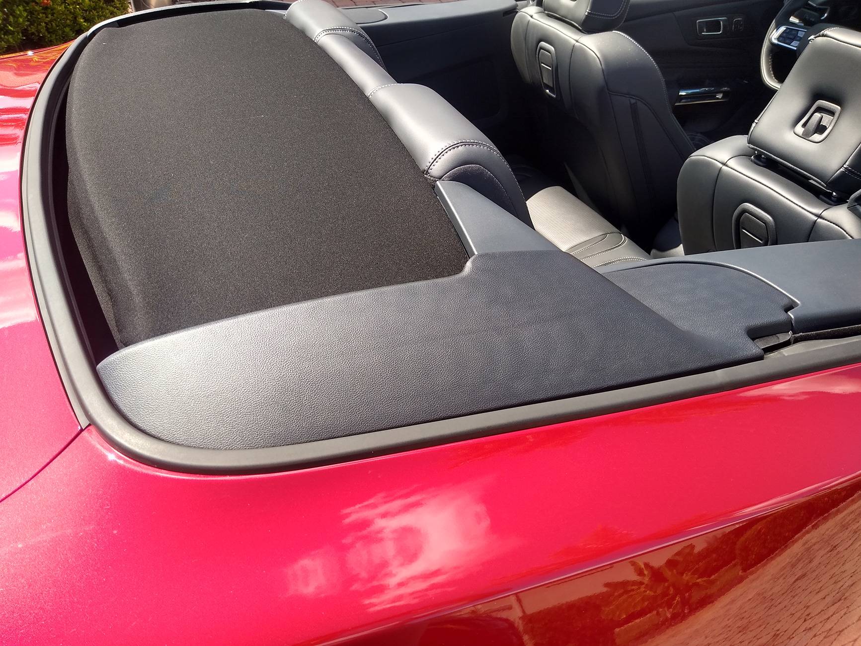

It looks like a beauty cover trim piece used on a convertible, when the top is down.

But Ford stopped giving those in the ragtop package as the reinforcing ribs on the underside rubbed against the roof fabric when the top was stowed resulting in warranty claims for roof replacements.
The trim from the 550's fits, I got mine from @LevittownFordParts and only put them on when I am as show and shine type events

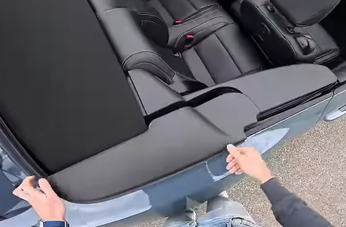

I went looking for these after seeing them in the Mustang Vert on the Autobahn vid on YT. Nice clean look. My 26 does not come with them.
I believe I found the right part # at Levittown:
SKU: PR3Z-7631005-CB
Positions: LEFT,Rear Left
SKU: PR3Z-7631004-CB
Positions: Rear Right,RIGHT
Does anyone else use these and have you had issues with wear on the top?

That vert part is different. You have a C pillar trim piece for a fastback.
I know because mine was popped half off when I got the car and had to do some detective work to get it snapped back in.
Underneath is the side airbag module. The tether on the middle snap piece stays attached to the car so when the airbag pops the trim piece off, it doesn't go flying. Neat-o.

Benny @LevittownFordParts can hook you up, I got mine from him.
I have not used mine, I have not done any cruise nights with the car so far.
(damn those things went way up in price, mine were about $150 shipped 18 months ago)
