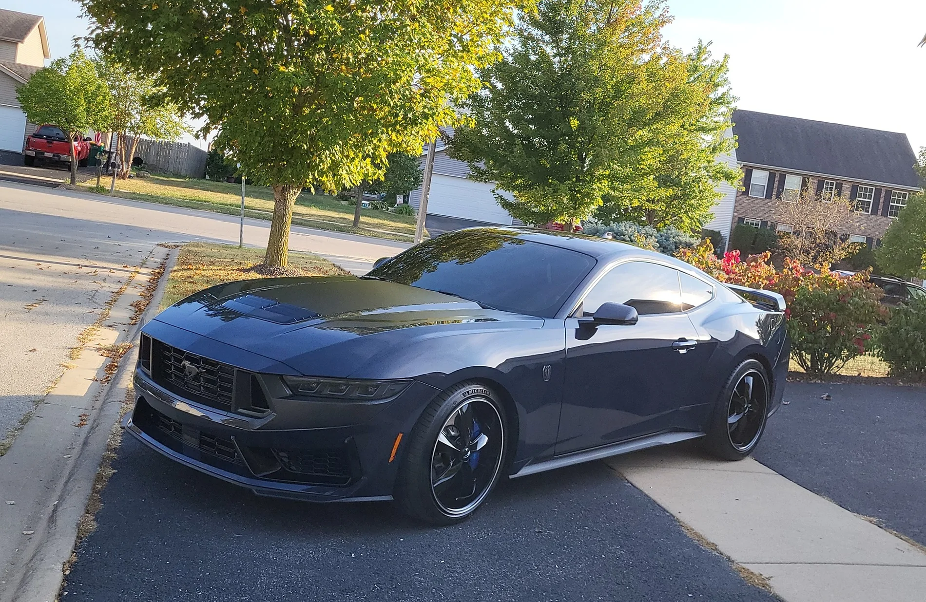

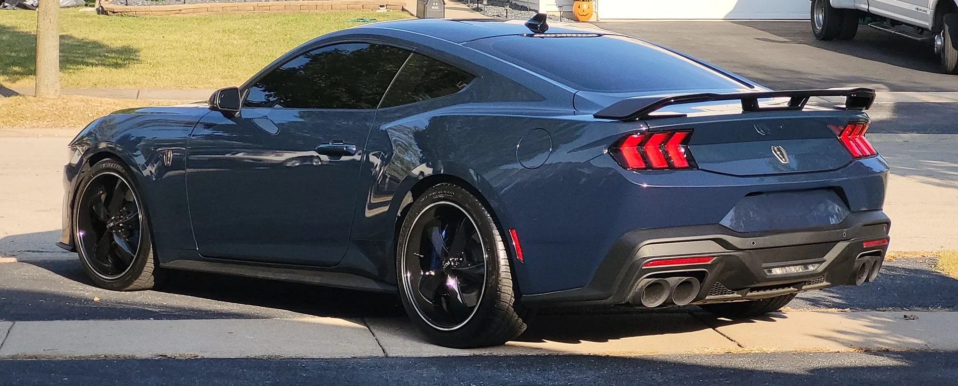

Here is a couple pictures. Blue Ember Metalic.

What wheels is that?

Mr Scoops;
Foose Legend 105 20x10's all 4
265 front and 285 on rear.
Custom Wheel Express
My contact name is Blaine. He's very helpful. I'll get his email for you

Hope this helps you. BTW tires are michelin pilots. Rides really great. I use Sport mode 99% of the time. It's a beast. Drag Mode it shifts so good . I love the 10 speed and it's crazy fast. Best time 10:63 135 mph 1/4 mile. On the pilots.
