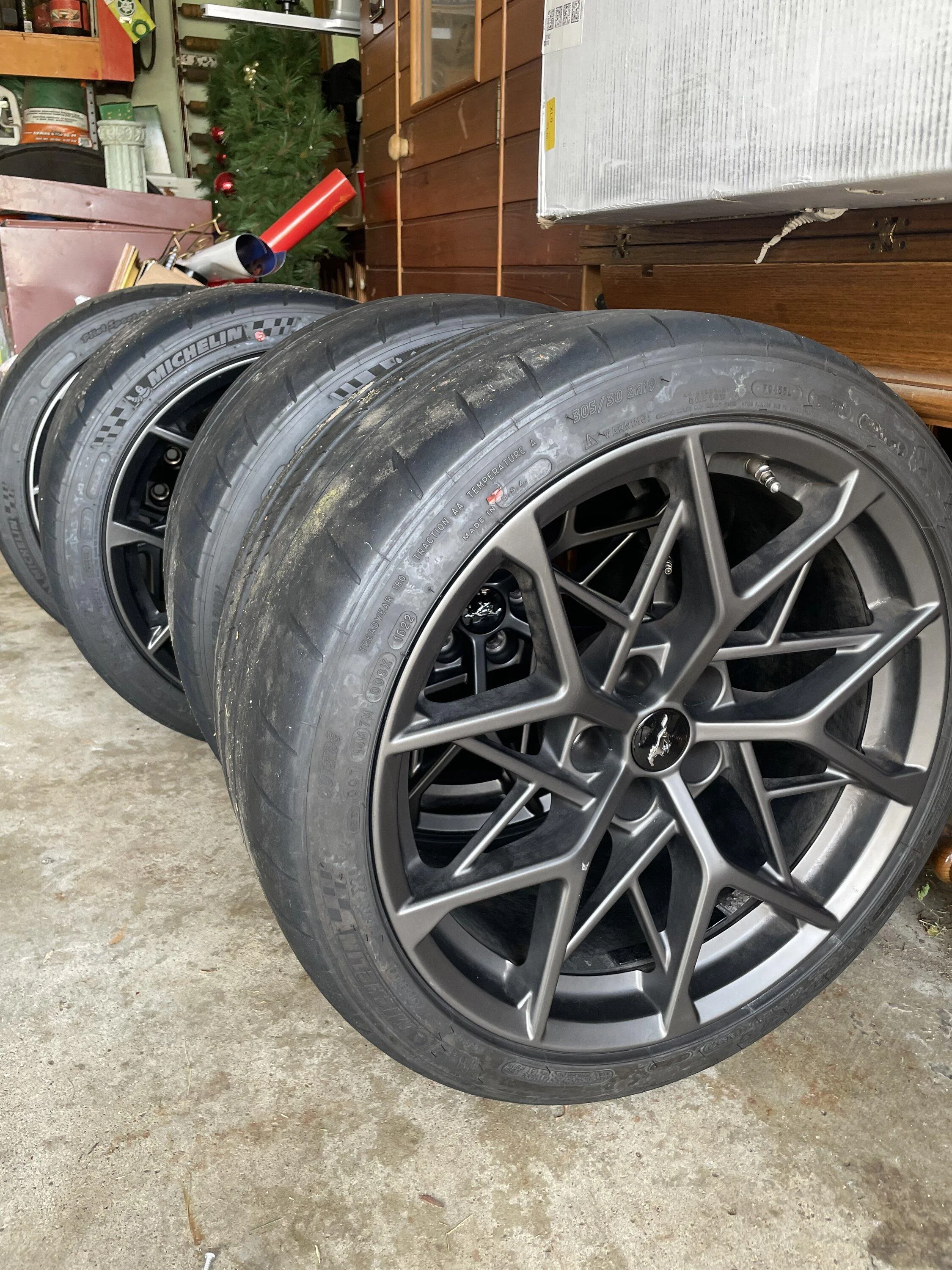

Hey everyone,
This topic may do better on the 6g forum, regardless the insight is appreciated for future s650 wheel fitment. Since I’ll be daily driving my S650 in Michigan I’ve been in search of an extra set of wheels so I can run summer and all season tires respectively. I found a set of Mach 1 HP wheels on marketplace this morning and am incredibly excited to put them on the car, when it comes in. However after doing research I’ve found that these wheels (305 front 315 rear) will only fit on PP2 mustangs not PP1 (which in s650 lingo means they will only fit on dark horses not GT’s). With that being said, has anyone successfully fitted wide wheels on a pp1 mustang without spacers or issues? If so I will assume these will work on a S650 PP GT.
S650 Mustang Mach 1 HP Wheels on S650 GT PP? 6AAA3E1A-8CD1-4AD4-AEFB-54292720CB7C

I do like those SVE wheels in that style that they offer, but the Mach 1 wheels pictured were too good to pass up on price, especially with the cup 2 tires in such good shape. I guess my question now would be, regarding s550’s, is there any differences between PP2 mustangs and PP1’s to accommodate a wider tire? If not then I’ll use that rule of thumb to dictate whether these will fit on my car that isn’t even built yet lol.
