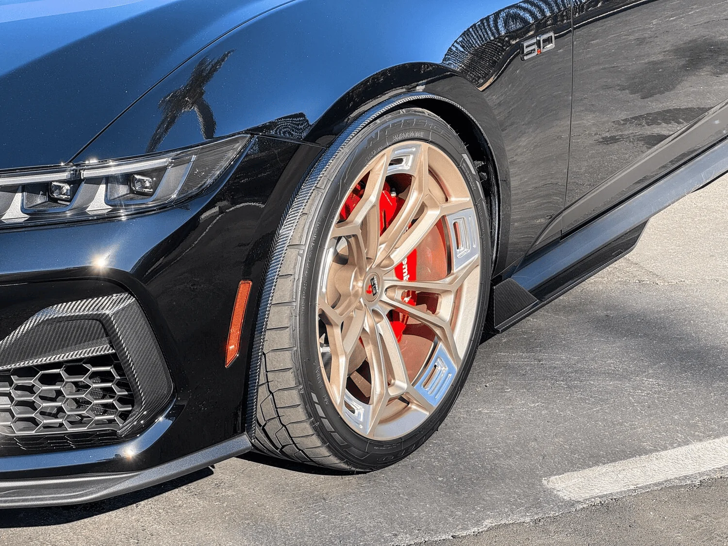

they have images of it with the stock front splitter as well, i think the DH is the same around that area, correct me if im wrong

Yes, I've been watching those as well, I think they claim to be available "Q1 2024" or something. Might have to get them until OEM is available, and then try to sell them here.

Looks like they will work just fine from this angle. I would just be worried about inner wheel well clearance especially in a lowered vehicle. My DH is lowered slightly and the Mach 1 flares I’m currently using rub ever so slightly on large high speed dips. Not an issue since they’re plastic and can take a beating. But the carbon ones I think could be easily damaged with mild contact with the tire. I guess that’s a concession we gotta make when modifying stuff.

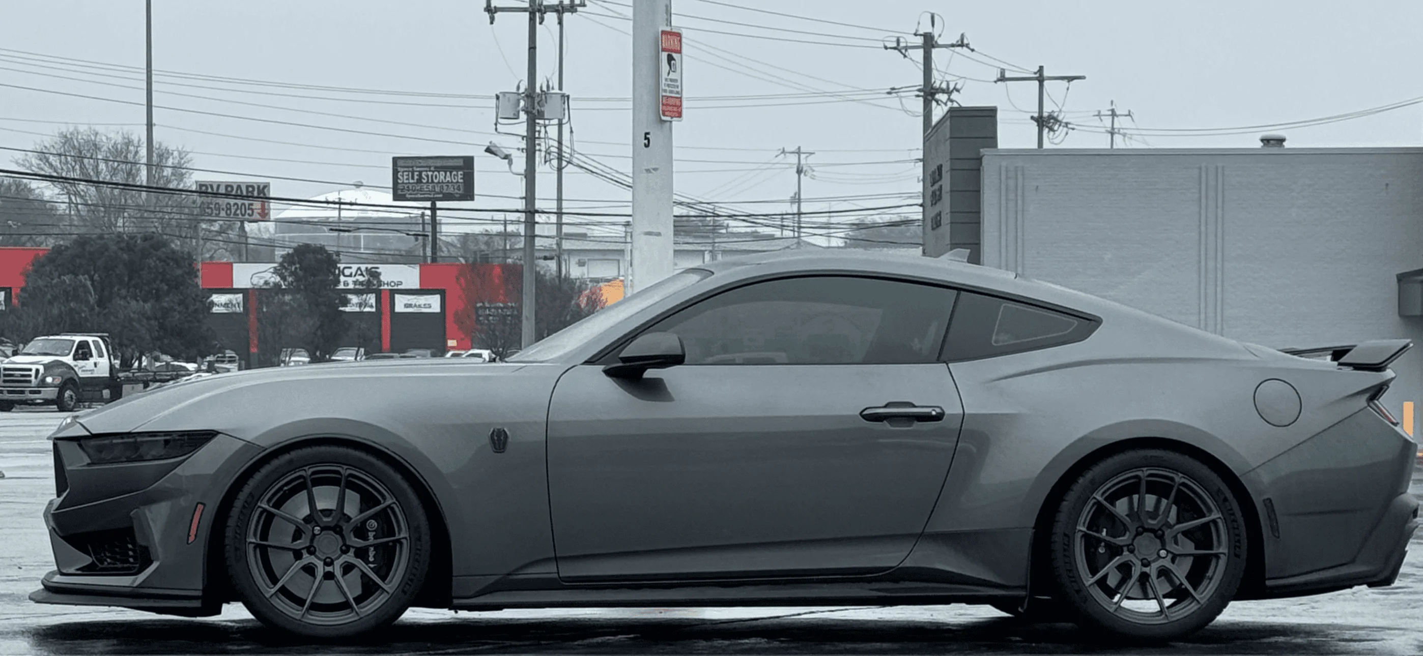

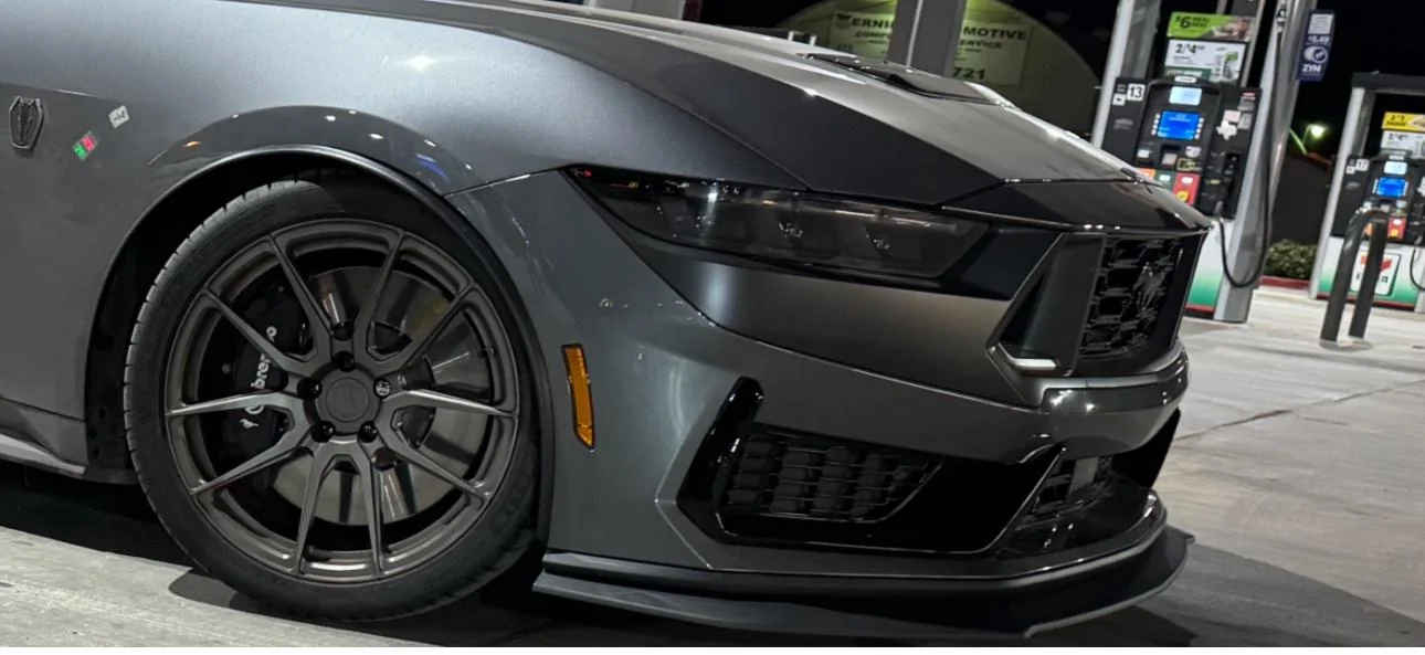

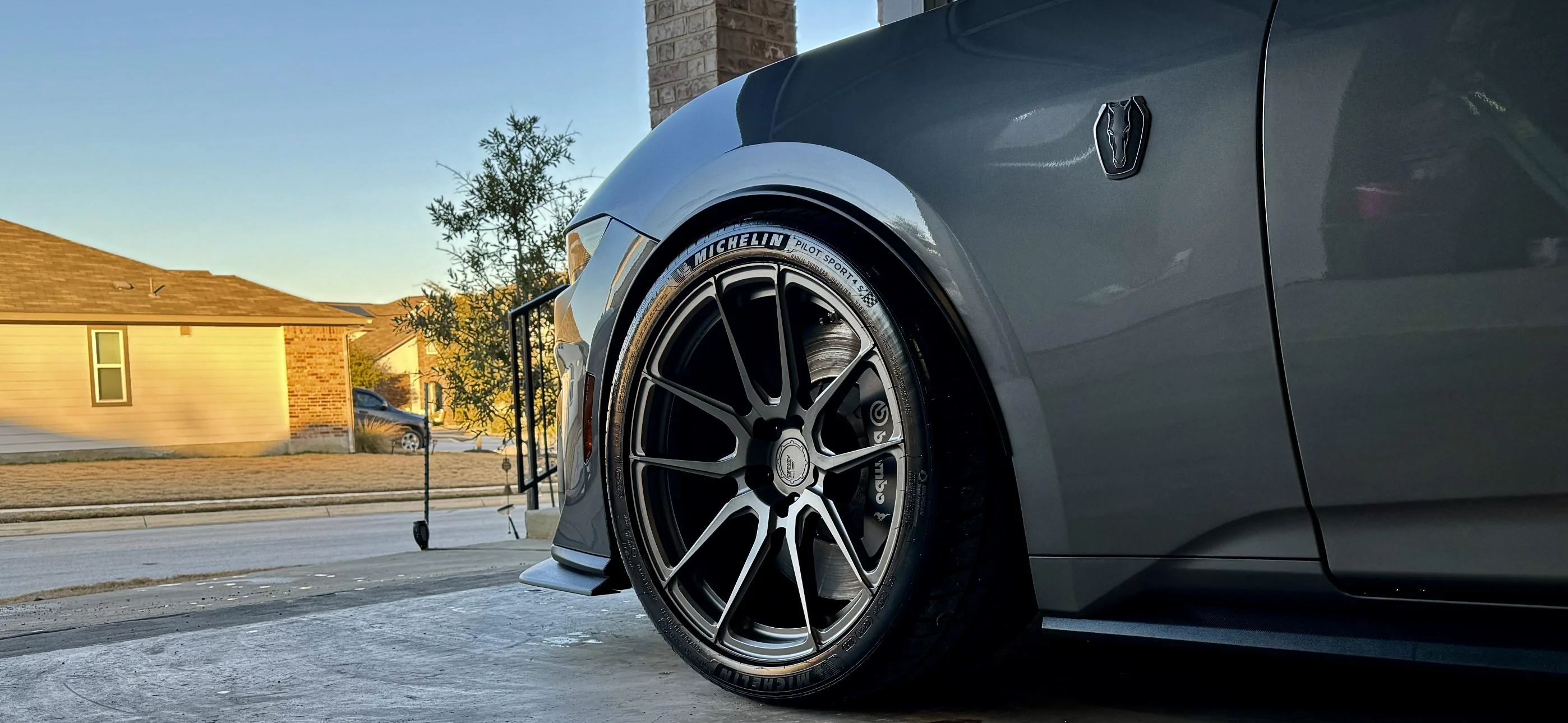

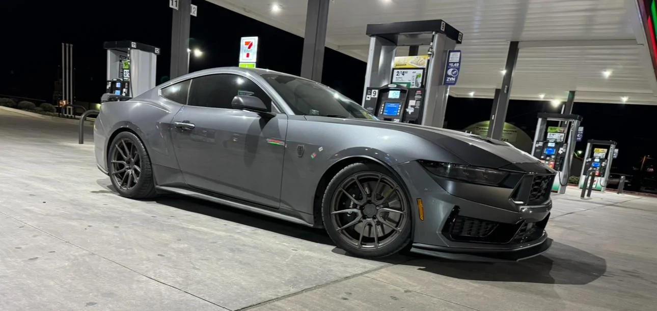

Figured I’d add a little more detail to this thread for those of us still hunting for the DH fender flares. I was able to source a driver side DH flare and “should” have the passenger side one in a few weeks. Paid more than I wanted to but hey, nothings better than OEM. I have attached a few more photos with the Mach 1 flares I retrofitted to my DH to show how they look with wheels, tires, and a drop. The wheels are BC Forged EH172’s wrapped in Michelin PS4S (305/30/19 and 315/30/19) and they’re made to the HP wheel specs (19x10.5/11) with corresponding offsets. The vehicle is also lowered on some Ford Performance springs that provide a modest .78 inch of a drop. I added the DH HP larger front splitter as well. The Mach 1 flares are definitely made of a thicker material and are not as flexible as the OEM DH ones.
