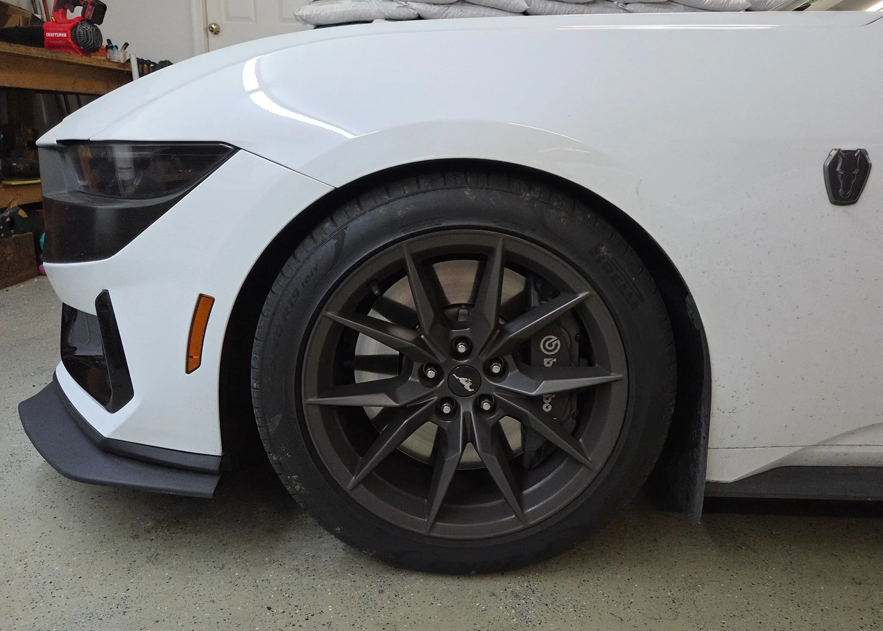

Sorry for dirty wheels, but this is my daily driver.
275/40 on stock 9.5 in rim

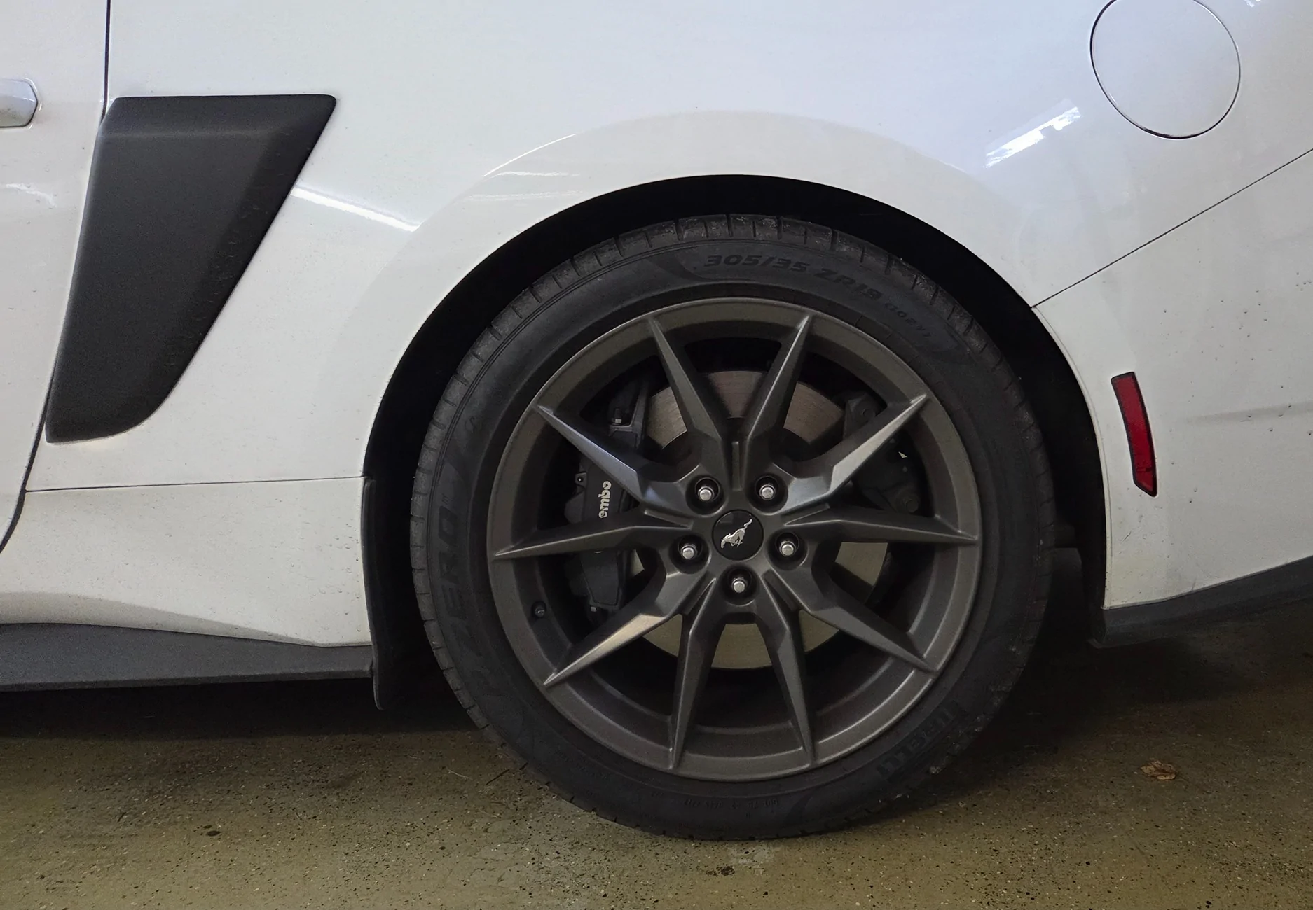

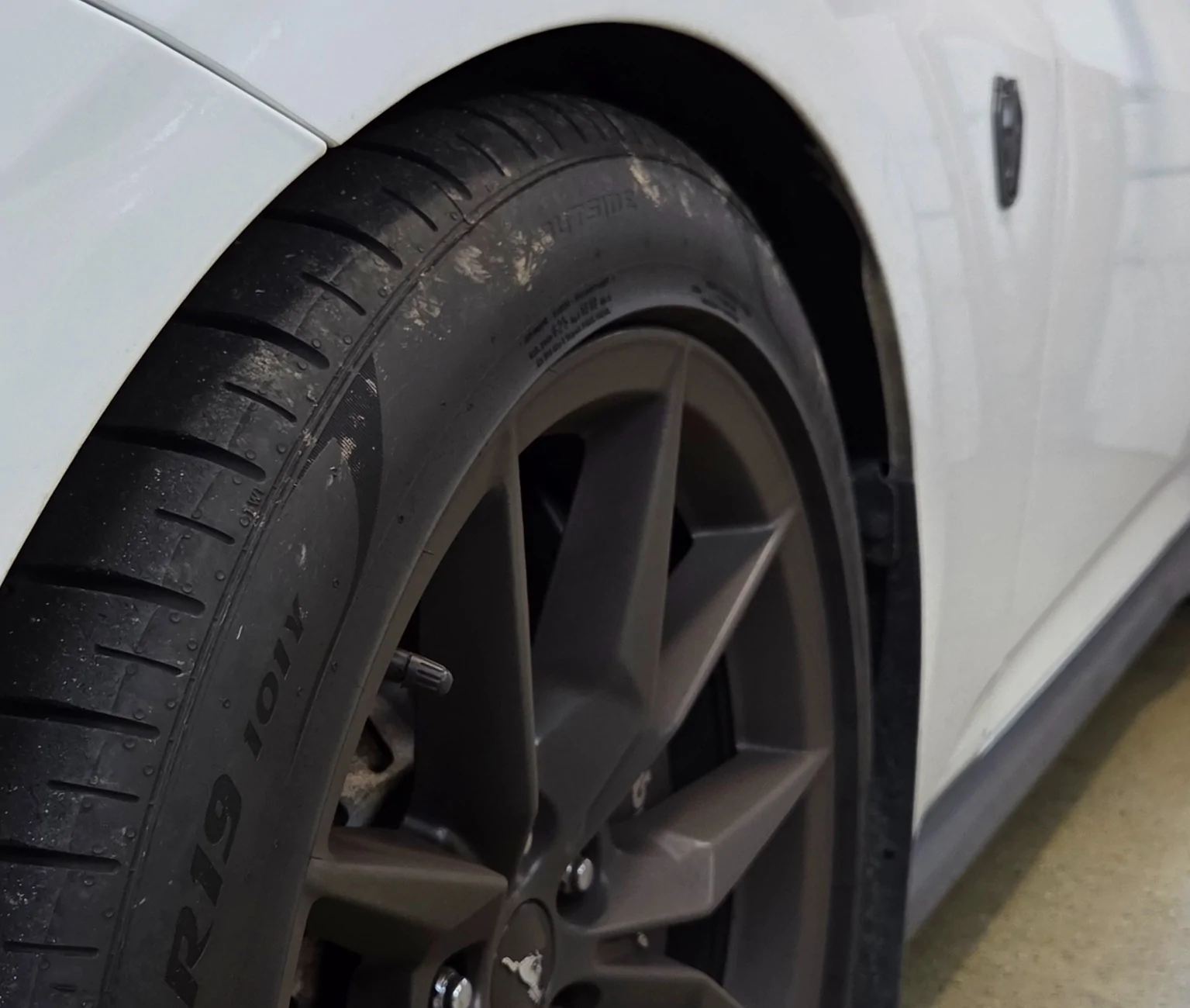

305/35 on stock 10 in rim
S650 Mustang dark horse 19x9.5 Front, 19x10 max tire size? 20250923_082519

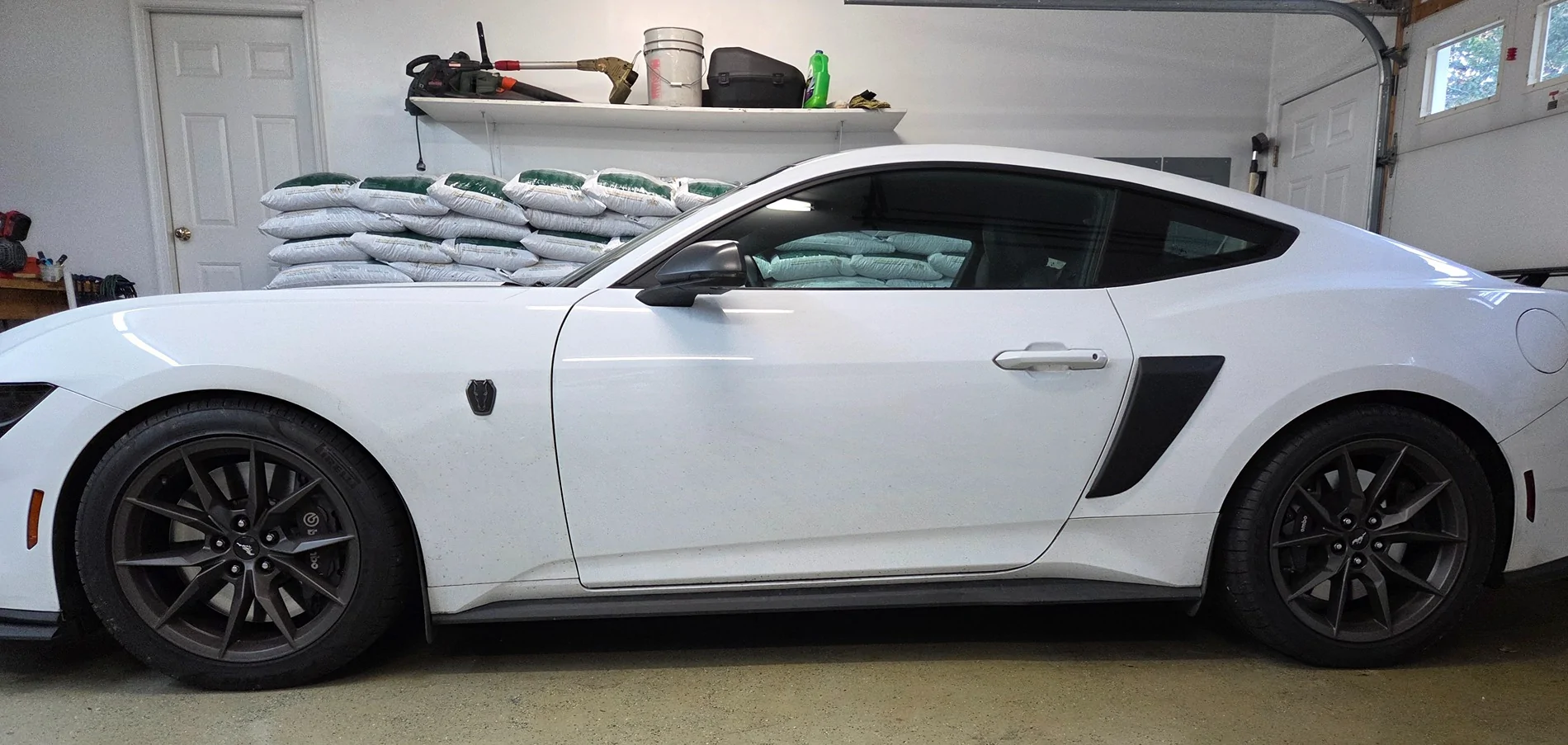

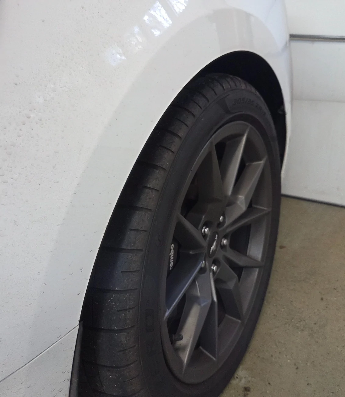

Sideview, but hard to see slight difference in diameter.
S650 Mustang dark horse 19x9.5 Front, 19x10 max tire size? 20250923_082615

The base DH needs more tire and I wish the rear wheels were 10.5 instead of 10 in. So cheapest upgrade was to put stock rear tires on front and buy new Pirelli Pzero 305/35 for rear. I have not tracked car, but I do live in a rural area and drive aggressive. 100 plus straight cruising and high speed sweeper turns no problem. Drving over the speed limit on twisty rural roads, also no problem. Again, I have not been on a track with them, but I don't see a "floaty" problem.
You probably reduced the ability to stick to the road in turns by putting tires with too much tread on that width of wheel.
It is better to have the tread be slightly narrower than the wheel width.
If you want wider tires, and you want it actually to handle well, your lap times will be reduced by going to wider wheels for those tires.
