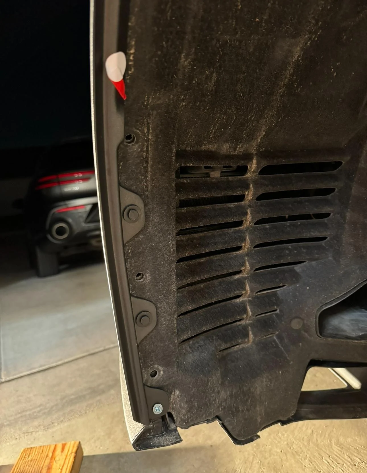

I need to check but looks like those will be bolt on there are some clips right on the edge of lining and panel, in a wheel arch, and those looks exactly like holes pattern on DH fender flares, i assume there would be like pull clips, insert flares, push clips... but I need to find DH to make sure. or ask someone to provide photos of those flares and how they attached

So I am in the same boat as you since Ford doesn’t offer the OEM S650 flares just yet. I have a Dark Horse non-HP and bought the S550 Mach 1 flares assuming they’d fit since the mounting holes look similar. However, they do not align. That being said, they can be made to work on the S650 by drilling a few extra mounting holes into the fender liner near the front bumper while still using OEM plastic pushpin fasteners (provided in the Mach1 kit). The rear mounting tab will need to be re-molded slightly to conform to the curvature of the fender opening and can be done with a heat gun. I’ll be doing all this on my dark horse and can report back with any issues but after some mocking up, it should be pretty straightforward.

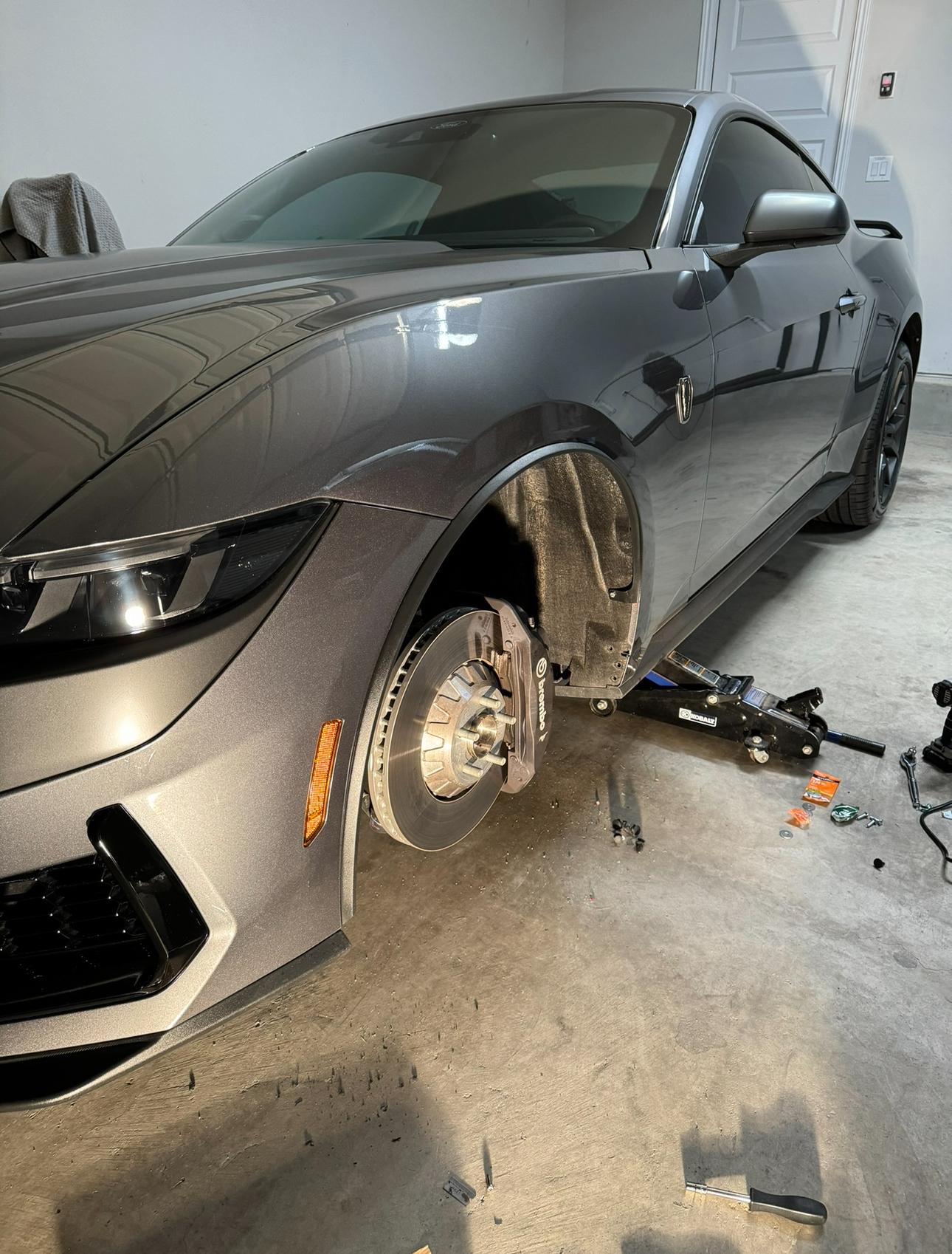

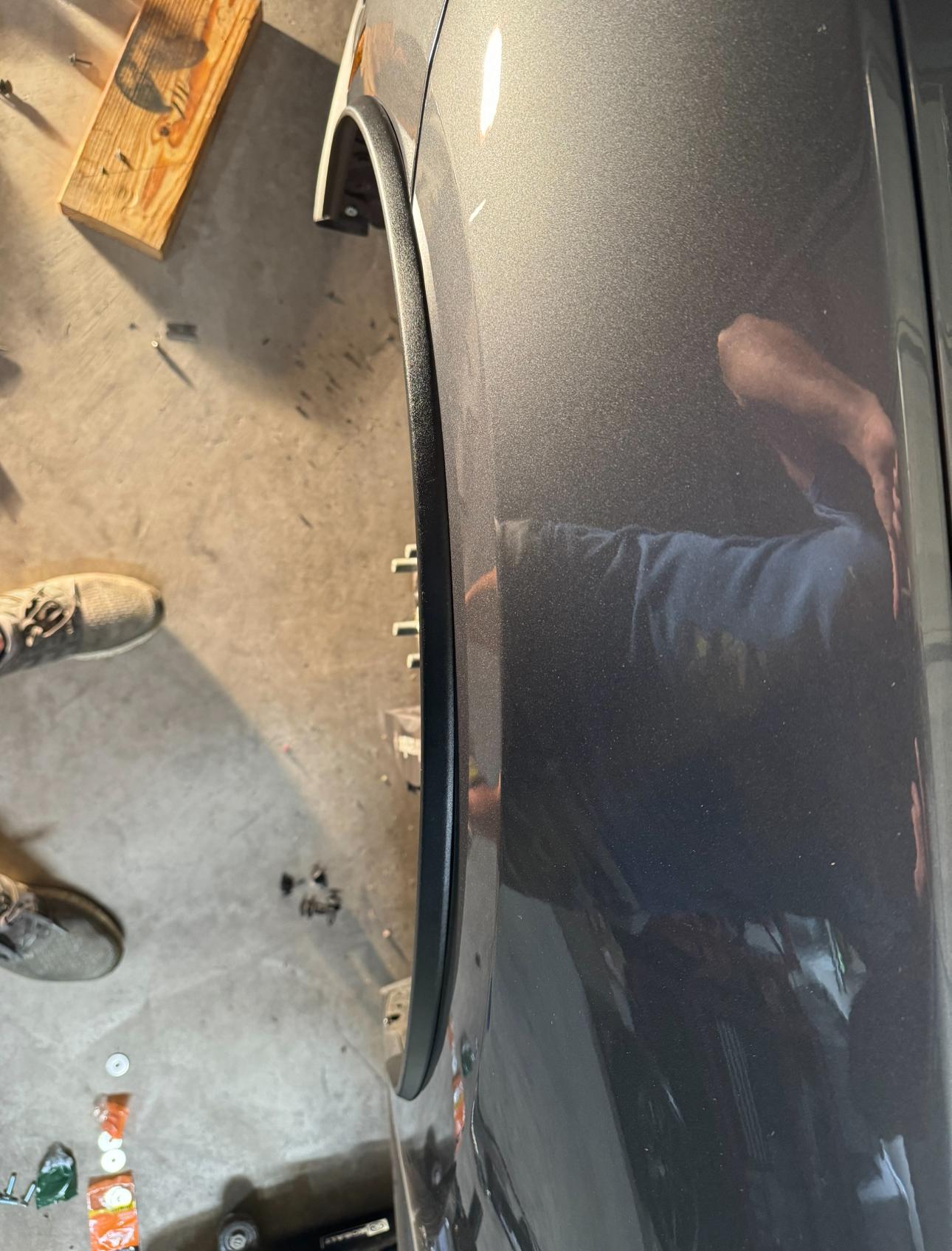

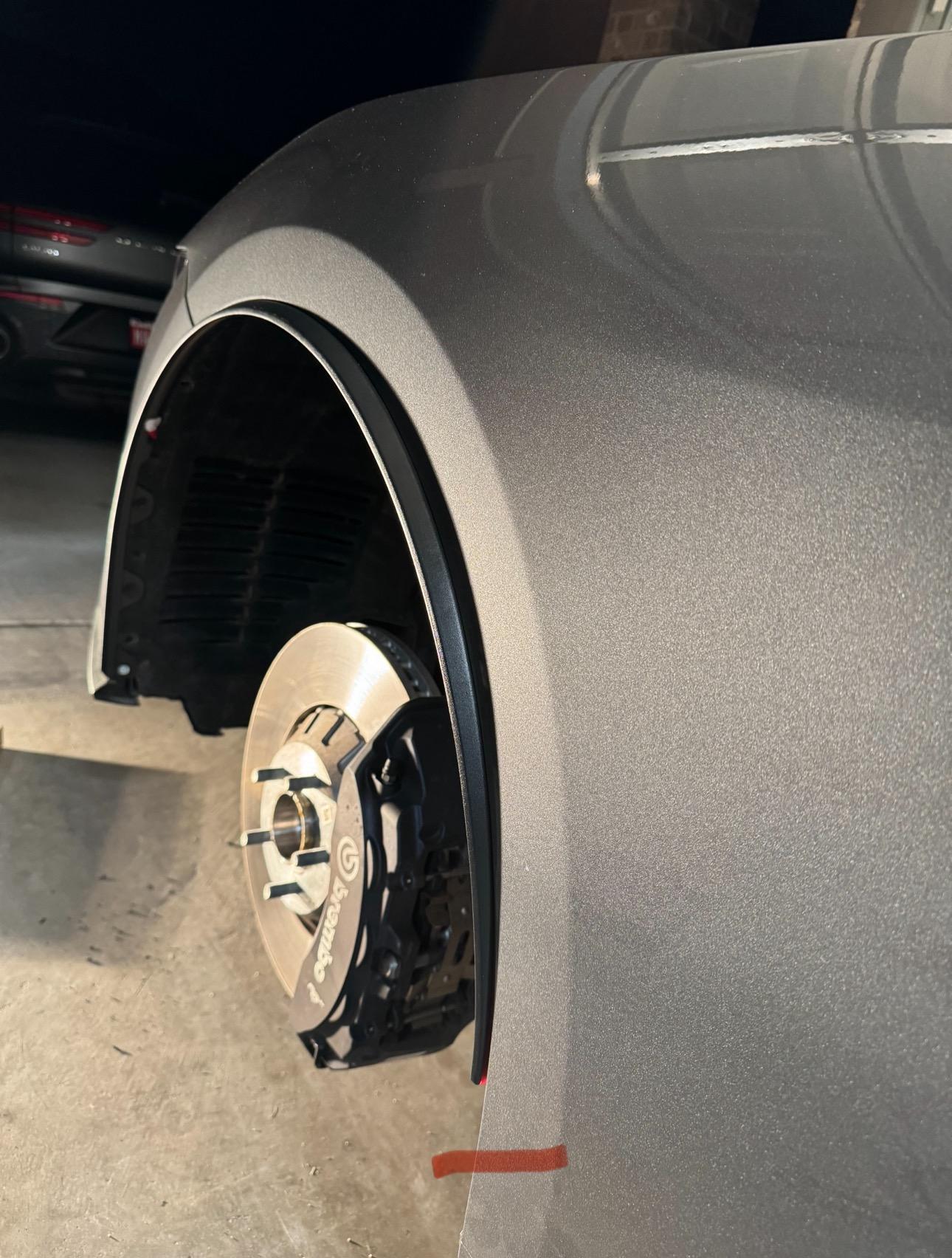

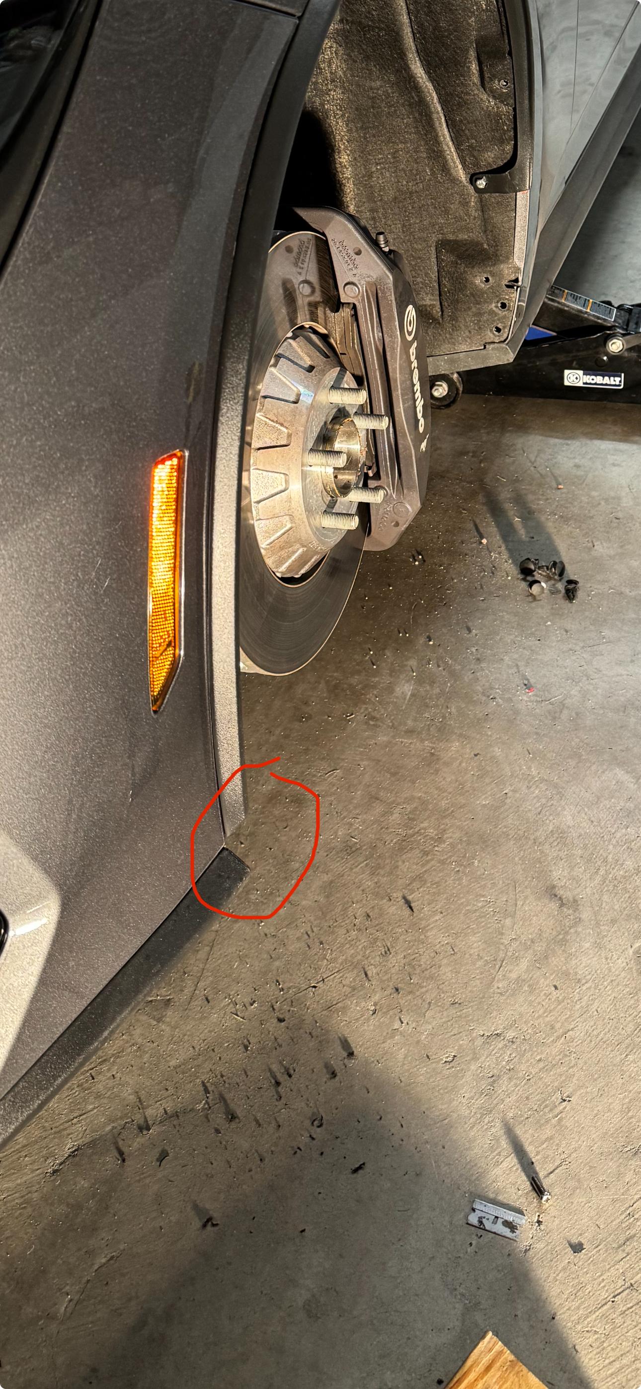

Here’s the mockup I did on the drivers side of my DH with the Mach1 flares. Never mind the shiny bits of hardware as they were just what I had laying around at the moment; OEM pushpin fasteners will be used here as well. Everything fits snug and I’d say it’s like a 90 percent solution until Ford brings the price down of the OEM ones; my dealership hit me with those crazy prices as well. I say 90 percent because the front part of the flare doesn’t fully reach the splitter like the DH one does. The Mach1 has this sort of upwards slash cut design whereas the DH one continues down a few more inches to meet the splitter. I’ve circled that in red. Same in the rear. The tail of the flare is supposed to end near where the side skirt begins but this two is about 2 inches too shy. All in all, these minor differences to me aren’t all that noticeable and are a decent interim solution until the DH flares drop.

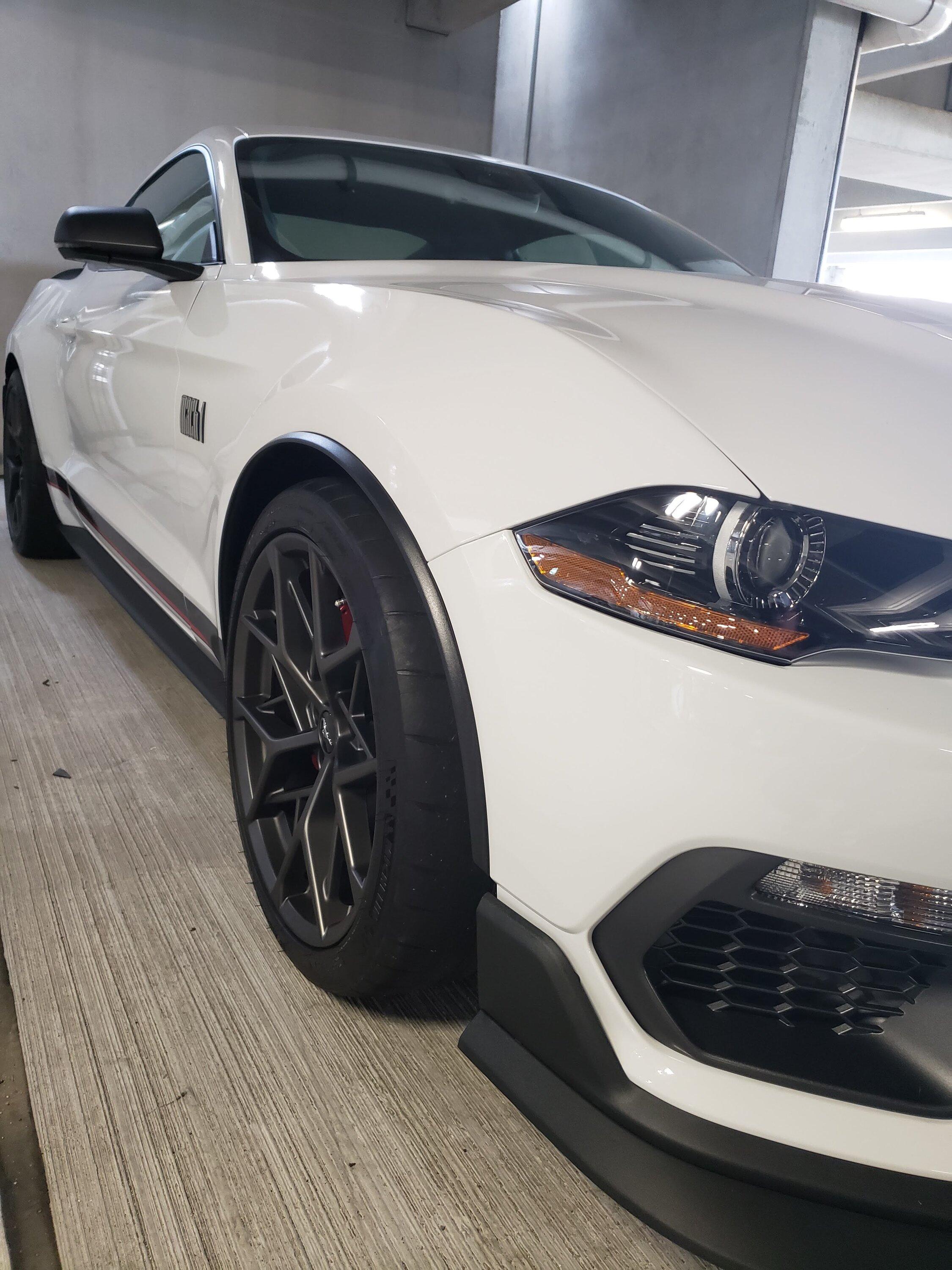

On the Mach 1 the flare would rotate towards the back of the fender wall and meet up with the side skirt. There is no gap at the front because of the front air dam. Here is my Mach 1, I installed the moldings myself. They came in the trunk. You would want the protectin towards the back as that is the direction the rocks will be going.

Thanks for the reply. Totally tracking how the lip moldings are to be positioned on the Mach 1. However, I modified these to work on my Dark Horse until Ford releases the OEM handling package ones for the DH. Given that the DH splitter doesn’t go up as high on the side of the bumper like the Mach1 ones, I had to rotate the flares forward to meet the front splitter. I think with how I mocked them up in my previous photos, they’re a decent interim solution.

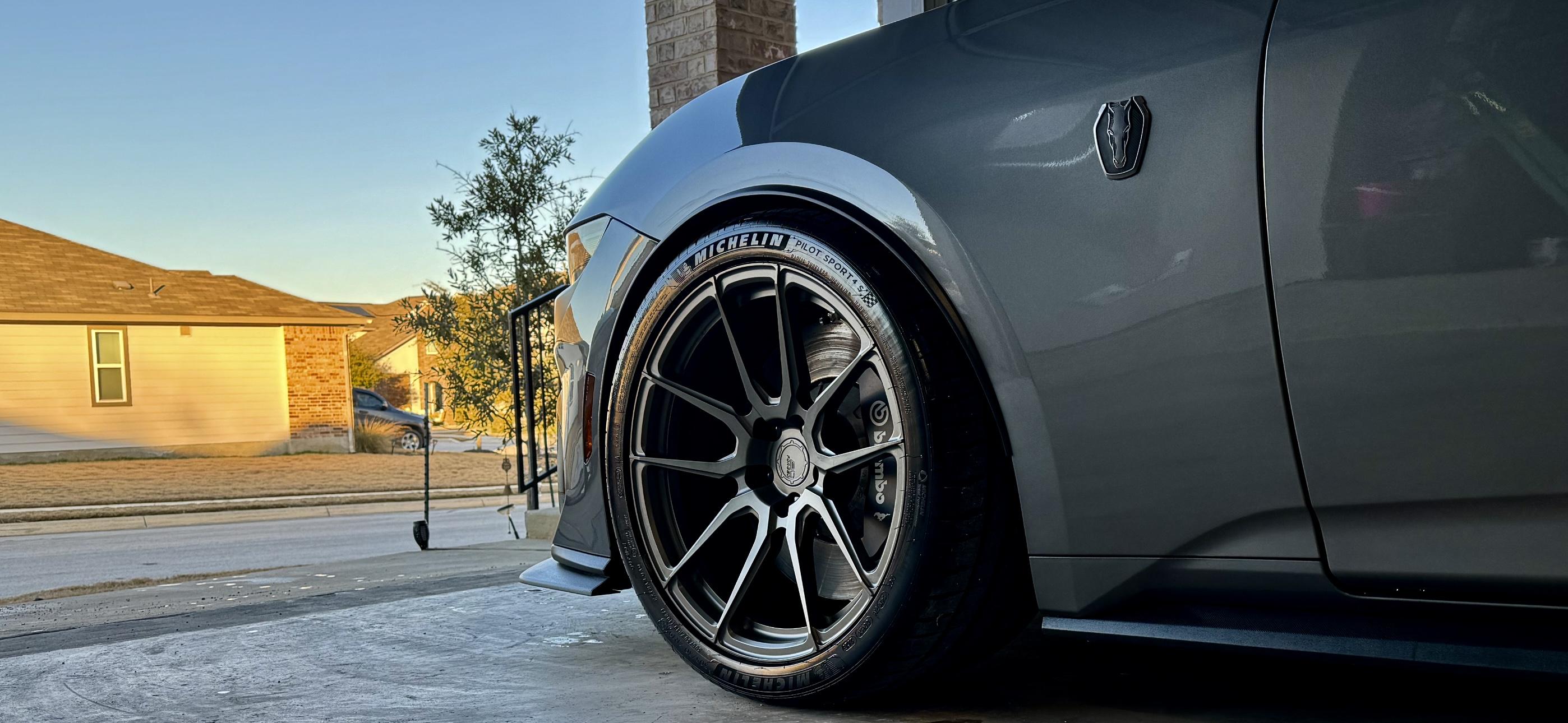

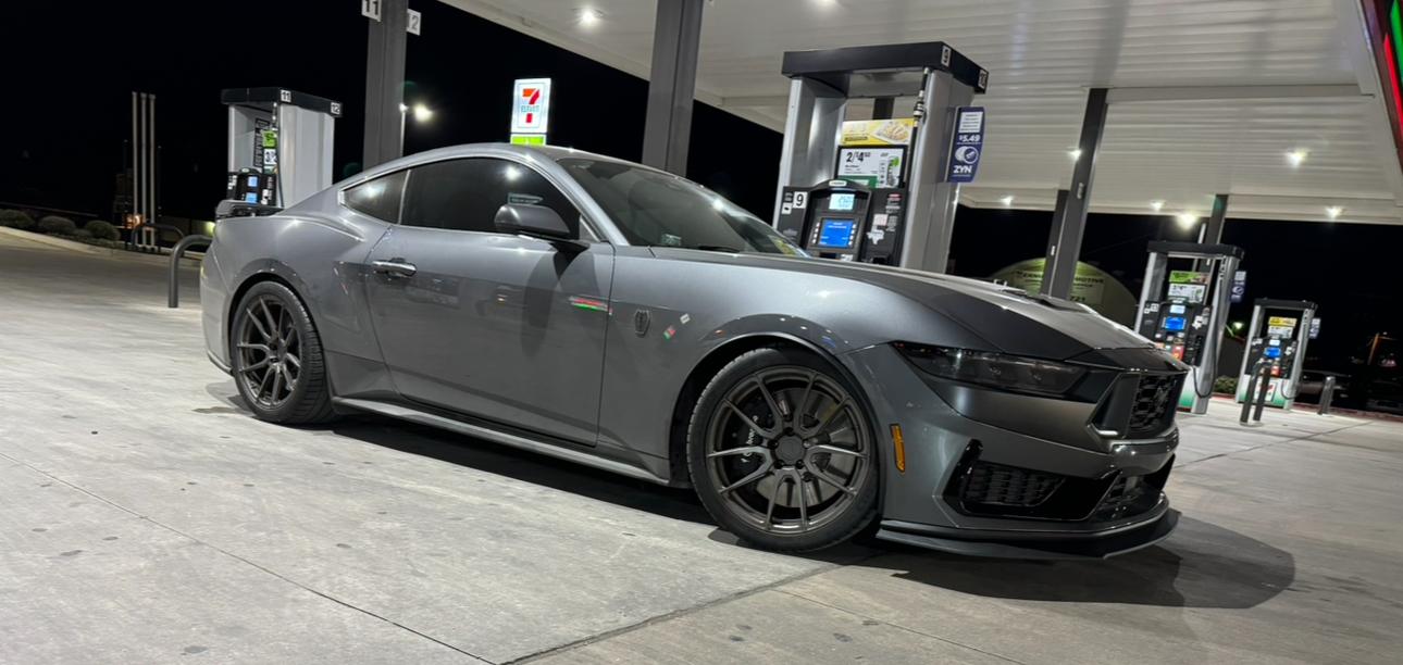

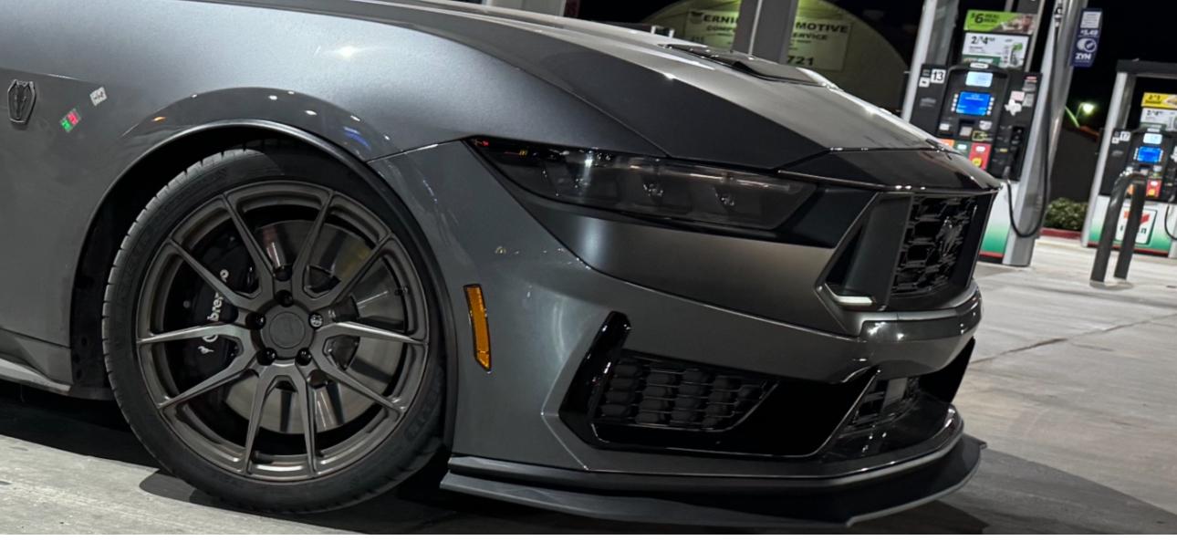

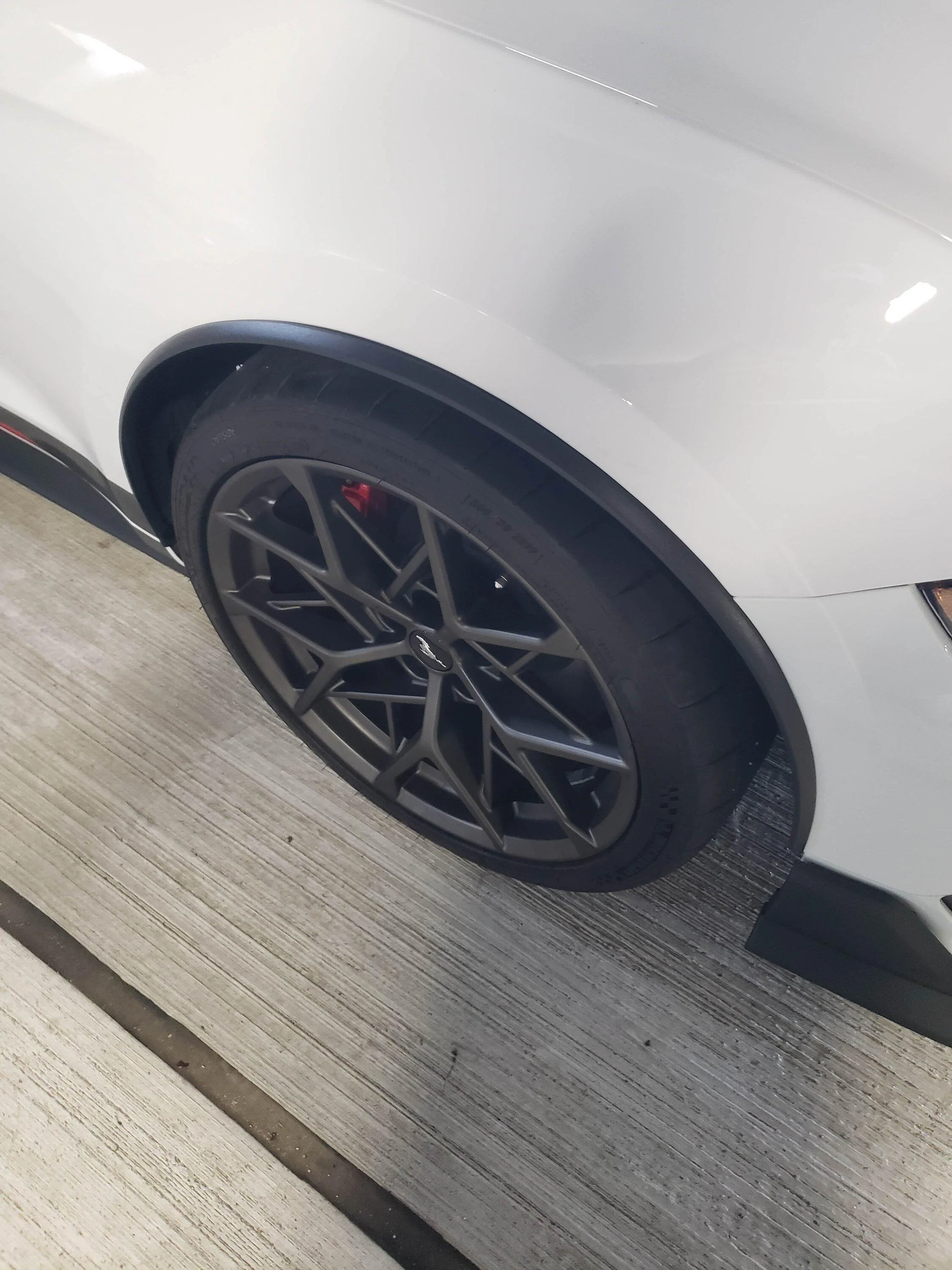

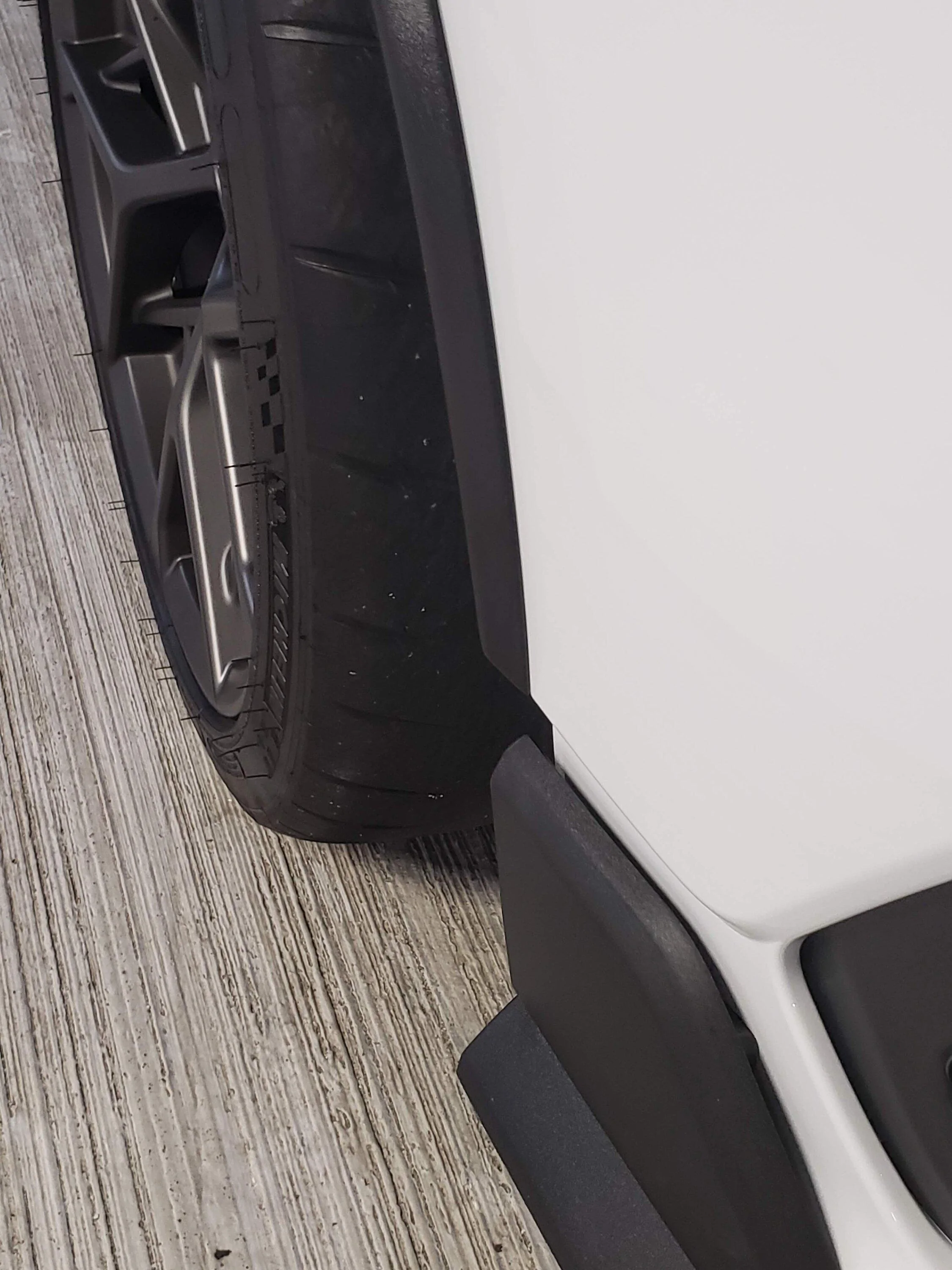

Figured I’d add a little more detail to this thread for those of us still hunting for the DH fender flares. I was able to source a driver side DH flare and “should” have the passenger side one in a few weeks. Paid more than I wanted to but hey, nothings better than OEM. I have attached a few more photos with the Mach 1 flares I retrofitted to my DH to show how they look with wheels, tires, and a drop. The wheels are BC Forged EH172’s wrapped in Michelin PS4S (305/30/19 and 315/30/19) and they’re made to the HP wheel specs (19x10.5/11) with corresponding offsets. The vehicle is also lowered on some Ford Performance springs that provide a modest .78 inch of a drop. I added the DH HP larger front splitter as well. The Mach 1 flares are definitely made of a thicker material and are not as flexible as the OEM DH ones.
