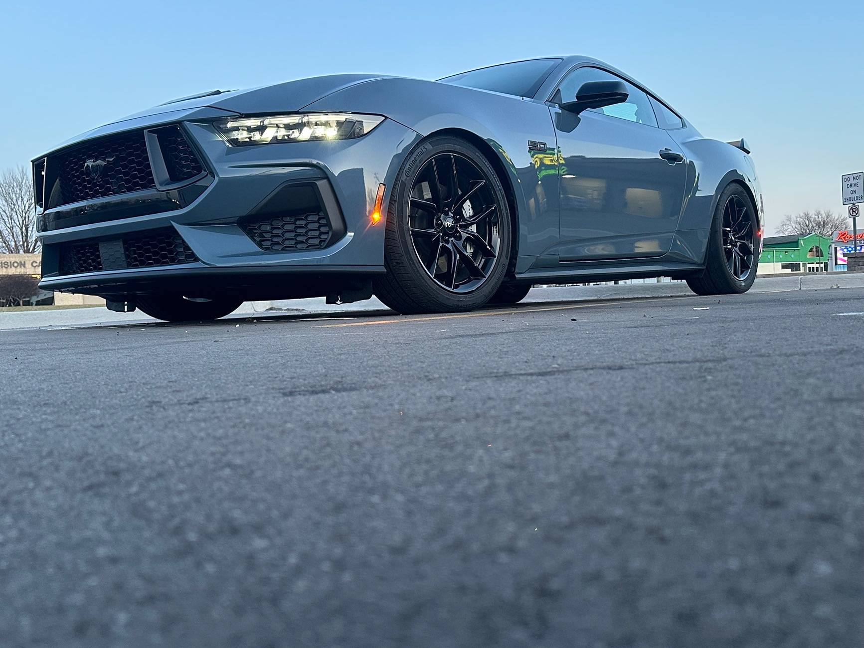

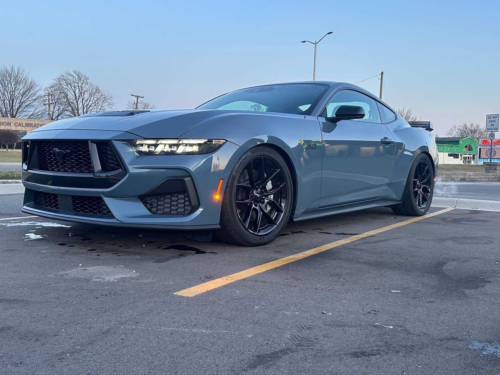

Steeda progressive …. Not too low… drives like a dream, I’m in Michigan and we’re known for terrible roads
Looks mean, awesome setup. Glad to hear its working well for you!
