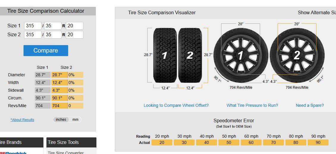

Do folks recommend swapping the rear to a 315/35R20 Nitto 555 RII or grabbing a smaller wheel and a Mickey Thompson ET Street SS?
I would say that I don't want tire with a taller diameter as I want to avoid rub issues. She is already about as close as I would want to get and I'm already stressed about the front being too low once the SC goes on.

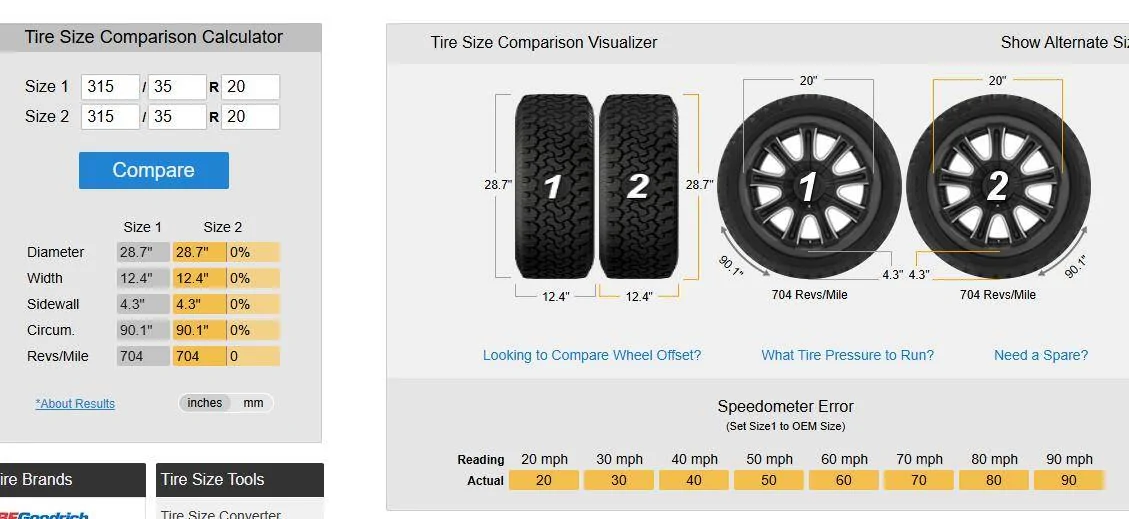

Here are the current rear wheel+tire dimensions (Sorry, had to have it listed twice as this is a Tire COMPARISON Webapp lol)

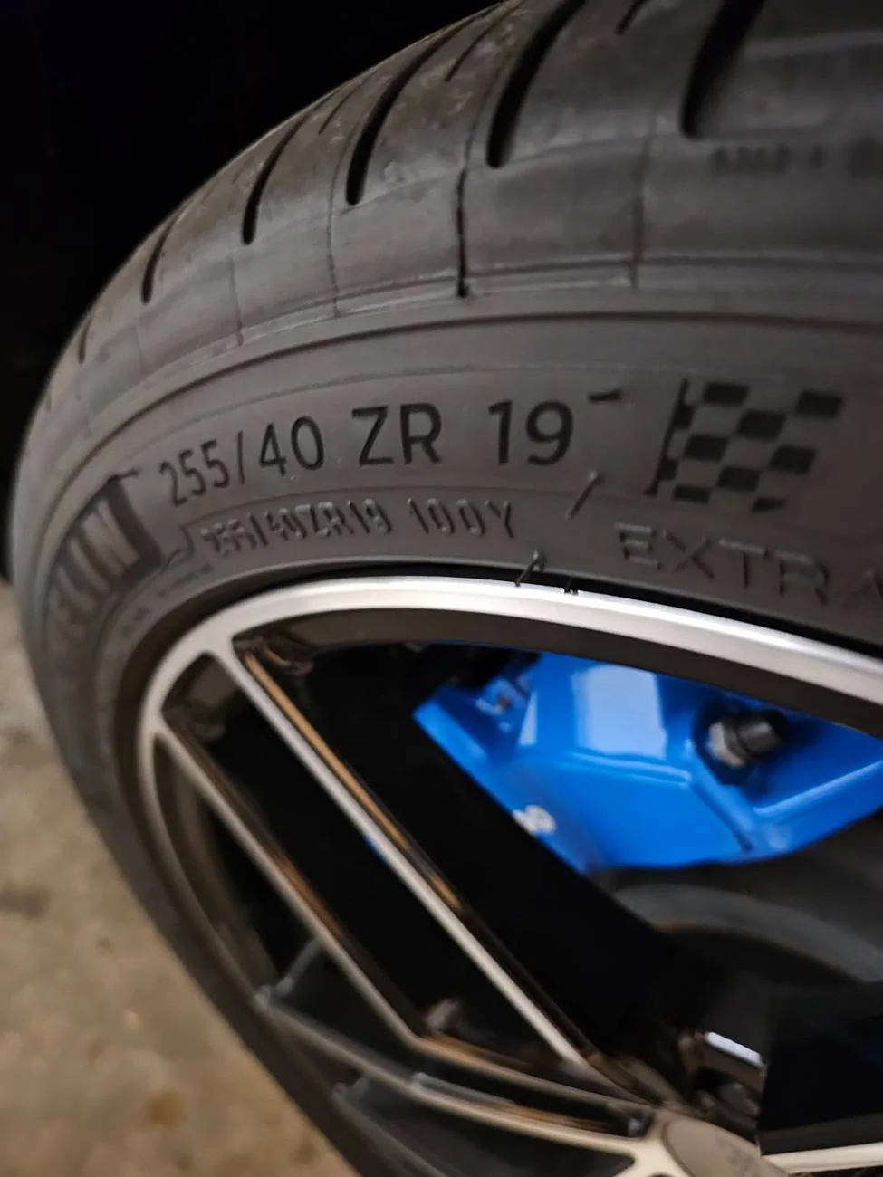

I bought a second set of rims that were all the same size and a set of Michelin Pilot Sport 4s for daily driving around town on and haven't had any issues with them so far. With the handling package you cant go any smaller than a 19" rim. I can't remember the exact size but I can look when I get home.

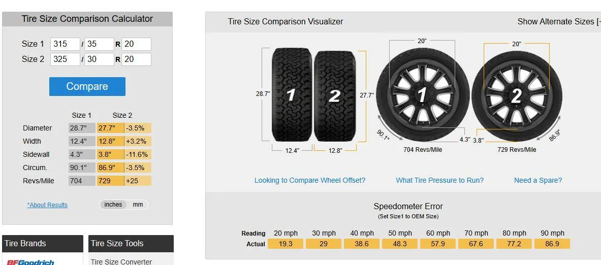

I'd go to a 27.7" tire myself
But if it's not rubbing now you would be fine with the same size RII
That's the 30 sidewall yeah? 325/30R20? That is starting to get into rubber band territory ;)

Here's the size I went with, same size on all 4 corners to make rotations better.
More like a 285/35 or something. Not sure what exact 20" sizes they make
