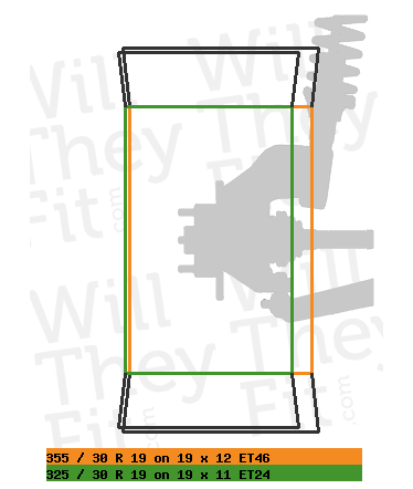

I’m curious, have you guys tried 19x11ET24 in the rears? That sounds like a much more convenient possibility if the poke isn’t too severe.
2,716
4,123
a 19X11 with +24mm might poke a bit, i have 19X12 with +46mm and have about an inch of poke
edit: looks like you would have more poke than me, which could have some serious clearance issues with the rear fenders

19X11 24mm front and 19x11 50mm rear or 19x11 50mm all around but front will use a spacer
