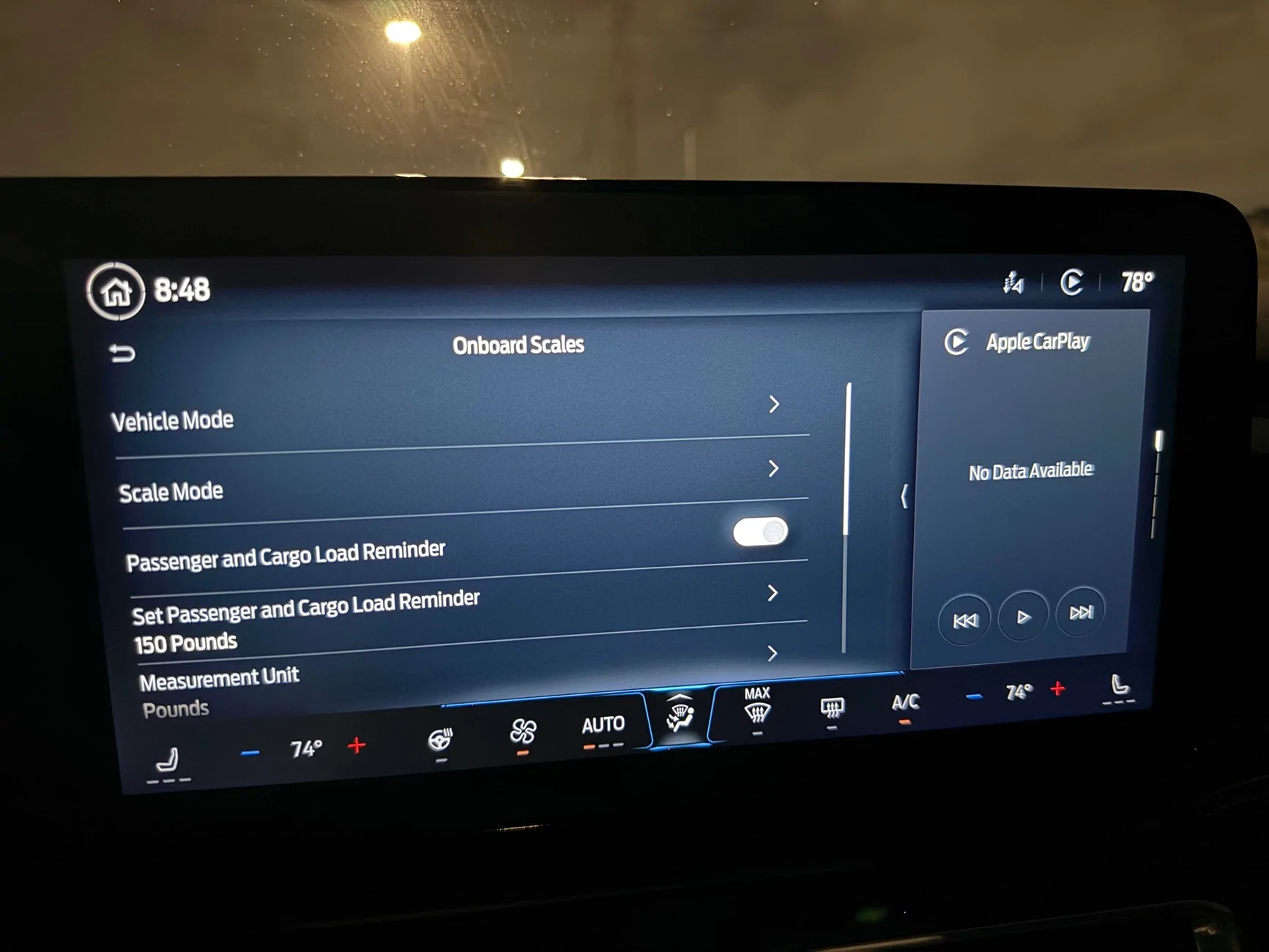

S650 Mustang Issues With CarPlay IMG_3096
I got this last night. Related to the F series truck software. Just got a software update a day or two ago. Happened when I was on CarPlay (Google Maps) and tapped the screen on the right that would typically take me to change music source. Played around with it and this would happen every time. Rebooted it and the problem went away. FWIW…. I always loose my back up lines when I reboot. They come back with a car restart.

Apple Carplay is known to be buggy. Android Auto has some occasional issues too. Its not a car thing, its the phone app and its connectivity with the infotainment. When my Android gets an update and I get in my car immediately after, Android Auto always glitches out.
Restarting the infotainment or phone will usually solve any glitches.

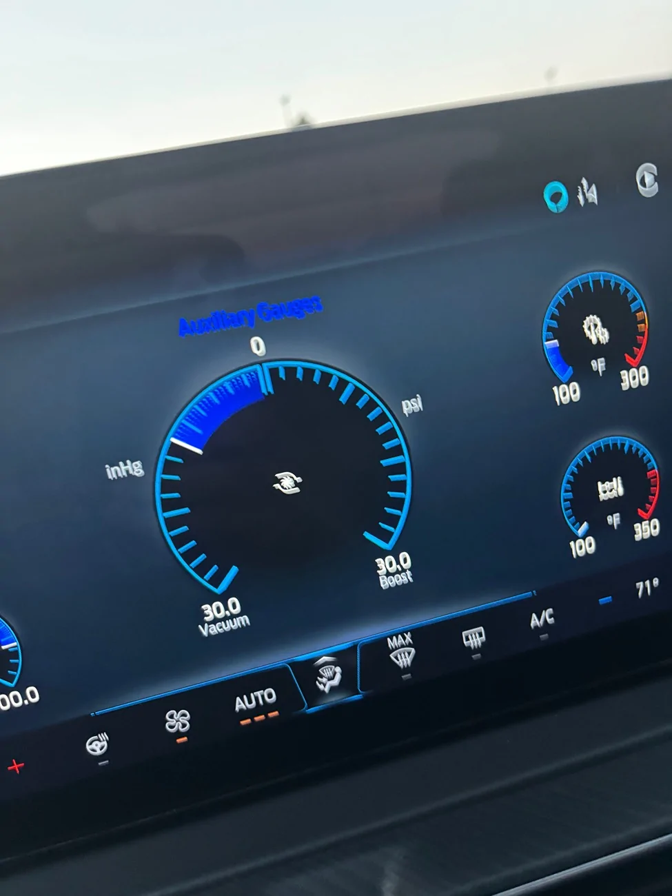

Apple car play and auxiliary gauges drive me nuts.. Apple car play works most of the time. When is doesn’t I either disconnect and start over or restart the car…The aux gauges is 50/50 and still haven’t been able to narrow down what to do and forget even looking at them .
3,877
5,464
What's happening with your auxiliary gauges?

Sometimes it will show boost sometimes it will default to show A/F. If it shows A/F, boost is not available when toggling through the gauges but VAC is available. If it takes a long time to load after hitting the “pony” button boost will show 50% of the time, if it loads immediately it will not be available and will go to A/F.. It doesnt matter how the car is started, Ford pass, remotely or in the car..For awhile it seemed to show boots when started by Ford pass.. but I later found out that wasn’t the issue. When boost is available it will go for a few starts and then disappear… I have the VAC gauge selected sometimes it will revert to show A/F .. I have learned to deal with it just go off the center vac/boost gauge if needed . But it still irritates me

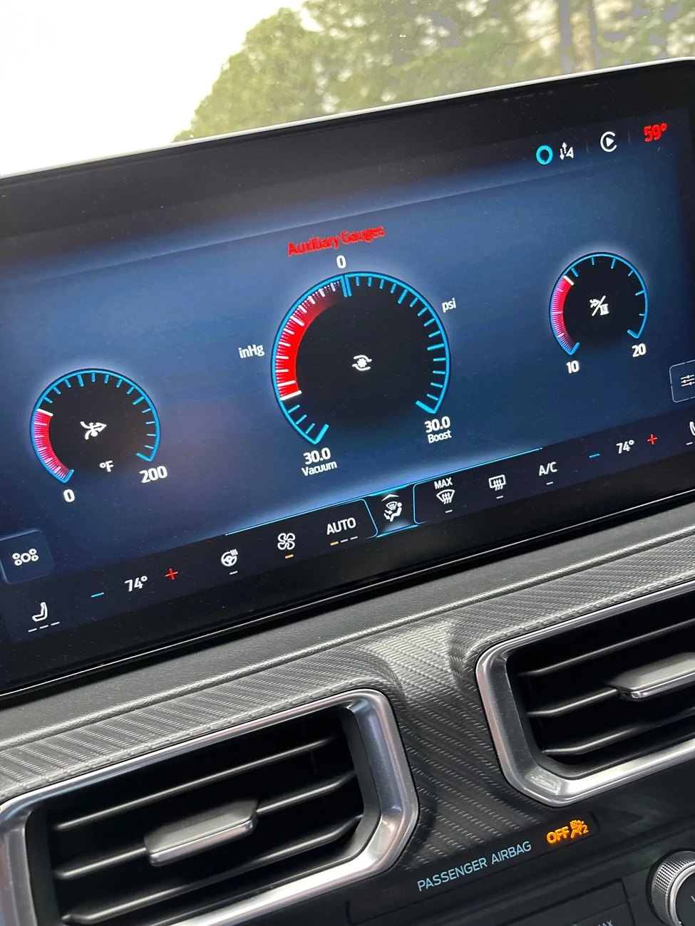

Yes … I have the 3 showing in the pic checked. Sometimes A/F will be where boost is.. have boost selected on both 3 gauge view and 4. Even if I have Vac selected it will sometimes show A/F.. I have deleted all profiles and keys.. doesn’t matter ..
