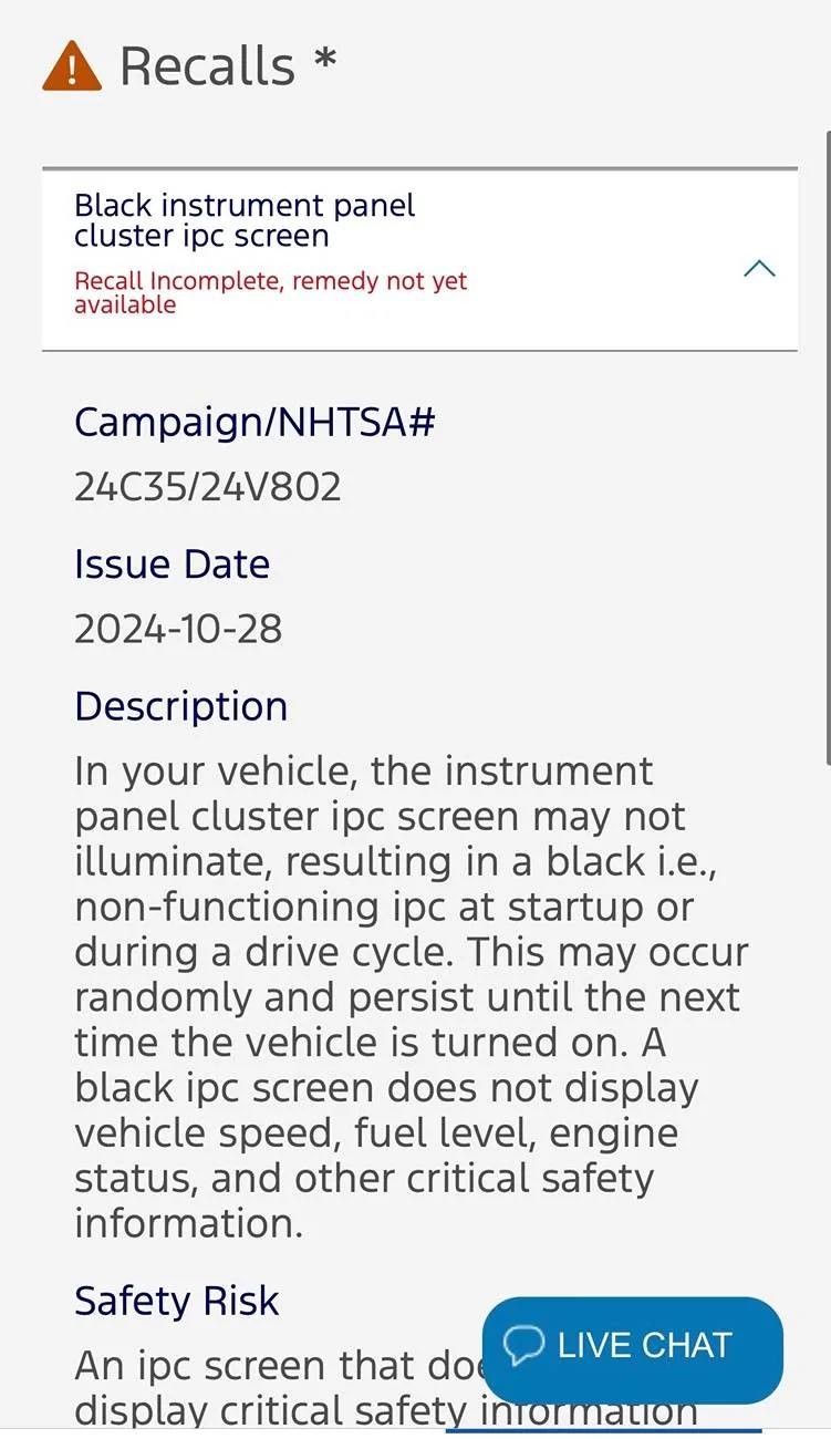

New recall just posted for this.
S650 Mustang Infotainment System Blanks Out Intermittently IMG_0929
That is actually a different issue. This as the OP describes is the Right screen (Radio/AC). This is a known and common issue with the Ford Sync systems. I have had it on 4 other vehicles. It would usually fix after a restart for me.
Oh okay, I guess the recall itself is talking about the main display.
