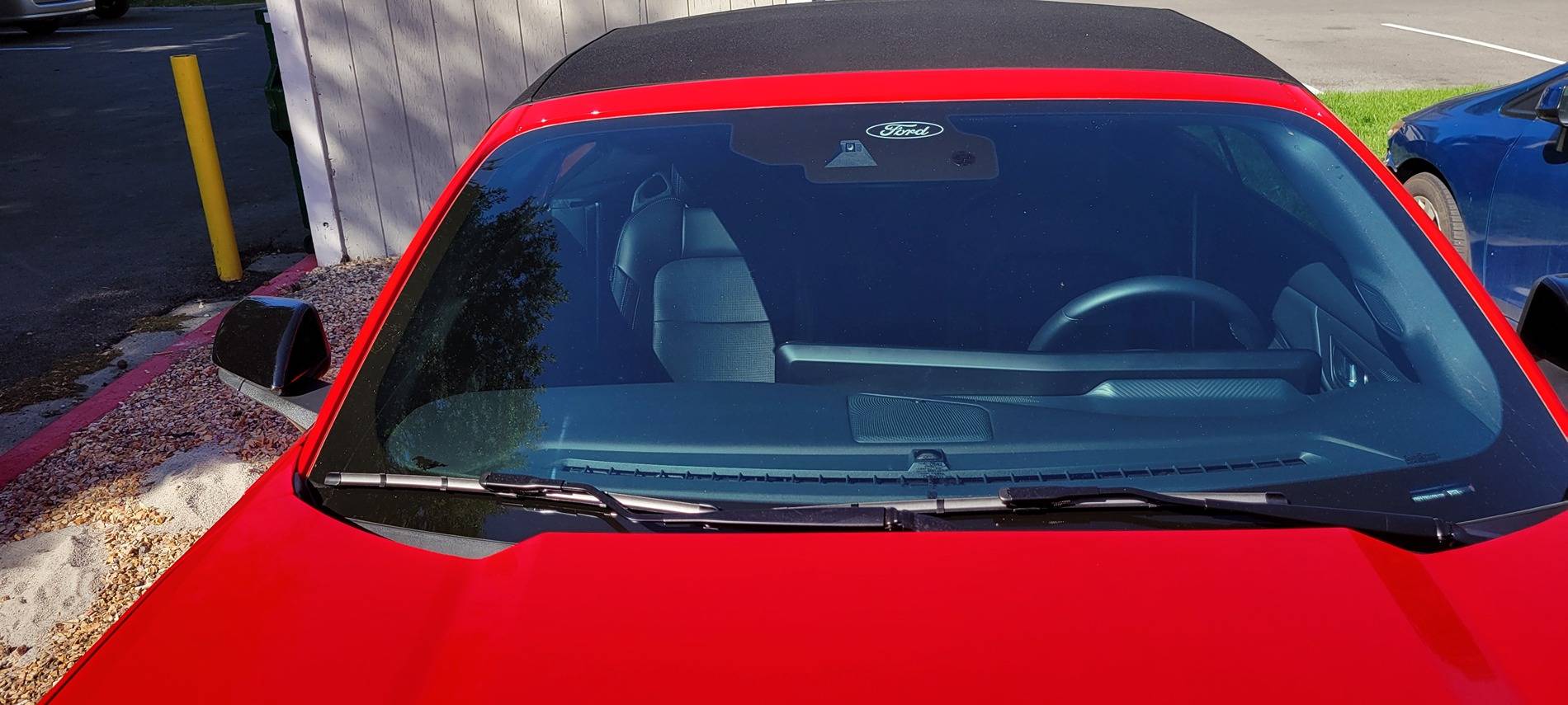

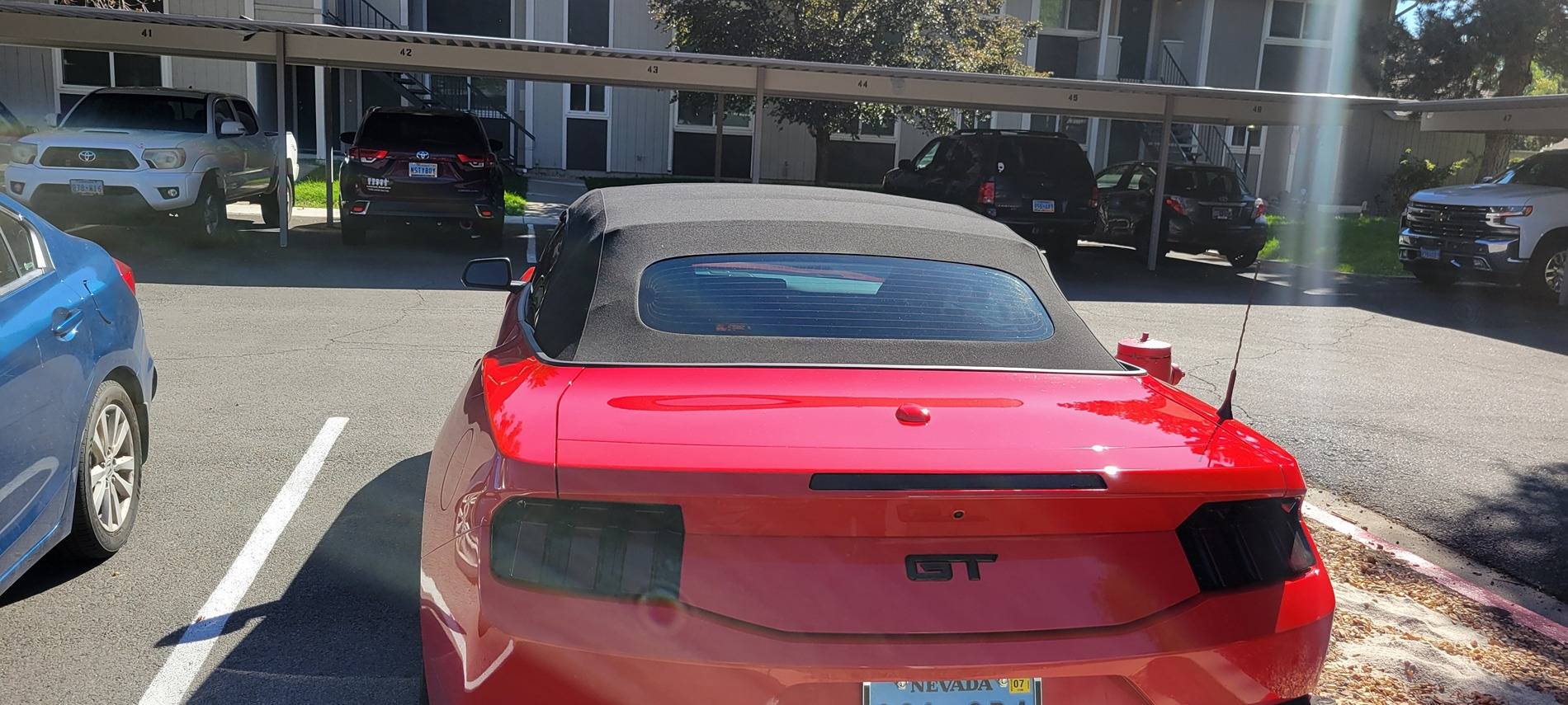

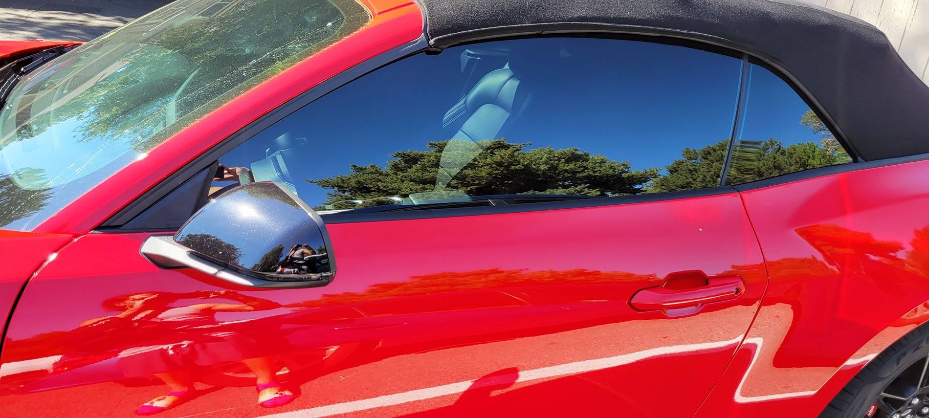

Front windshield is 70%, side windows are 25% but with the factory tint more like 17%, rear windshield on my convertible is 55%. I'm very unhappy with how it turned out because it's just not dark enough and the car still gets hot if left in the sun. Had i done 35% on the rear I'd probably be at peace with it but now I'm going to redo all of it.
I'm thinking either 35 or 55% in the front, and 15 or 25% in the rear, still debating whether I will change the 25% side windows to 15% which with the factory tint will make it closer to 8%, so if I keep them 25% I will c
S650 Mustang I chose the wrong tint 1000010177
S650 Mustang I chose the wrong tint 1000010176
hange the rear windshield to 25%, but if I go with the 15% i will do 15% on the back to match. I also just blacked out my tail lights and brake lights so the 55% definitely does not match but I'm not sure how dark to go
What have others done and what are your suggestions for mine? Some asshole keyed my car too and it penetrated the ppf so the entire driver side has to be repainted and replaced. I hate people

Reno, NV, uncovered, black roof and vert fabric top. I feel a vert is going to be hotter than other cars, all else being same.
I noticed covered parking in some of the photos. If paying a bit more for a covered slot is an option, that could be worthwhile.

I did like a 90% ceramic tint on our windshield. You can't really tell its tinted , but the heat rejection is phenomenal. I agree with Bikeman315 that you don't need to go dangerously dark , just buy the good ceramic film.
I also use a sunscreen when parked in the direct sunlight. No tint will reject heat better.

Mine is ceramic, kavaca best in market, 70 front 55 back 25 sides and i hate the front and especially the back, it doesn't match the windows or my blacked out tail lights abs brake lights so i am going to have to have it redone. Had i done 35 back i would have been content, but that's on me for being an idiot

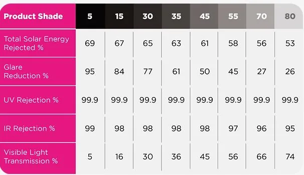

Not an idiot in the least. We all make decisions and then change our mind. But here are the numbers for your tint. Note the UV reduction is the same across the line. IR is only 2% 70% & 35%. Even total solar energy rejection is only 56% to 63%. So if you have 70% on the windshield leave it. On the back to whatever you want.

May go 5 or 15 on sides and back and 35 or 55 front to feel like I'm getting my money's worth. At night what i have is noticeable during the day but not so much, and the interior is still hotter than I'd like it to be. Is it better than it was with nothing? Yes, but i still feel like i need a sun shade, but you're right, small difference in total heat rejection between 70 55 35 even 15 isn't much different, but the sides at 25 sure do feel cooler than the front at 70, which is why I'm wishing i had at least done 55 front 35 rear, could have lived with that
