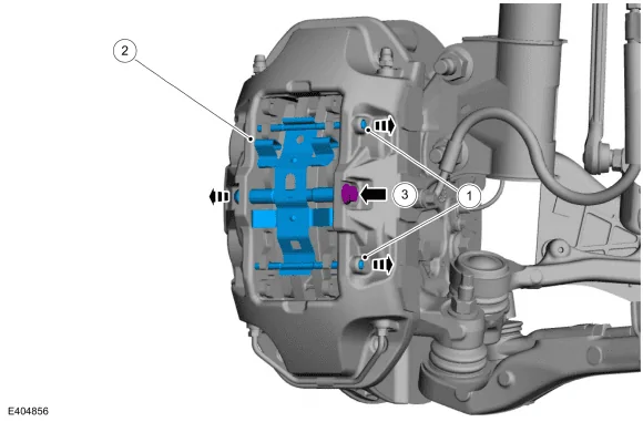

here's the directions from the workshop manual (for base GT front brakes, also applies to Brembo front and rear and parking brakes):
Activate the brake service mode.
Refer to: Brake Service Mode Activation and Deactivation (206-00 Brake System - General Information, General Procedures).
Remove the wheel and tire.
Refer to: Wheel and Tire (204-04A Wheels and Tires, Removal and Installation).
NOTE: Note the position of the components before removal.
  1. Remove the brake pad pins.
  2. Remove the brake pad spring.
  3. Remove the screw and tie rod.

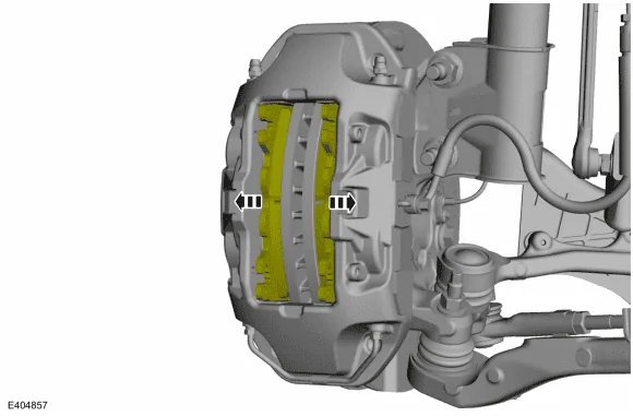

NOTICE: The operation for retraction of the pistons described below may cause a surge in the level of the brake fluid in the reservoir. Ensure that the fluid does not overflow, damaging the painted parts of vehicle.
NOTICE: Use care when pushing the caliper piston into the caliper piston bores or damage to components may occur.
If installing new brake pads.
Using a brake pad spreader tool, compress the brake caliper pistons and remove the brake pads.
Use the General Equipment: Brake Caliper Piston Retractor

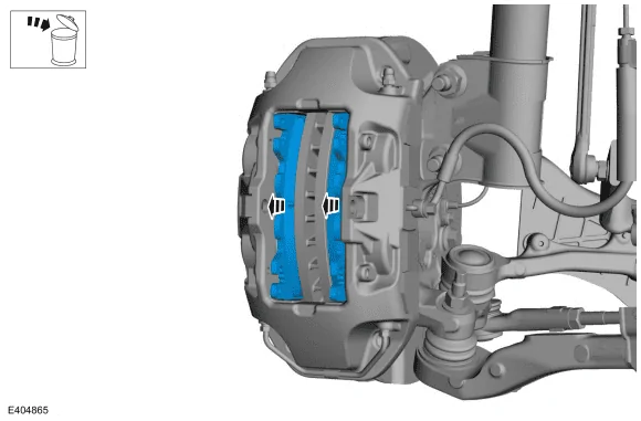

Remove the brake pads. Discards if installing new.
