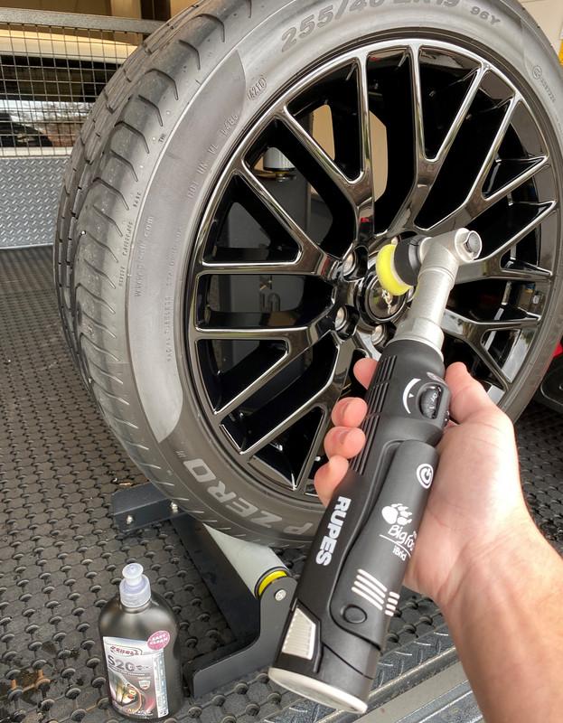

To remove a ceramic coating, you need to abrade it from the treated surface. That doesn't mean wet-sanding, rather a polish. Try using something like Sonax Perfect Finish or Rupes DA Fine.

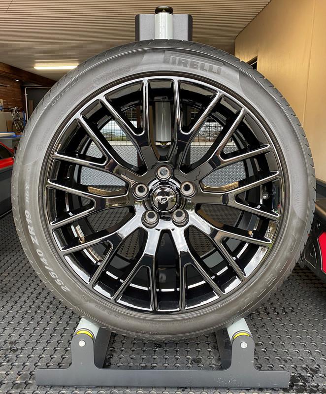

S650 Mustang How to remove Gyeon Q² Rim? gtr101
Gyeon Total Remover is apparently able to strip ceramic coatings. It's only just been announced but should be available in the next few months. This would save you from polishing those PP wheels, I've done it before and hope never to do so again! :crazy:
