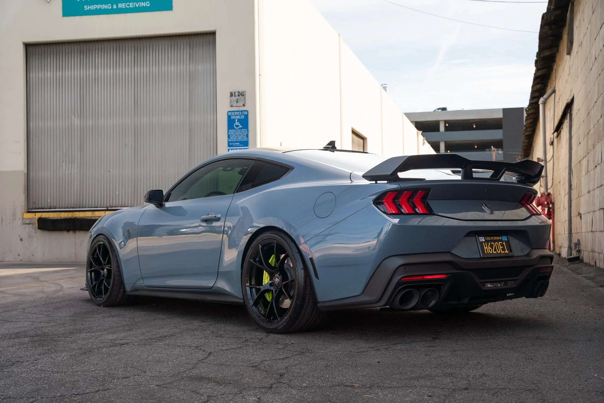

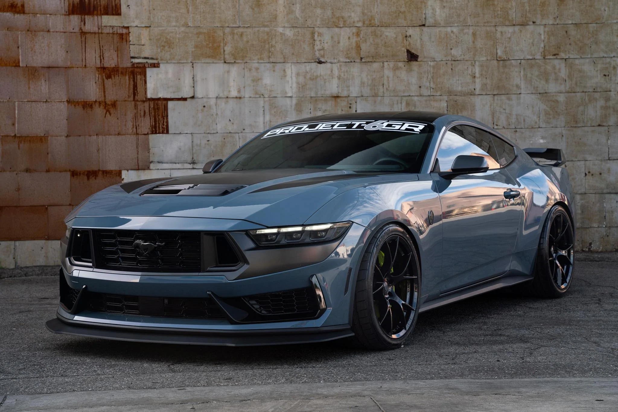

I just bought a Dark Horse with the handling package. I want/need to drive this in North East Ohio. Current rim size does not allow an all season tire. Would putting the GT rims on my DH be an issue? The service guy said it could be an issue. Thanks in advance!
We have all our designs in stock ready to ship in gloss black, can mount a set of tires for you as well ! Let us know !

I just bought these rims from project 6
Black 10 spoke Wheels: 20x11 20x11.5
305/30/20 squared all seasons.
Pretty excited!!
Should fit as this setup is already on a DH they have.
