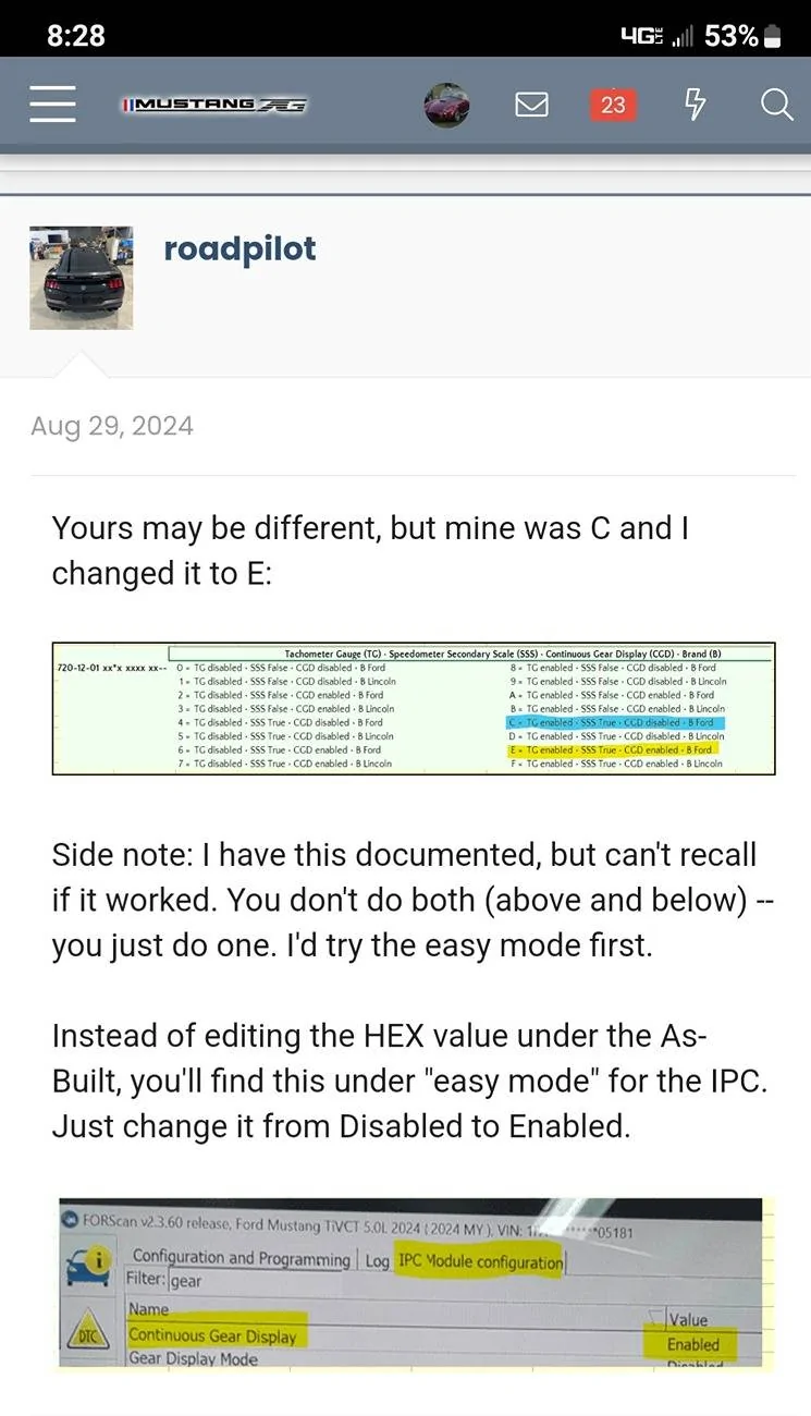

Anybody figure out how to keep the gear position on the dash? The 2022 airways showed what gear the transmission (A10) was on

Where do i get forscan, and does it compromise warranty or anything?

Try this.

Yes... the post you quoted is it...
