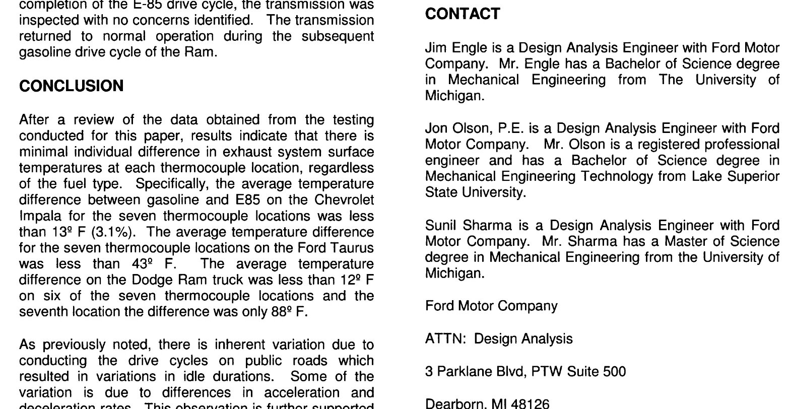

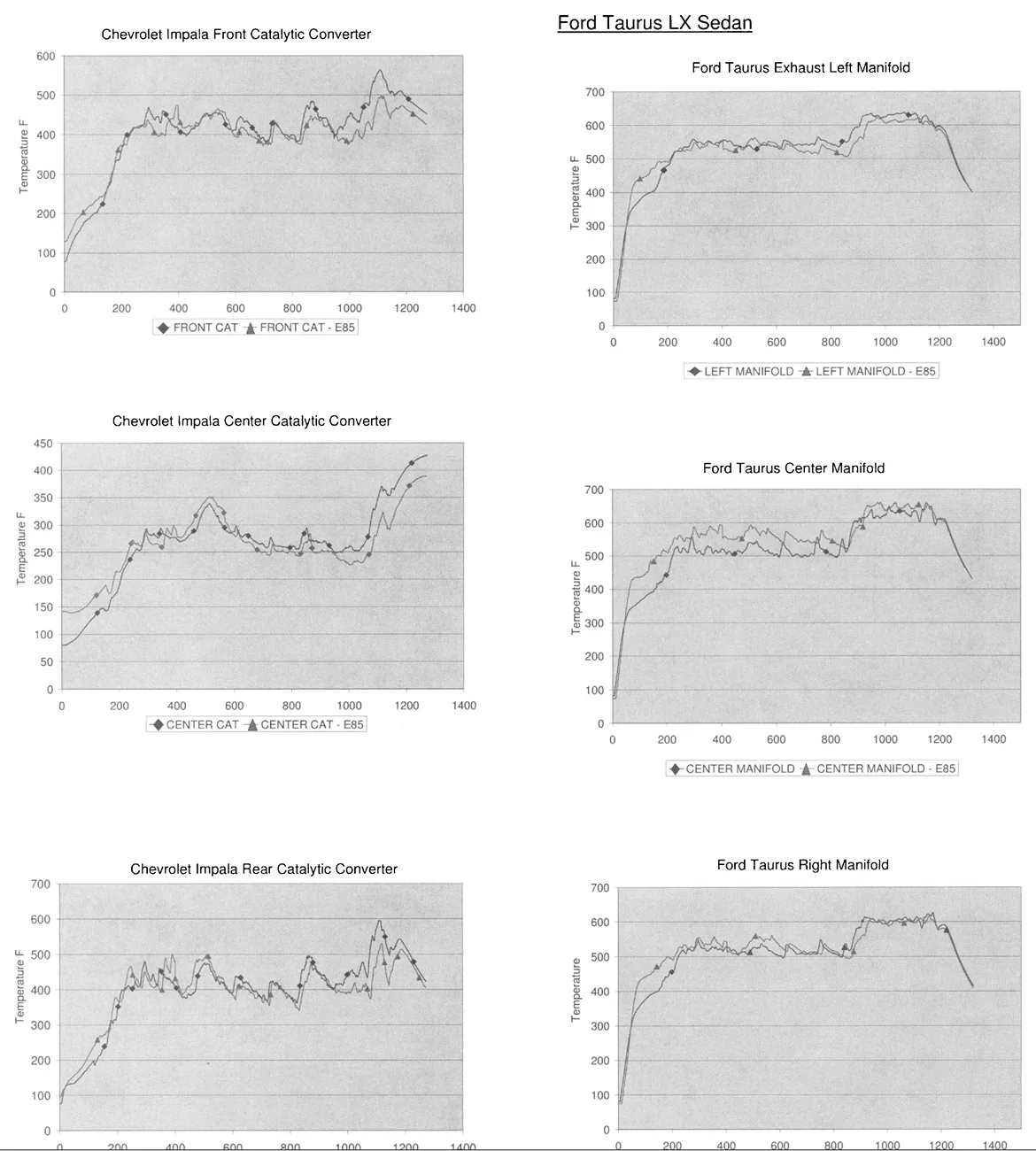

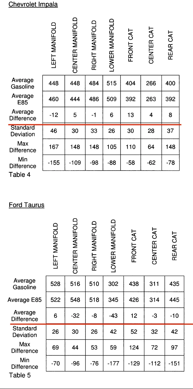

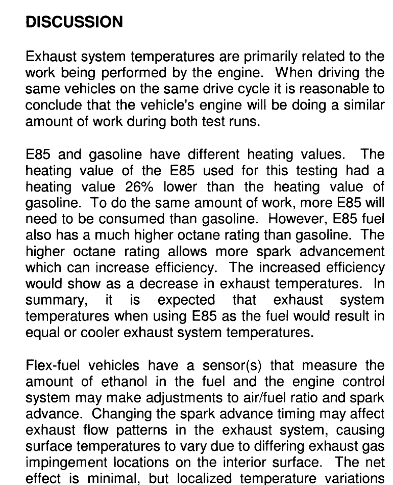

That said, there is a research paper out there that compares exhaust manifold temperatures between gasoline and e85. It was generally a little bit lower with e85 but is it as much as people are expecting?
