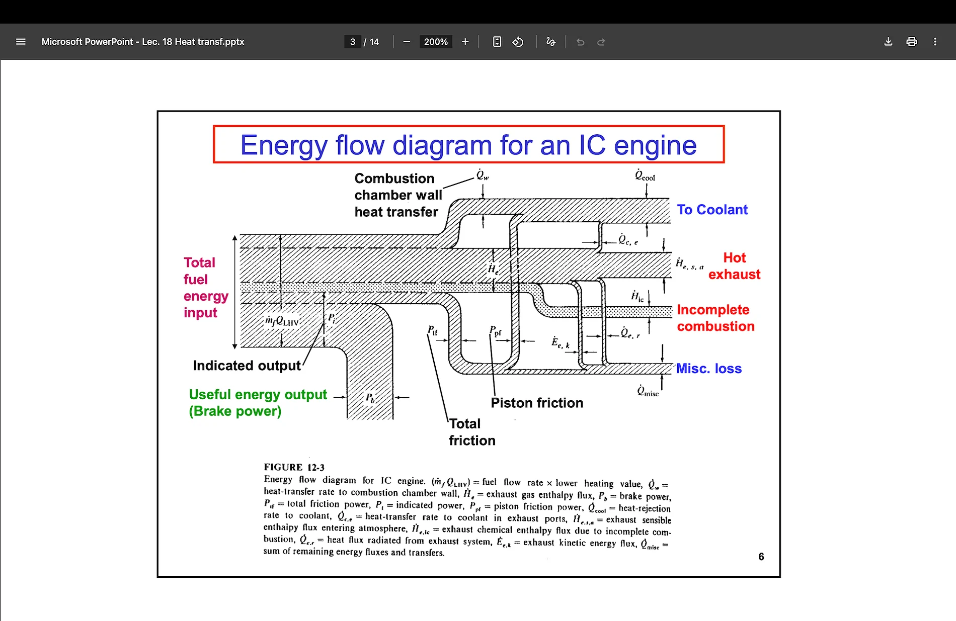

Attached is a slideshow from MIT. On page 3, chart 6, there is a slide displaying the possible energy output of a set amount of fuel and what happens in an engine. Overgeneralizing, 1/3 is usable energy, 1/3 is lost as heat exhaust gases, 1/3 is captured and carried away by the coolant and later radiator.
In the diagram is a link (Qc, e) between hot exhaust and coolant; it's a small amount of transfer. And that's a good thing. Considering the amount of heat in the gas, if it was transferred to the cylinder walls with greater efficiency, we'd have a serious overheating issue on our hands. Looking at that in reverse, if the chamber gases were cooler, while they would lower coolant and oil temperatures, it wouldn't be by much.
