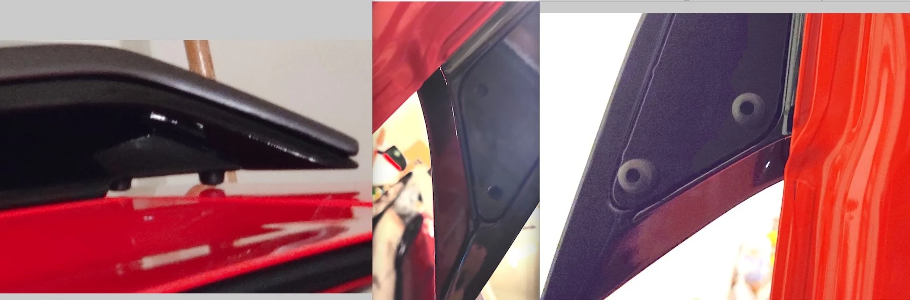

OK, I was washing my DH today and while drying the rear spoiler I noticed that I was missing two black rubber bumper-stops on driver side bottom wing part of the spoiler. I looked on the other side and those two were still there. Not sure if they were missing from factory or just fell off while driving. After detailed inspection I noticed that the drilled holes were not properly deburred and smooth with the metal surface. I also noticed that on the driver side when the trunk is closed that these rubber stops do not touch the body of the car. What is their used case? Next I started searching Ford factory part numbers for these and noticed that all the DH factory spoiler parts drawing did not show this rubber part. If anyone knows what the factory part number is for these parts please post them on this forum. Maybe my spoiler was a pre-production prototype or Ford workers at factory forgot to install them?
Pictures attached for reference.

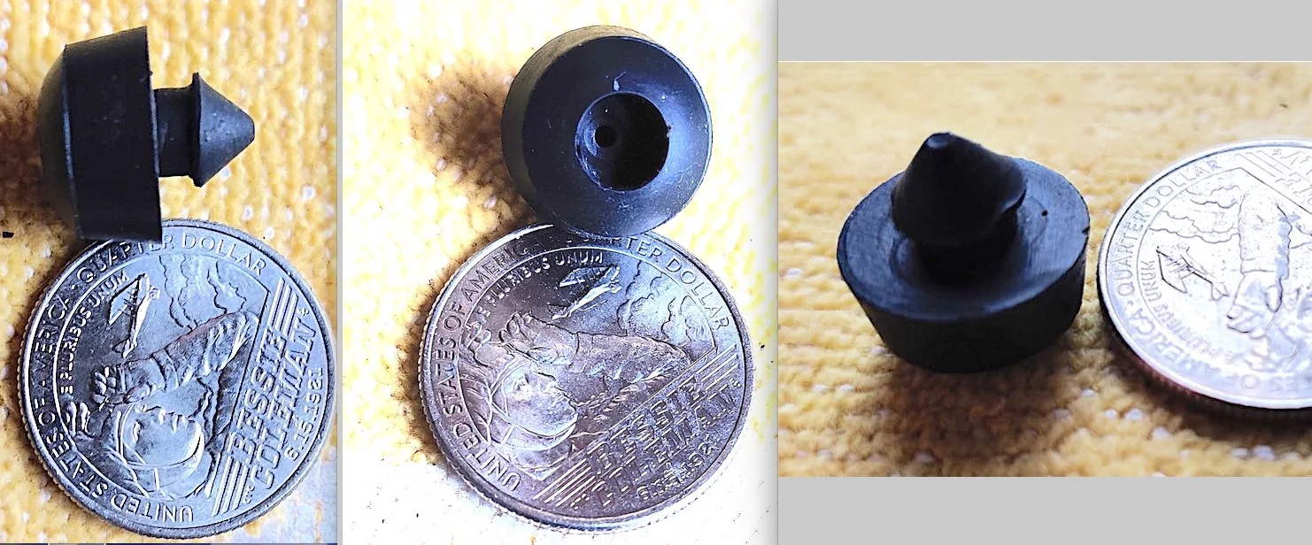

So, I started searching online Ford parts catalog again and found that similar rubber bumper is in the side of the front glove box, but that bumper is little longer by about 2mm.
Next, I searched under "Rubber Bumpers" in the Ford catalog and got a hit on Ford W713055-S300, but it looks like that bumper is described to have multiple functionality for Door Shell, Lift-Gate or Hinge. This part has no data on overall size and the catalog photo attached make the part look larger compare to the spoiler bumper part. Now, I need to visit a dealer that has the W713055-S300 in stock so I can see the actual part size. Stay tuned...the search goes on!

My DH spoiler that came with the car starts with Ford part number PR3Z-634421- EC or ABPTM but none of those spoilers show the bumper part. I did purchase the W713055-S300 part but that fits inside the glove box, but it is longer and can't be used on the spoiler.

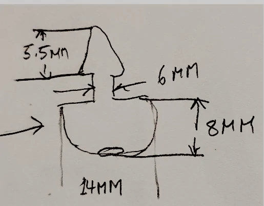

I wish I had the engineering OEM parts list for the DH spoiler. If anyone knows what company makes the DH spoiler for Ford that would be helpful. I am attaching a sketch of the size on the spoiler rubber bumper for reference with hope that someone on this forum can help.

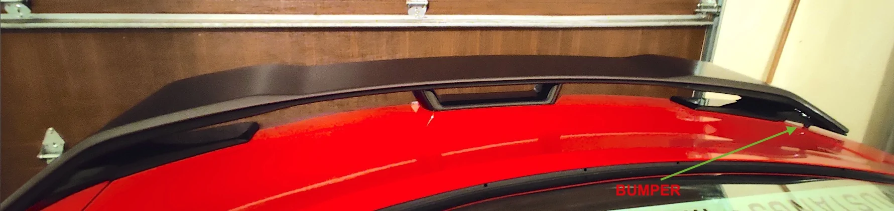

My was March 2024 production delivered to a dealer in April that year. Spoiler picture attached/
