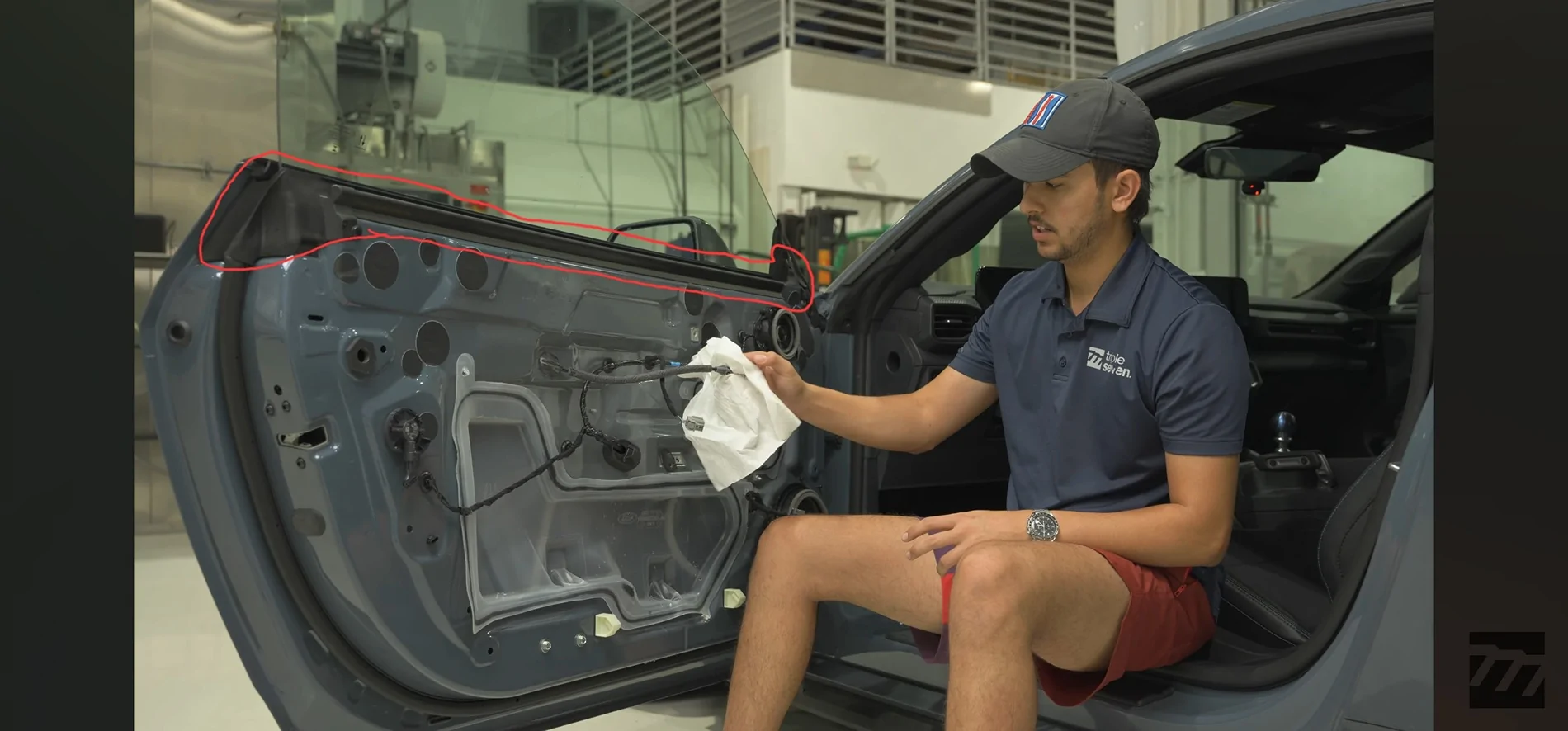

1/8in thick Dynaliner. This video shows how to remove the door card:
My rattle was top of the door card while listening to music. Appeared when it got below freezing and never went away. The card hooks onto a piece of rubber/plastic trim at the base of the window which itself slides down onto the door. If you look into the gap the window sits between you'll see some velvety trim, the one closer inside the car is the trim piece I'm talking about. Since the door card just hooks onto that piece it rattled like hell with music for me.
I pulled my doors apart and installed Dynamat on the inside of the outer shell, for "fun" (it took 10 hours šŸ’€). The real fix for rattles was Dynaliner. Remove door card, remove the trim piece it hooks onto at the base of the window (held on by friction/compression and three rubber pushpin-like moldings), apply Dynaliner to top edge wrapping it down about 2in, don't apply any into the window well or that trim piece won't sit flush, just on tippy top edge and down the side closer to the cabin. Put the trim piece back on, I had to gently hammer it down with my fist to compress the foam. Apply Dynaliner in the valley of that trim piece and down the side closer to the cabin. Basically you're sandwiching that piece between foam. Hang the door card back on, bolt it up, rattles with bass should be gone.
If you wanna be extra you can replace the factory foam strip with a wider piece of Dynaliner around the perimeter of the door card.
The trim I've been talking about don't know the name:
