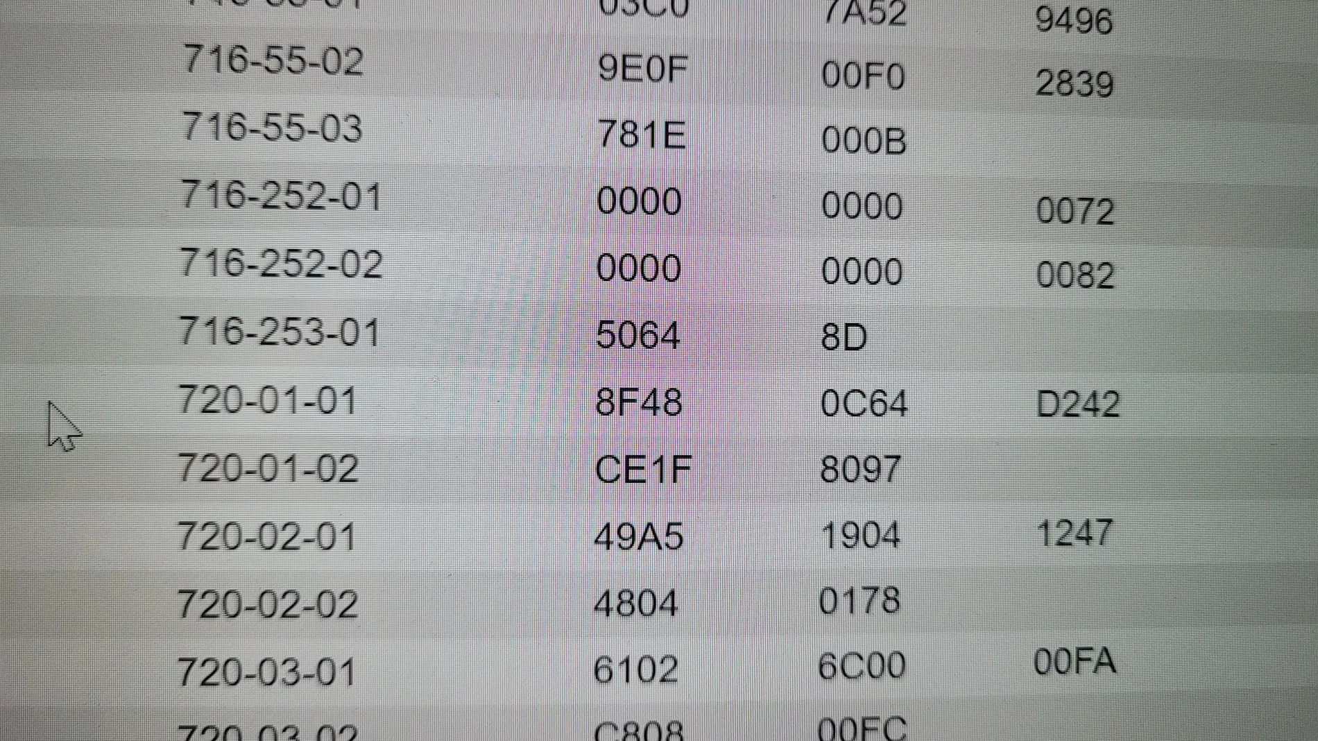

Go to that motorcraft website, enter your VIN and once you see the very long table on the website, search for the line 720-01-01 and post the complete line here.
You do not need to download the file.
Just realized you said to search 720-01-01, but circled another line.
This is mine -

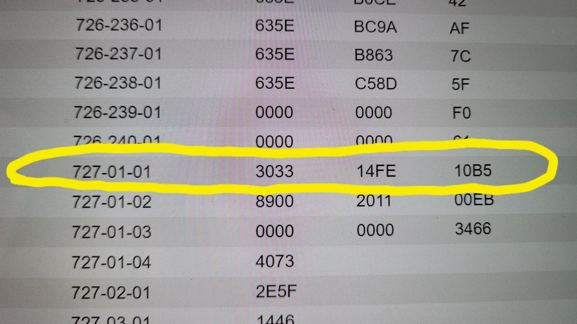

727-01-01 is the line to look at, as shown in my screenshot.
I corrected my typo.
The first value in the third column needs to be set to zero, then ESE is turned off.

Have someone change the D to a 0 (zero) and you're done.

That means ESE is turned on in your Mustang.
Do you have the B&O system?

Ok, here it is, CORRECT line, no 0 there (but no D), so it is activated.
The first value in the third column is a 1.
ESE Activated (although probably not in Top Fuel Nitromethane sound effect mode, maybe Mario Kart sound effect mode).
Must turn to 0 and see difference, but, well, not sure about purchasing a PC laptop just for this.

But he posted line 720-01-01. Did you not just say thats the wrong line?
Yes, wrong line.
You already went to the correct line in post #77, and he has edited his prior post to correct the typo.
Yours is a "1," too, so your ESE is activated. Maybe in Honda Civic with Glass Packs Mode. Blap! Blap! (Sam Kinison standup routine reference)
