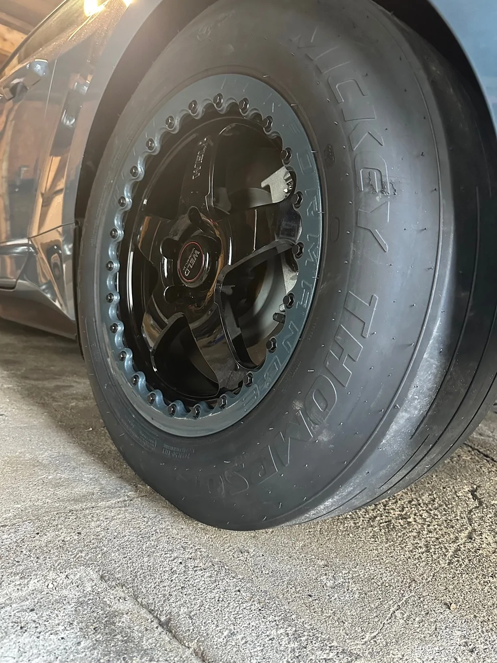

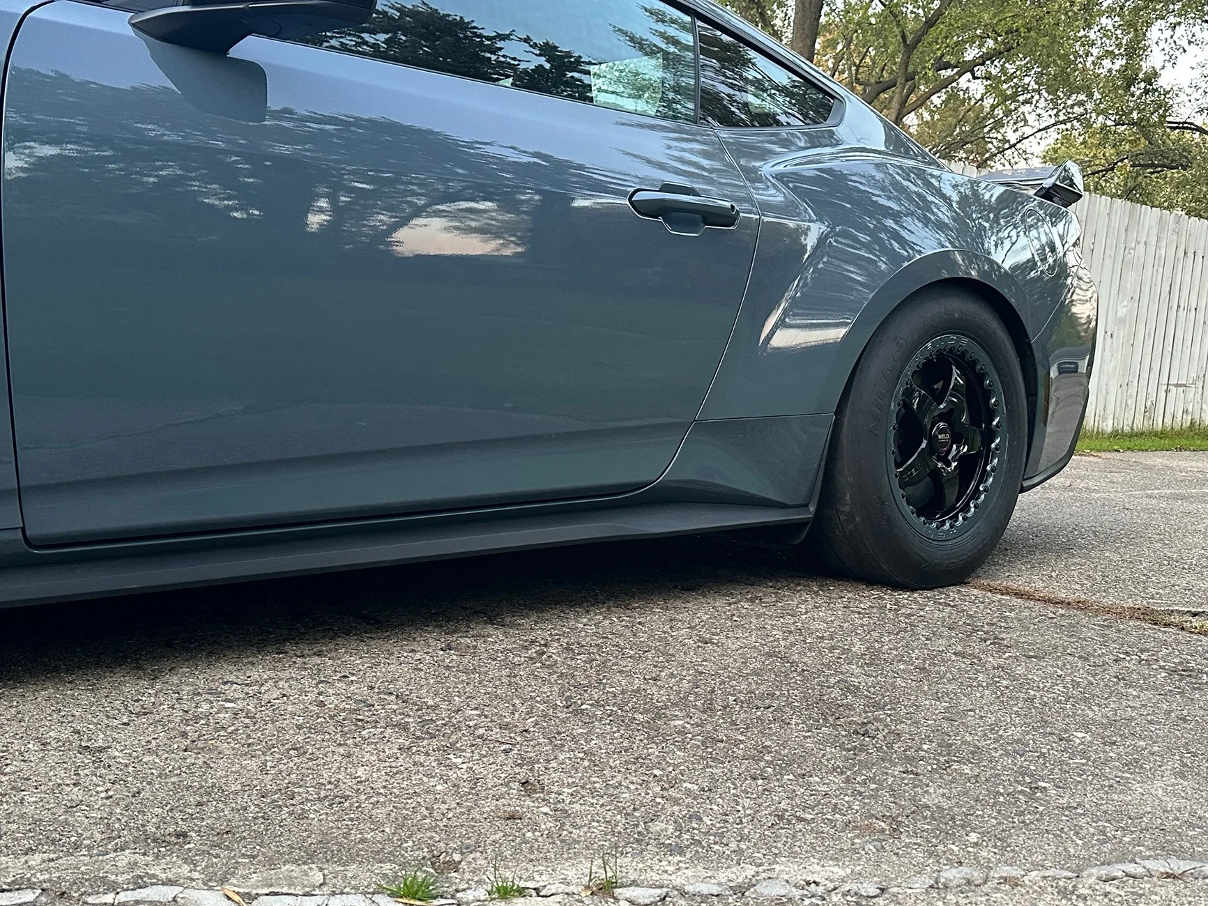

Nice what tires are you running out the back? I just want to San Diego. I saw a hellcat running in 305 m/t ET streets and he spun big time. Your tires look like a bias ply which hook up the best I broken the 11s. I think I had a 1.8
60 foot with totally stock suspension factory 255 continental AS.

Yeah 28/11/17 bias ply et street Rs. I usually can cut a low 1.5/ high 1.4 60ft just by staging and flashing the stock converter off idle.
