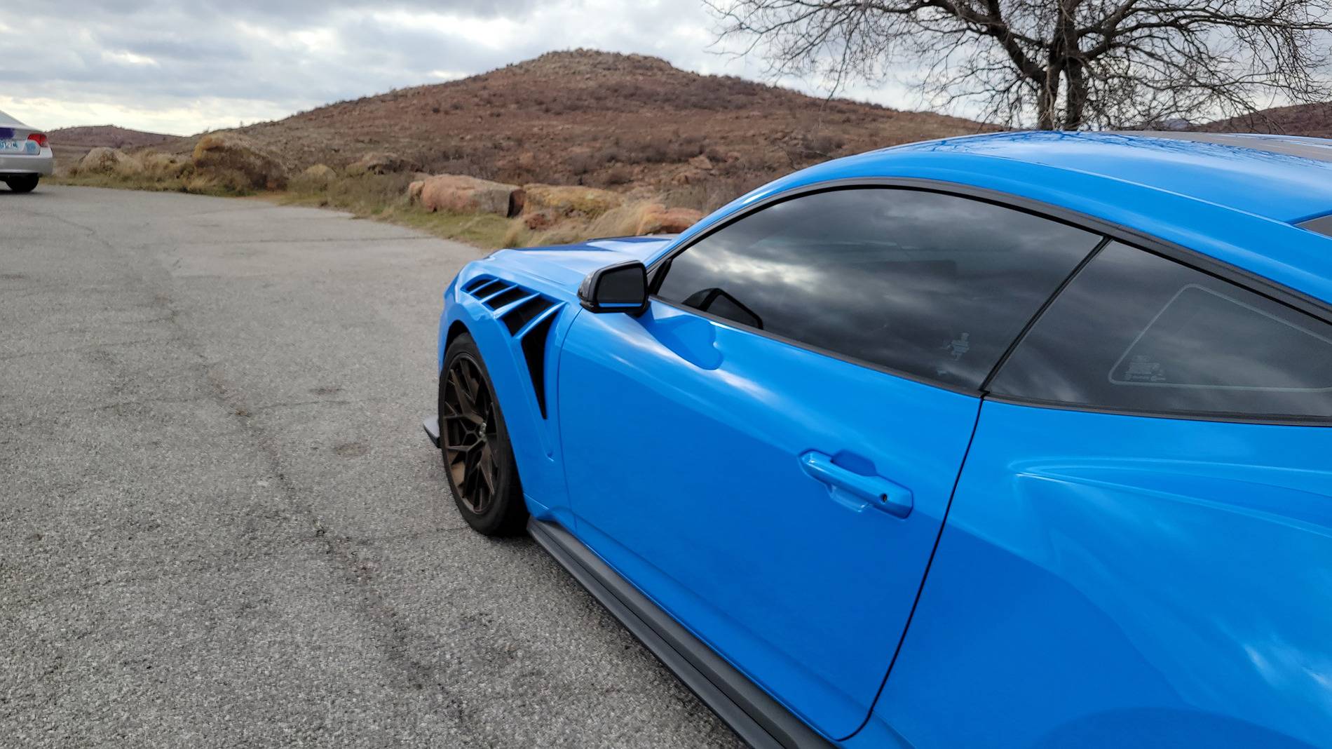

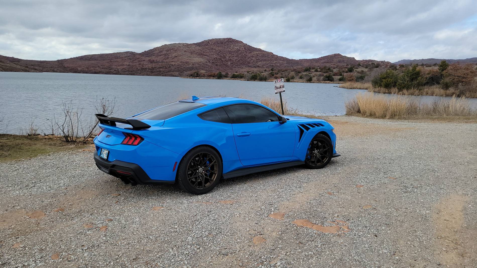

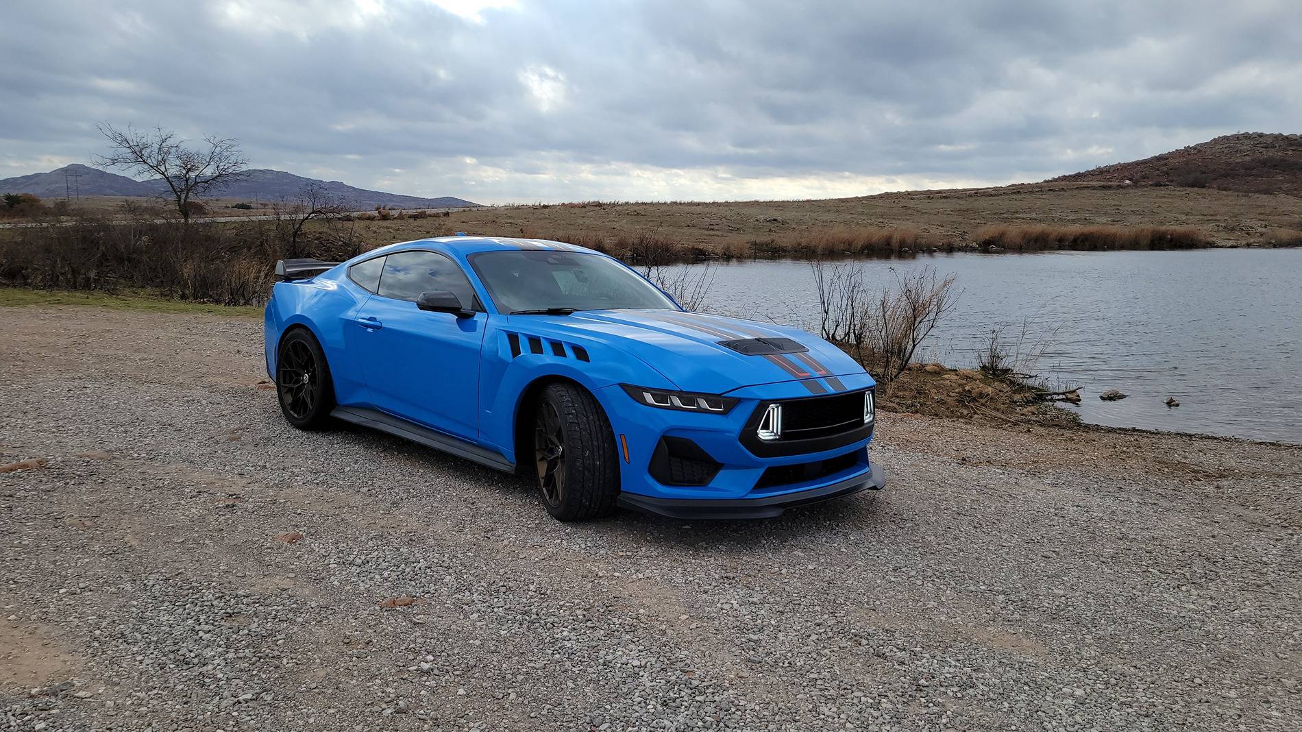

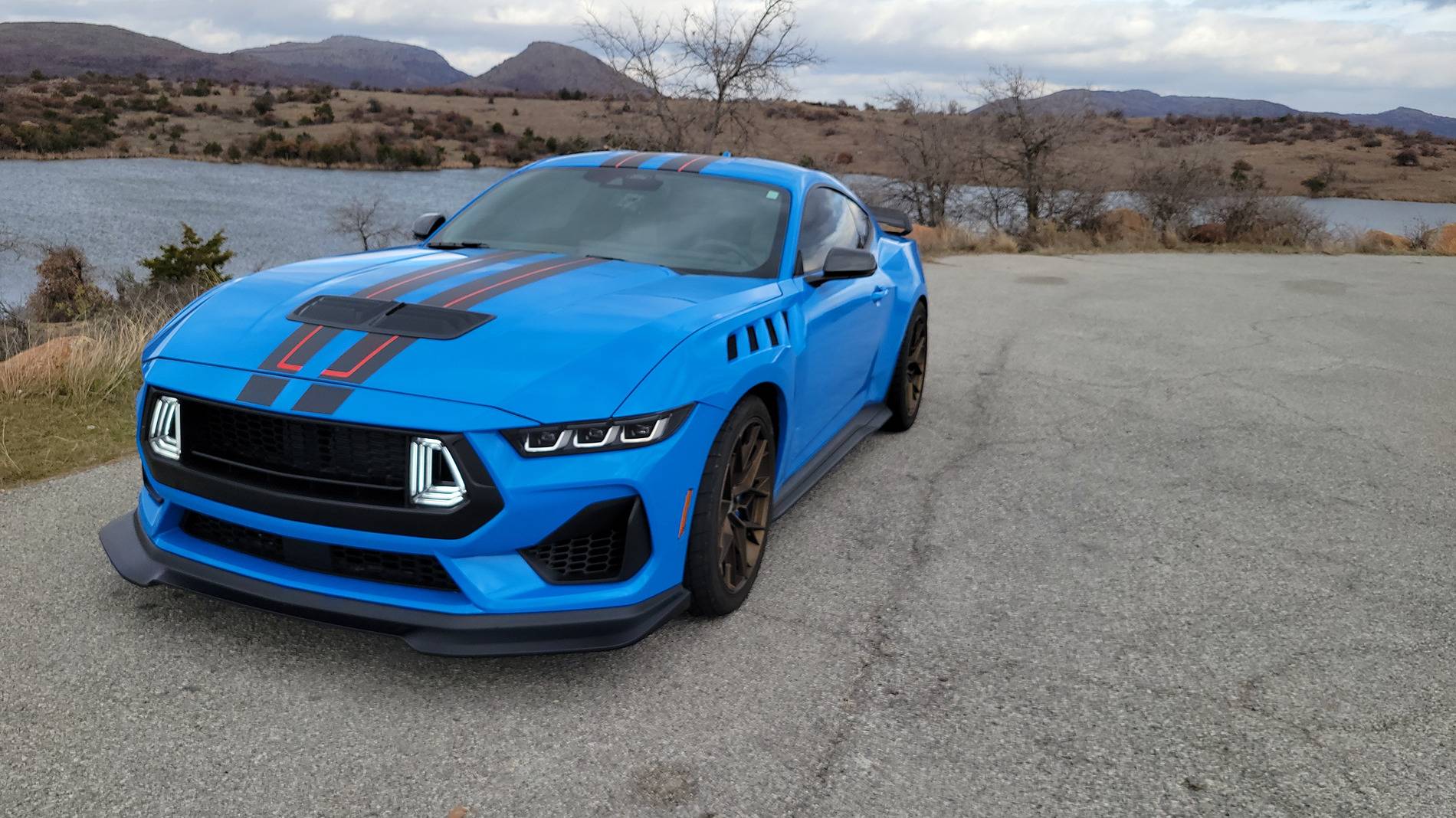

Finally got them painted and installed. Love how they came out, for now they're just fancy heat extractor's as ill need to modify the wheel liners to allow actual airflow.
S650 Mustang Greywolfes Blue Baby 20241213_141920
S650 Mustang Greywolfes Blue Baby 20241213_141947
S650 Mustang Greywolfes Blue Baby 20241213_142324
S650 Mustang Greywolfes Blue Baby 20241213_142345
One thing to note if you go through with something like this, you'll want to paint the body as it's not painted under the stock fender, a simple black layer will do
S650 Mustang Greywolfes Blue Baby 20241213_142012

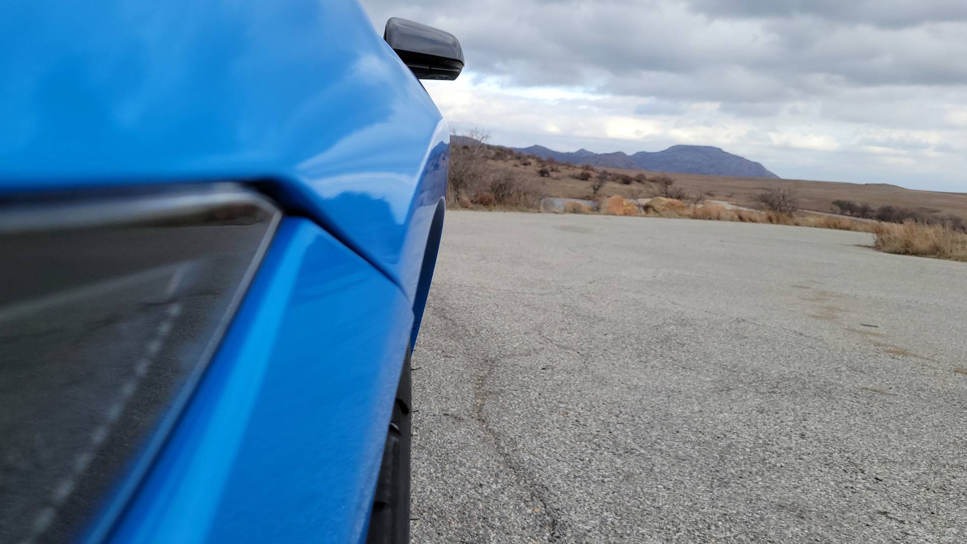

Alas my hubris knows no bounds as I did not plan for these being wider than stock so now my 20x10s are tucked
S650 Mustang Greywolfes Blue Baby 20241213_142024
(That fender gap is just the photo, it's not bad irl)

Looks okay, but I can't live with that fender gap.
agreywolfe
agreywolfe
Mar 24, 2023
859
1,143
Oklahoma
yeah, im considering one of two options, the cheaper route of just getting front spacers, or saying fuck it and getting two more 20X11s and run square up front. either way ill want to get either fender flares or canards up front as the current wheels meet the splitter at the bottom outer edge
jimbo67
Jan 21, 2024
422
348
02538
24 Dark Matter, PP, NPP
Paint match is good, that color is easier to match than others. The panel alignment is on par with aftermarket parts unfortunately. Would take some skills to get it to fit perfectly. But sometimes you just can't. But it looks good man.

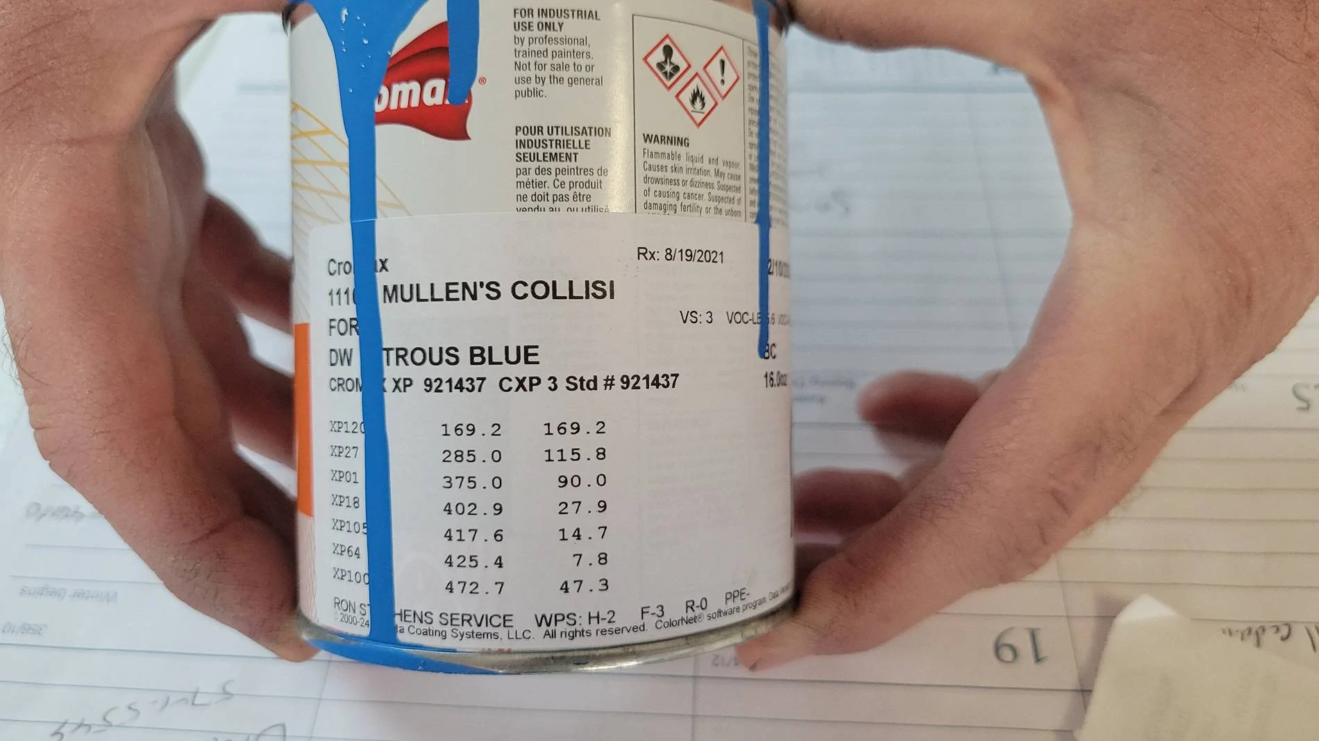

Speaking of color though...Ford, why is my paint not Grabber Blue?
S650 Mustang Greywolfes Blue Baby 20241213_123420
(It's like, one shade off and caused a repaint to actually match)
I'm not mad, I'm just dissapointed.🤣

Interesting question? C1 is grabber blue. The code on the paint label says Dw which is a 3 stage blue, aka Nitrous Blue? 100 percent why it didn't match. F. You'd have to ask them. Someone screwd up.
no youre understanding it wrong, they originally tried with C1, but that didnt match, Nitrous Blue was the one that ended up matching

Ok original fender is steel on the 2024, that's your alignment problem, but I assume you can't get that fender in steel. To be expected. The color issues, this why we blend everything to adjacent panels. It's not the right color for you car. You might see a difference in the sun in different angles but from the pictures it seems close. So hard to paint match with out having the car in the shop.

I deal with this every day lol. Even different paint manufacturers, Axalta, Basf which is Glasurit and Diamont, Ppg, Sikkens, all have different formulas. Blend it or end it. Panel matching colors is not guaranteed by any paint company.
