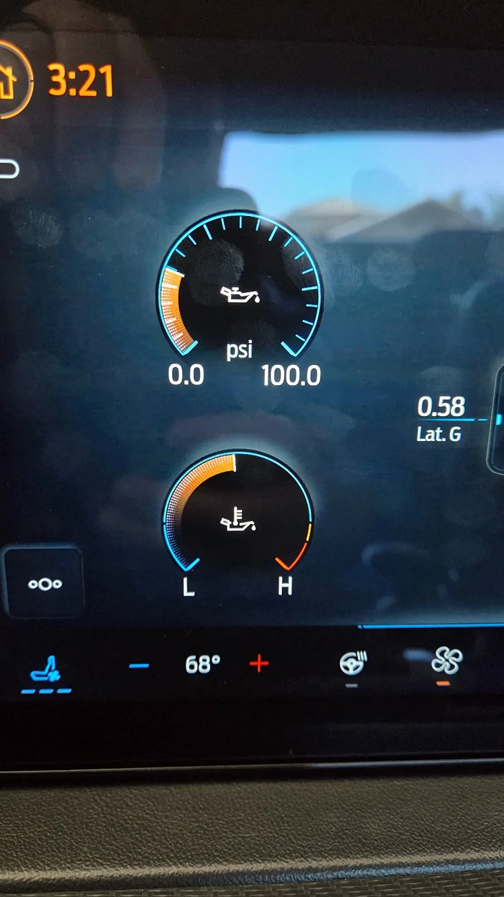

Within the gauge detail screen it shows various temperatures, pressures of vital parts. Seems like a reasonable screen to watch at random times or if romping the machine with smiles. What is normal? What could be considered an average range? What if Murphy just popped into the backseat and decided to F with your Mustang? When should the oh S meter go off?

Without getting into the weeds on each thing individually, I would recommend you turn on your track gauges on the infotainment screen and take note of the blue, yellow, and red areas and then compare those to the actual numbers on the dash.

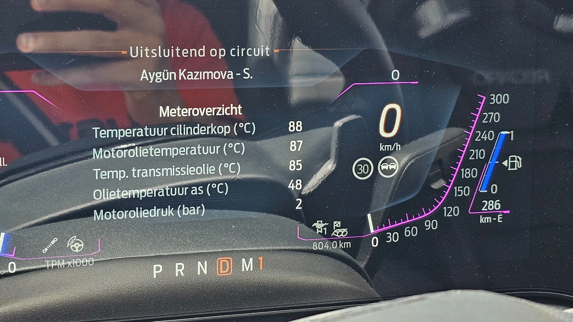

5 different people are going to give 5 separate opinions on whats "normal". There are guys on this Forum that think any oil temp above 200⁰ is hot, which is silly. The yellow area of the gauge starts at 265⁰ which should tell you what Ford thinks. There is data online that says anything up to 240⁰ is normal. The reality is "Normal" depends on how you're driving the car and ambient temps. It will fluctuate greatly depending on how hard you get on the pedal.
I have the same spec car as you and I live in Arizona. My oil temps live in the 215-220⁰ range when fully warmed up under normal driving. Trans temps are usually around 200ish. Heads temps usually stay around 200⁰ or just below. My experience is that during spirited driving temps will go up but fall back down pretty quickly when you back off.
My advice is to drive your car and enjoy it. These cars don't have any inherent over heating issues unless you beat on em. The only exceptions are if you're tracking the car or Super charging it. If so, then get an auxiliary oil cooler or buy a PP car. Otherwise try not to go down the rabbit hole and over think it. 👍🏻
