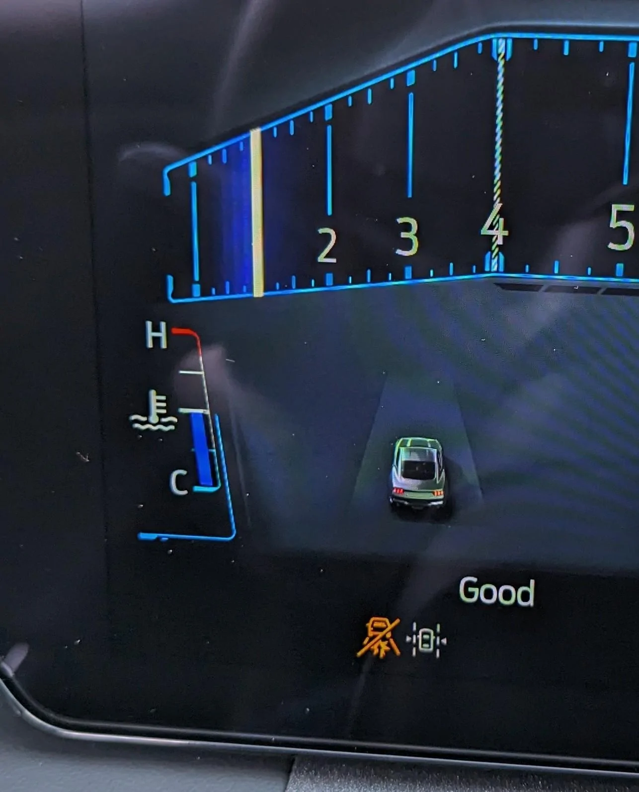

Sorry if it's been asked before.
The orange indicator in the pic .. usually only appears in track or drag mode, but I swear I saw it flash in Sport mode once too.

Haven’t looked in the manual but I think it is the traction control turned off.

Page 249 in the Owner's Manual associates the orange icon the Pre-Collision Assist feature.
While using several of the track and drag-like modes, many of the nanny protections become disabled.

that icon is the one for pre-collision assist being disabled or not available. going into track or drag mode disables it. the once you may have seen it in sport mode, theres a similar icon that shows up in the same place but without the cross through it, that means you are following really close and pre-collision assist is not confident it can completely prevent an accident

I drove in the rain in the dark and had this come up for a few minutes at a time. Then it went away.

I had it appear on a real foggy morning but eventually it turned off. And yes, when your distance to the car in front of you is deemed ”too close” it will illuminate.
