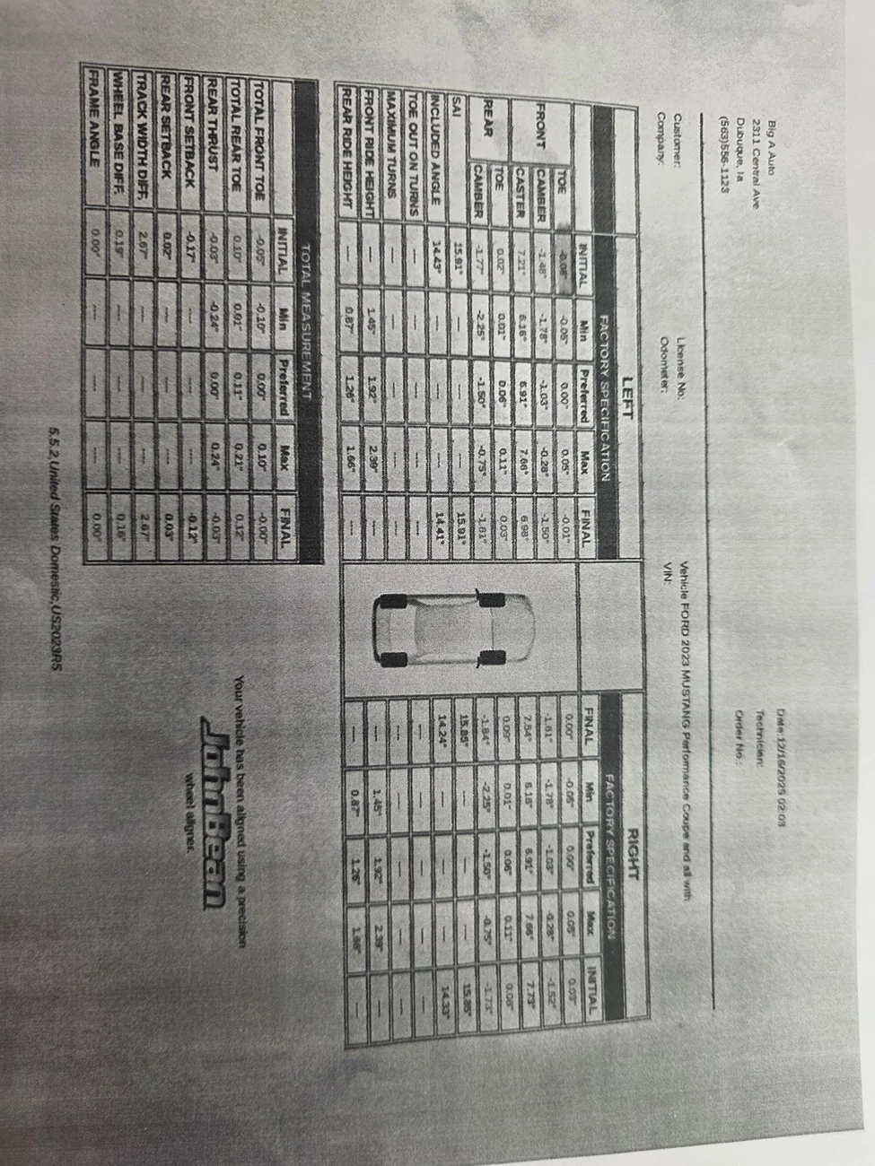

Hello everyone. So, my car slid of the road and had a little damage repaired at a local shop. They had it aligned just to be sure it was not off. It did seem to drive fine for the 50 miles before it went into the shop, however after picking it up it acted weird in their parking lot when a backed up out of the spot. Now for context it was 20 degrees out and I have the PP summer tires on the car and just though maybe it was that so I drove home. It has been sitting since because of the weather but even moving it into the driveway for the heated garage it still does the tire bucking thing. I stopped at the place that did the Alignment and he gave me a printout of what they did. The first thing I notice is that it says for a 23 Mustang and not the 24 Mustang GT PP with magneride that mine is. Not sure if that really matters or not, but here is what he gave me if some of you know how to read these specs. Thanks in advance, Jason.

As you mentioned, they attempted to dial in a 2024 Mustang using 2023 specifications. IDK if the cars use the same specs or not. It could be their machine or software controlling it that has yet to be updated. Or they didn't know it was a '24. You're paying for a 2024 to be measured, by a machine that can.
While many of the settings are within the 2023 band (FWTIW), they're at the edge of the band. If I'm paying for an alignment, I expect to get it dialed in near the middle, the optimum, or very close to that. Not a "good 'nuff" setting.
While more expensive, I'd return the car to a Ford dealer and have them perform an alignment. While there, they can inspect the drivetrain and discuss what you're hearing and feeling.
That the car drove fine before entering the shop, and now a noise or condition, coupled with the '23 reference and sloppy settings, doesn't give me a lot of confidence in the work that was performed. I would not return.

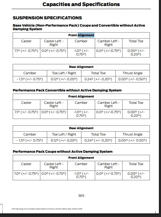

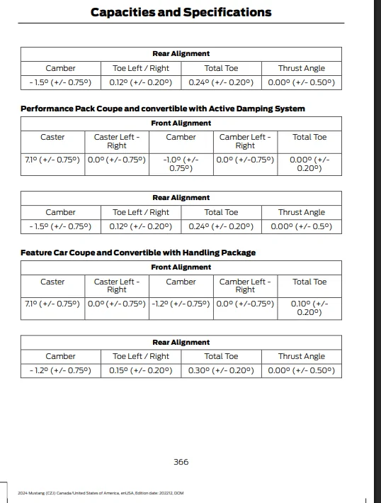

Here are the specs from the owner's manual for a 2024.
S650 Mustang Fresh Alignment after car slid off road, now car bucks in the front turning slow in parking lots Screenshot 2026-02-05 204328
S650 Mustang Fresh Alignment after car slid off road, now car bucks in the front turning slow in parking lots Screenshot 2026-02-05 204311
