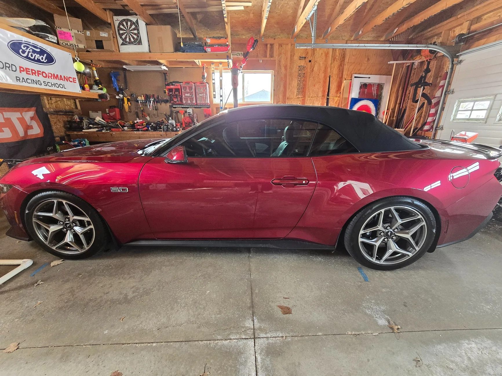

I have an appointment set for alignment after installing steeda progressive lowering springs.
I tried looking this up in the forums but is there anything I should say or specifically express to the shop to get it dialed in?
I know I need them to tinker with camber and toe but I really dont know what specifically to tell them.
I sound like a noob with this post, sorry about that.
Chat gpt said not to get it back to factory spec because the suspension is no longer factory.
I appreciate any input. Thank you.
