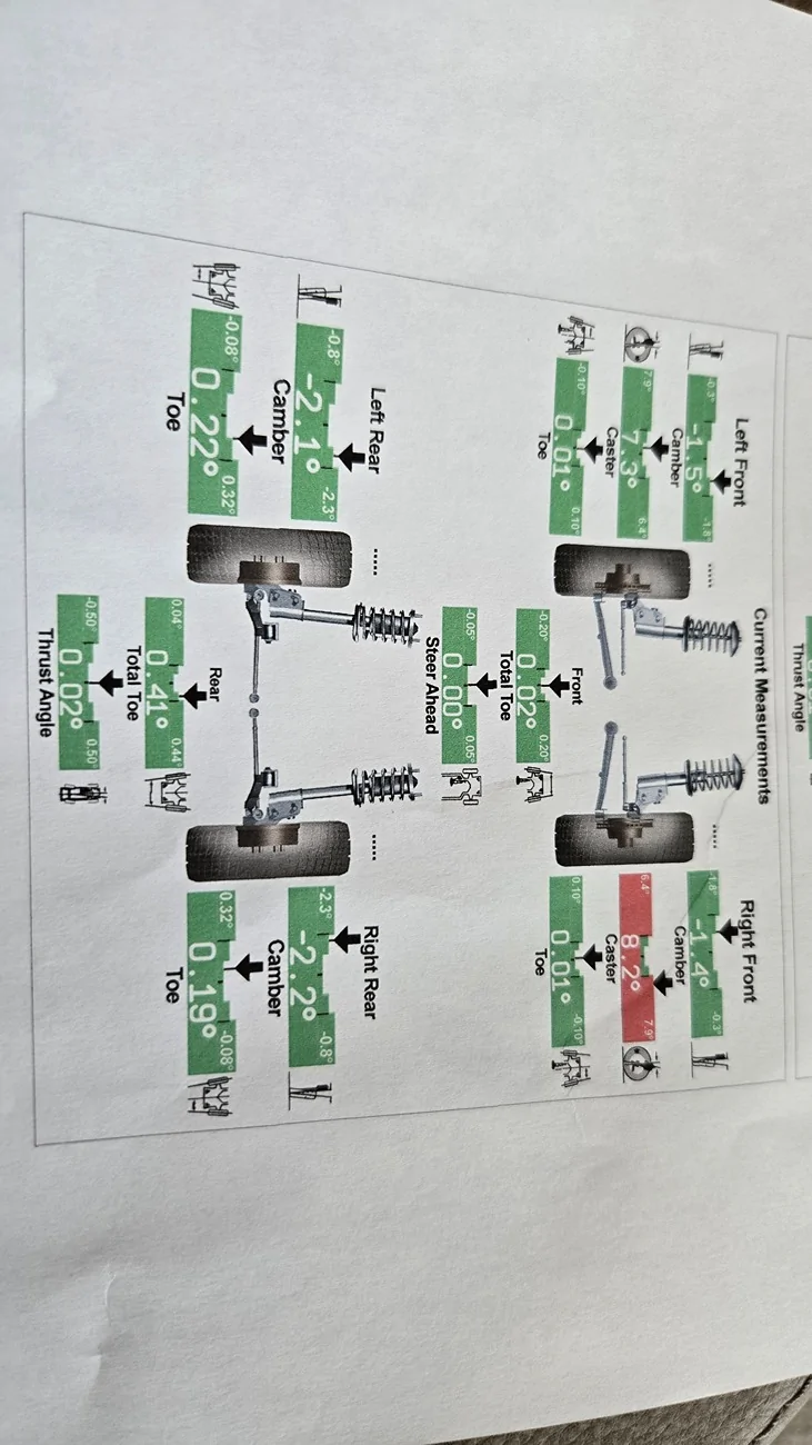

Hello all, I got my 2024 mustang installed with the 1" lowering kit by the Ford dealership. Isn't the rear toe very high, there's no camber plates installed nor toe adjustments.

There are toe adjustments in the rear... as well as camber... those could be better. The caster being that far out on one side is a bit of concern though... not much too be done there without camber/caster plates.

Agreed with sofa on the caster.. something is wrong on the machine setup or something on the right side. The rear toe and camber can be adjusted.. currently your toe is a lot over recommended. front camber is close and is adjustable with bolts or plates but with your tie you should be fine . Take it somewhere that will want to get it right not just show you where it’s at…

I'm gonna call up that Ford dealer again tomorrow, explain the situation and maybe the tech will care and fix it.
