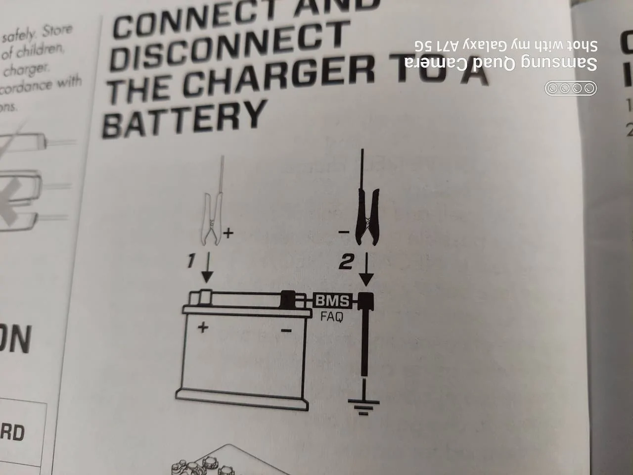

I use tenders on all my vehicles, the mustang drains the battery just sitting there pretty fast. I've just connected the tender to the battery terminals directly. I plug it in periodically as I don't drive far enough daily to charge. In the winter it gets plugged in every week or 2. Is there a reason not to connect to battery directly???
1,732
2,701
≈39N
Doing so can interfere with Ford's Battery Management System (BMS).
Within the first page of this thread, post #9, is a document. There are two sections: 1) "BMS" and 2) "Charging Strategy"; these help explain how BMS works and how tying down to the battery directly can interfere with it.
When directly connecting to both the (+) and (-) battery terminals with another source of power, the car is often unable to properly interpret the state of the battery and the charging system. Short-term, a one-off, is not necessarily an issue. Long-term, it can become one.
Attached to this post is a logical diagram and part of the instructions to install mine, on an S550.
In my setup, I connected the red lead of the tender to a specific post on the under hood fuse block; this ties directly to the (+) post of the battery. Connecting in this way IMO more pleasing to the eye while also keeping that lead out of the way and safe from other activities.
The (-) lead of the tender goes directly to the chassis; as the electrons make their way back to the battery, this connection allows the BMS Hall Effect sensor to see and account for them. Tying directly to the battery and seeing an additional source of power from that direction, the Body Control Module (BCM) could believe the battery was actually discharging.
Taking a step back from all that, I've connected tender leads in a manner consistent with jump-starting the car: (+)-to-(+), (-) (donor car)-to-chassis (acceptor). One of the reasons this is done is safety: sparks in the area of the battery could ignite any hydrogen gas exiting the battery case. Another is so the BCM and Powertrain Control Modules can continue to reference the charges and discharges correctly.
