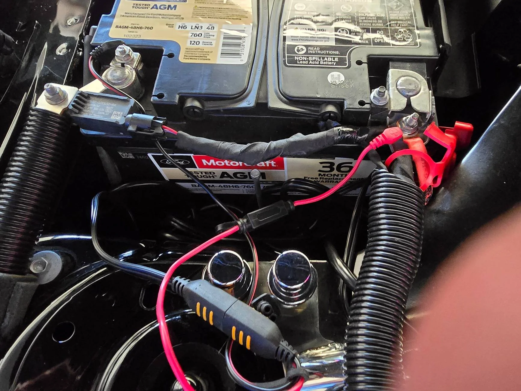

According to the link:
  • Positive Connection: Use the red plastic-covered terminal near the black fuse box. Alternatively, some users attach the positive lead directly to the positive battery terminal..
To avoid connecting to the wrong place, I'm going to connect directly to the positive battery terminal.
I have my F.P. Battery maintainer + lead attached to the terminal under the red plastic cover to avoid bypassing the onboard battery management system. In addition, I have my Whipple Supercharger intercooler pump + lead attached here as well per Whipple directions. Both grounds are connected to the ground post on the passenger side strut tower.

I believe connecting directly to the battery you are going to effect the BMS(battery management system).You will charge the battery but not ideal. Use the suggested charge points Ford recommends. Use the stud on the right spring tower and the blade under the red plactic cover. If you change out the battery to a new one don't forget to reset the BMS.

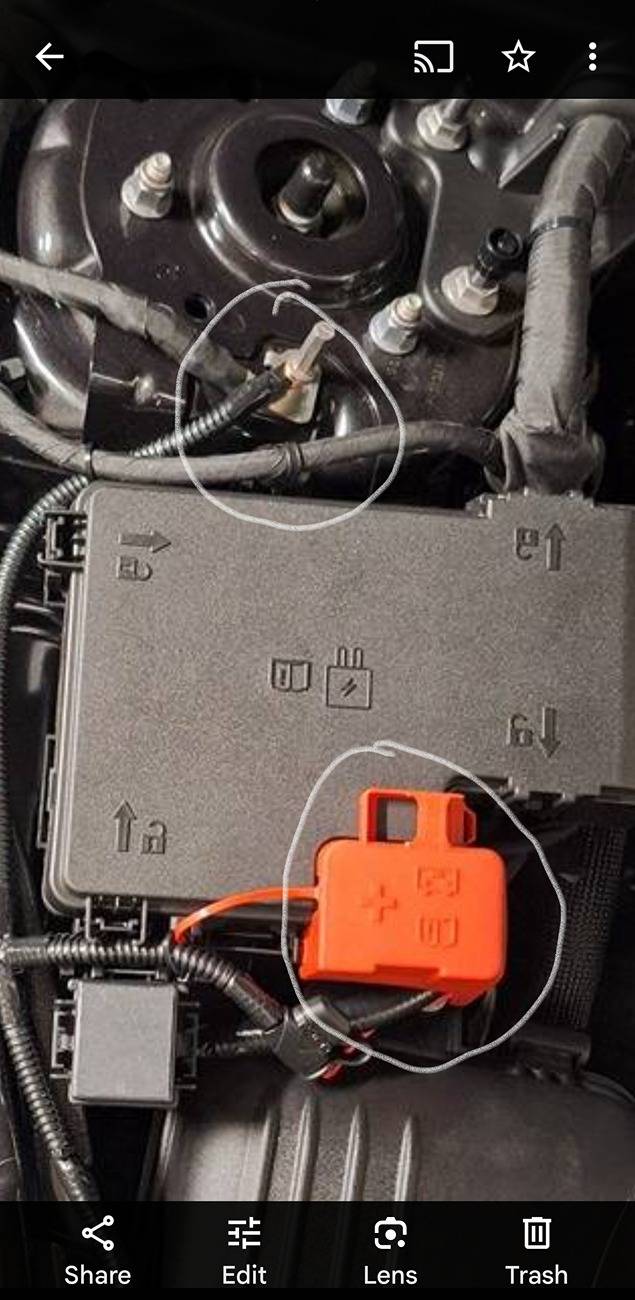

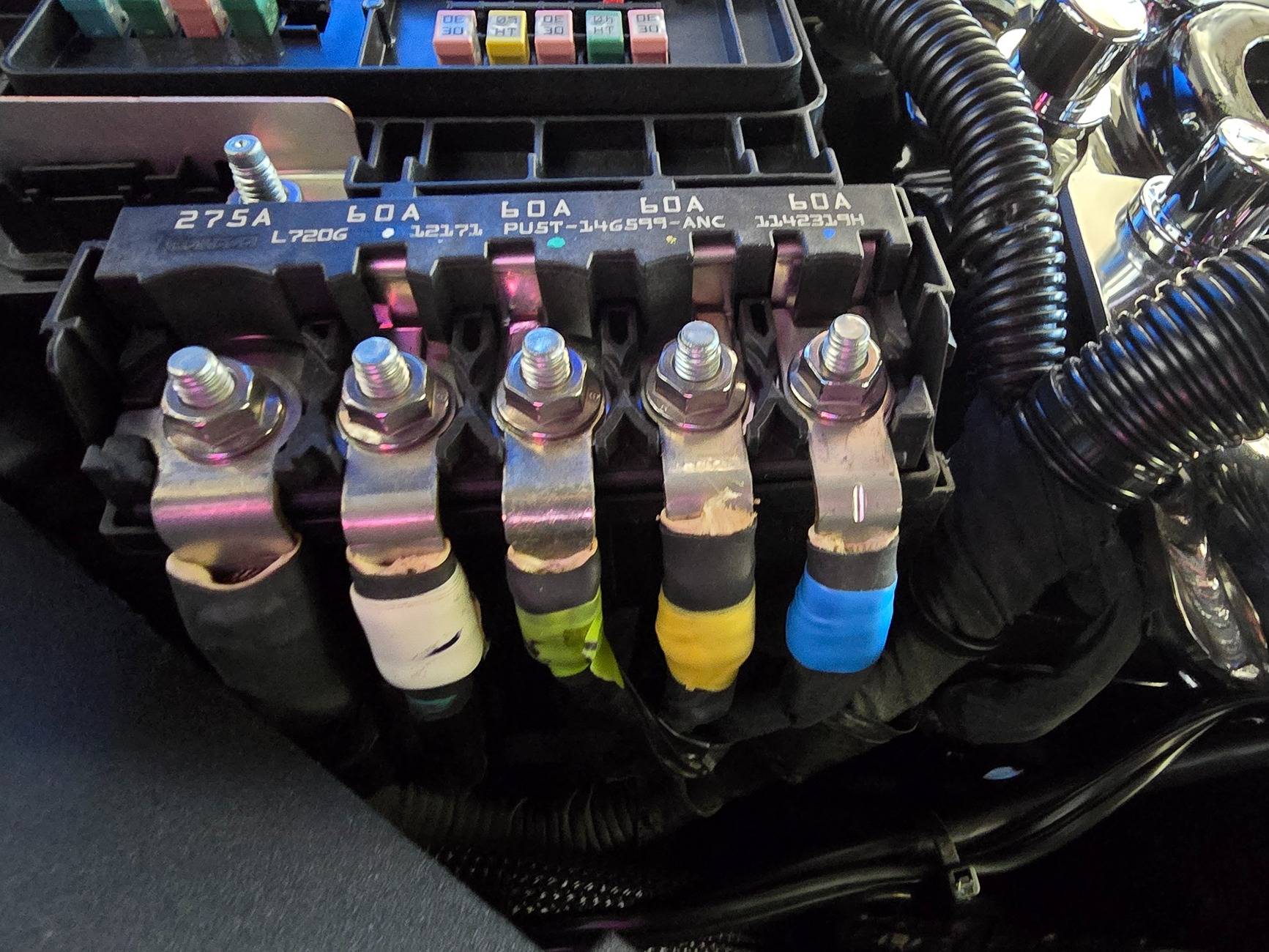

You have lost me... "Ford Charge points": okay, are they in all photo 2? "Use the stud on the right spring tower" What is this tower. You are telling me to attach the maintainer to the power connection under the red plastic cover. Do I still connect the ground cable to the battery ground stud? I haven't changed out the battery but for the record, how would I reset the BMS? Sorry for my ignorance.
RevMatch
May 17, 2025
Abbotsford, BC, Canada
Passenger shock tower negative grounding stud and fuse box positive post.

Under the red cover you will see a verticle metal blade. That's the positive.
