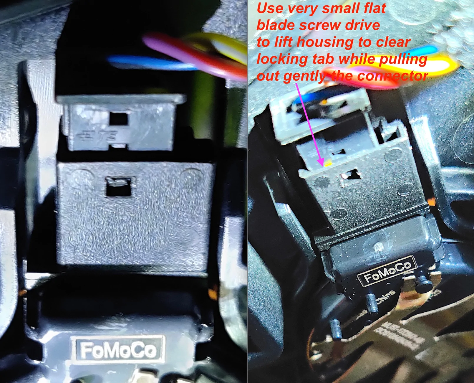

I am in the middle of installing mine. It has been a real pain trying to pull the plug out of the sensor. Any suggestions?
You need a very small screwdriver that can push down the connector locking tab. See picture attached.
S650 Mustang Fitcamx Dash Cam Rain_sense_con

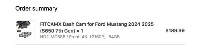

That looks fantastic... Which version did you order and did you order any of the options with the basic camera?
2024-GT-Vapor Blue

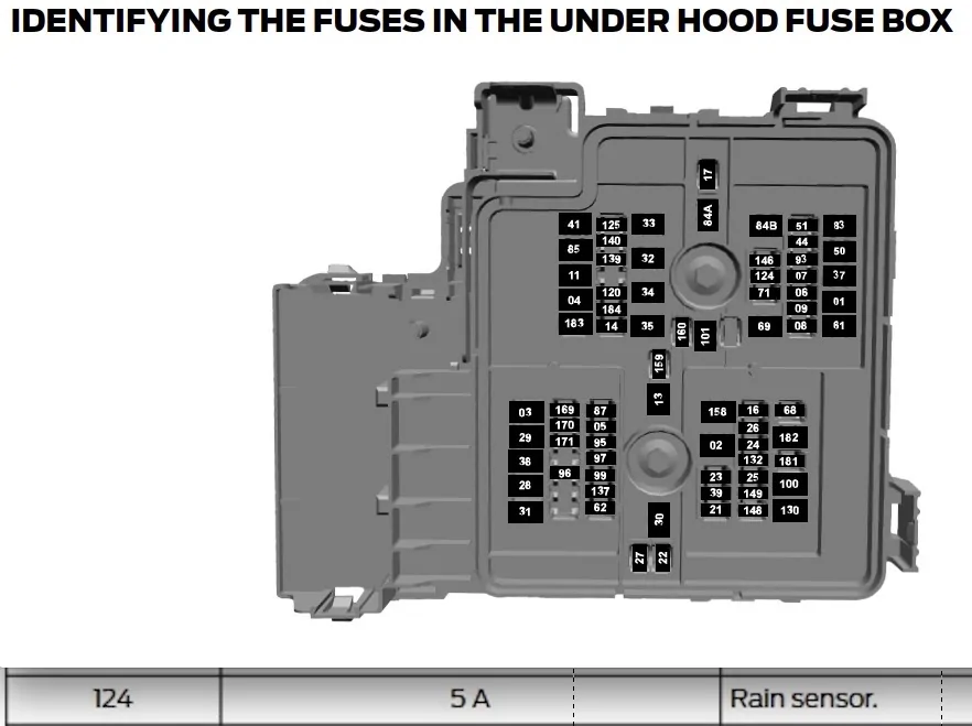

The rain sensor uses a 5 amp Fuse (#124). The only way to check the current draw of the sensor is to remove the fuse and place a DC amp meter across the fuse terminals and measure the current while the rain sensor runs (spray water on windshield). This would provide info how much spare power is there before the 5 amp fuse blows. Then you need to know how much power the radar detector takes to make sure you are not exceeding the total 5 amps before connecting to the rain sensor wires.
S650 Mustang Fitcamx Dash Cam RAIN_FUSE

Thank you for the information. Im wondering if anyone has used the fitcamx and then used the rain sensor for radar. Does the fitcamx use the rain sensor? If so then it would have to power both?
