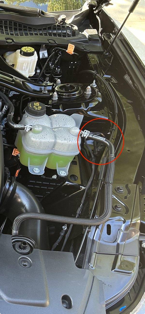

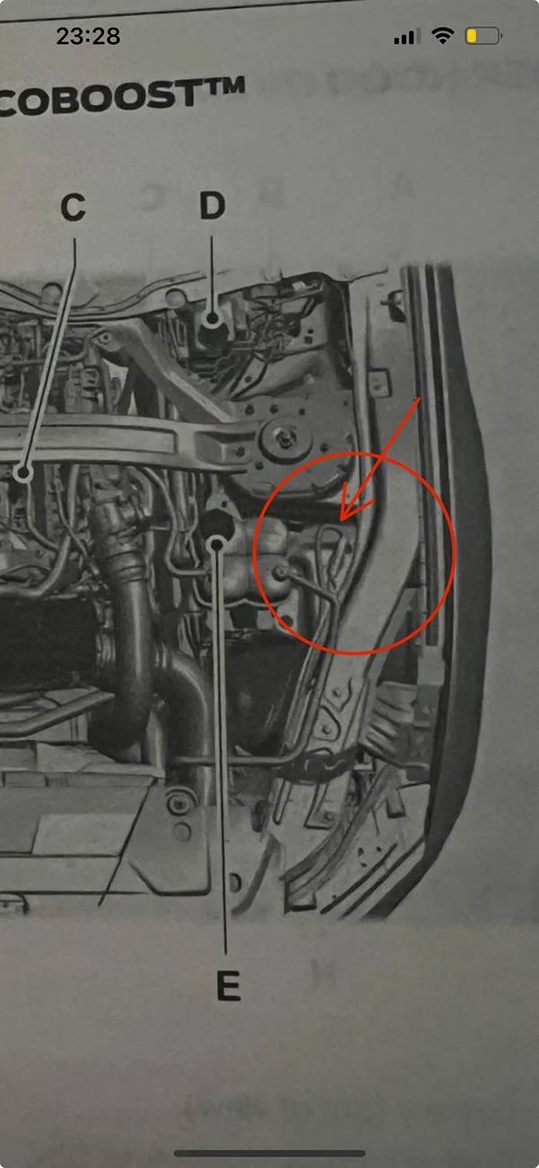

Who knows what these wires are for? By default this connector is isolated, have checked all the photos in Google, but still can’t identify what it can be used for…

My GT has that - just noticed it when looking at the engine. I was thinking it's a diagnostic port or something similar.

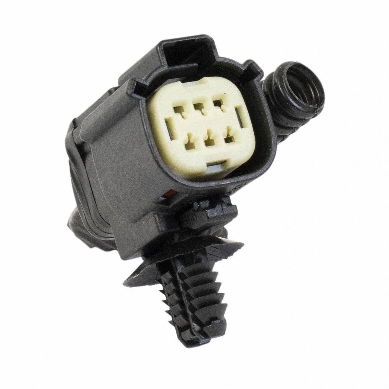

Maybe someone bought this part separately? Mine is a bit broken, wanted to buy a new one but can't find it anywhere. Is there any other «official» name for it? Maybe 6gen has the same plug?

That looks like the Dyno plug which is located atop the left inner fender. All it does is jumper a few wires together. Remove it, and several sub systems stop working (tractions, control, stability control, etc.).

Yes, it is a Dyno plug, I just wondering if I can order a new one, as my is a bit damaged. I have spent already 2 days trying to find out if Ford sells it separately or to get at least 1 piece on EBay, but still not found where to order..
