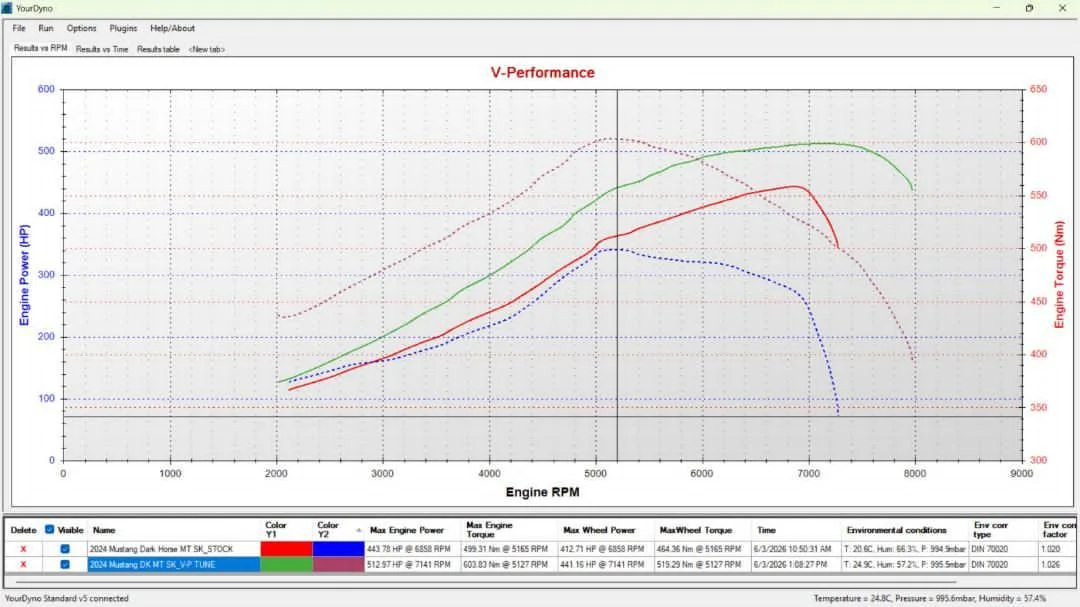

Was looking at an upgrade to try to claw back some lost horses a I have a UK Dark Horse with 450hp. Not ready to spend 10K+ on a charger ertc right now and I saw this:
https://hooniesadrenaline.co.uk/pro...OarMU-mnnCFyMHQCFgLkUf6pGnQBiHpZVfAco5cuAhdZV
But, it seems almost too good to be true, I mean an extra 82hp with no hardware?
Would love to hear some opinions.
I had a tune done on my GT (Australian specs) with no hardware and apparently I gained 30kW, so roughly 40hp. Graph is in the other thread.
82hp doesn't seem realistic.
Did you gain engine horsepower or wheel horsepower? That's a major difference.
