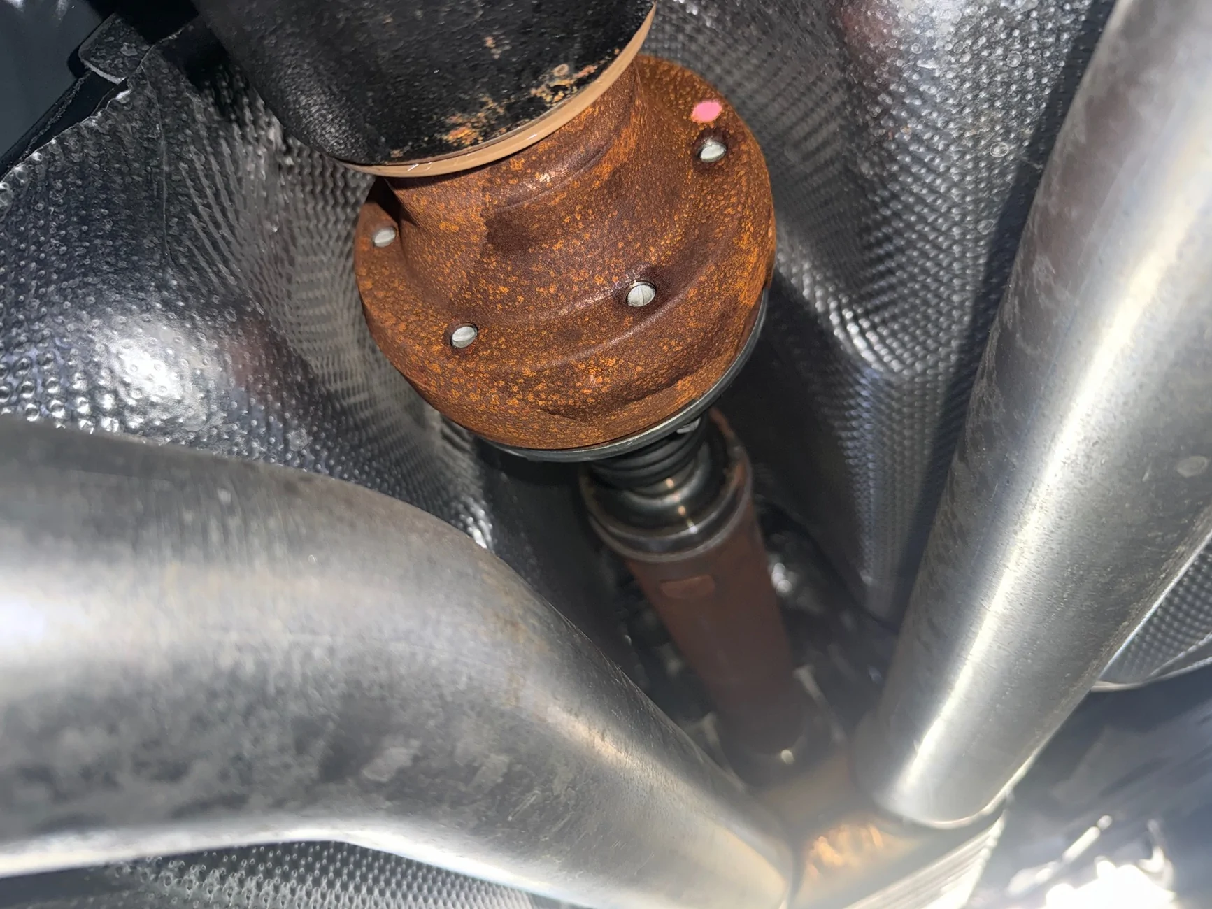

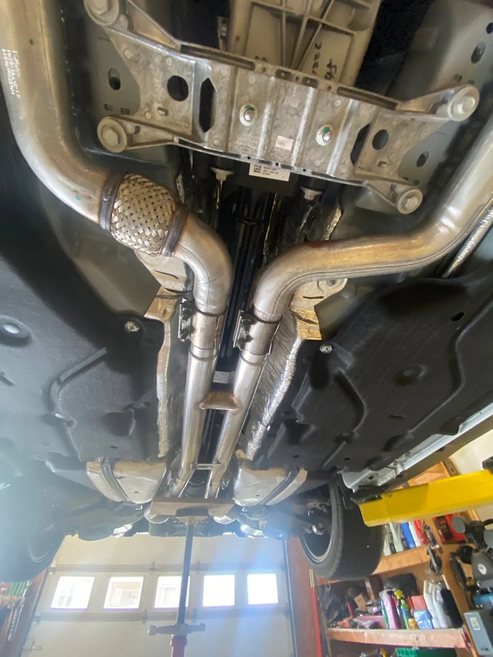

So was recently underneath the car and saw that the driveshaft is rusted really bad. I’ve read and this seems to be normal, but just concerned with longevity and was wondering if others have seen the same and/or have done something about it. To note, I ordered the car new and only has 4k miles on it.

It's bare metal. You could have put clearcoat or something on it when it was new

Yes, normal. Not great looking but common. Don't try to paint is as you could unbalance it. I had an ocd friend who wiped it with machine oil. It did look better and may retard the rust. If your differential isn't painted it too will rust. Many leave the factory or more likely the staging lots like that.

Good reason to buy an aftermarket one

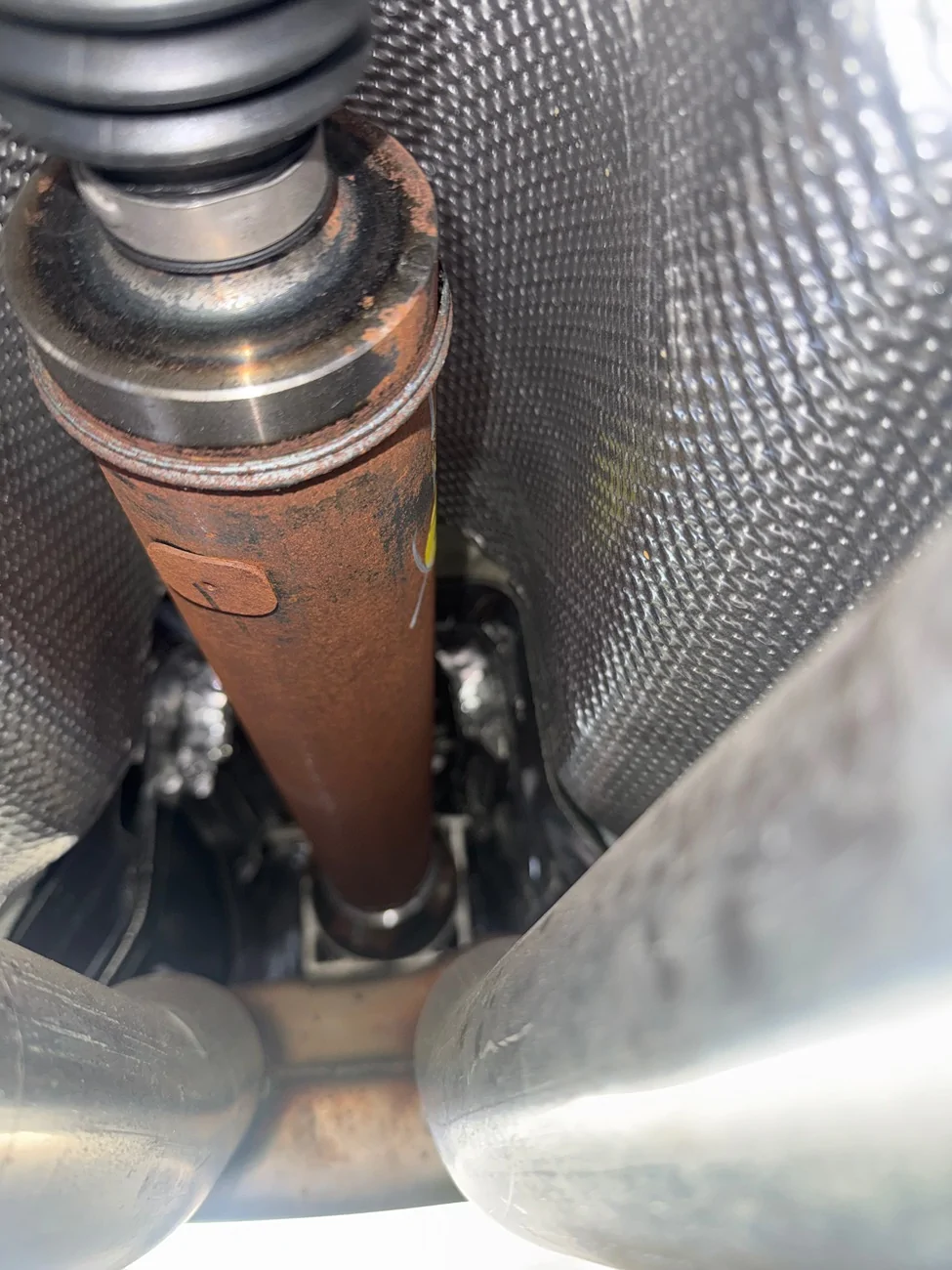

@Idle0024 ..... regarding an aftermarket drive shaft. IMO NO. The rust won't hurt anything, painting or coating it won't improve anything and might unbalance it. A friend bought a very expensive aftermarket drive shaft. After three replacements due to vibration he went back to the original. I had a 2014. The drive shaft rusted. I sanded, primed and painted the differential to make it look better BUT left the driveshaft as it was. In 2024 I sold the 2014 to a friend when I bought my 2024 GT. The 2014's drive shaft, with the surface rust, is still just fine. Respectfully, don't go looking for problems. The 2014, now 12 years old and still drives awesome with no driveshaft problems.

I'd treat the rust and paint it. I very much doubt a coating or two of paint will cause an imbalance in rotational forces on such a small radius. If it did, just strip the paint off.
