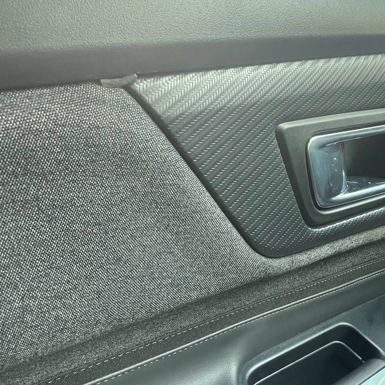

My driver side door also rattles. It goes away if I lightly hold my finger against on the door card, but doing so while driving is unsafe... For now, I have a small piece of MLV (mass loaded vinyl) wedged between the plastic piece that runs across the top and the plastic piece surrounding the door handle. I'll try to post a picture soon.
