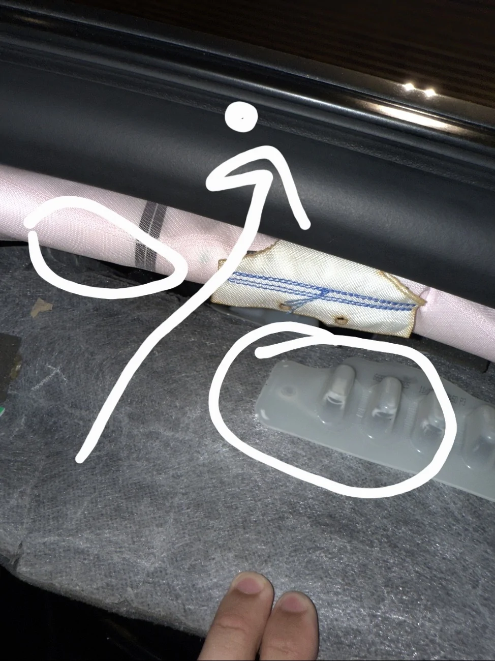

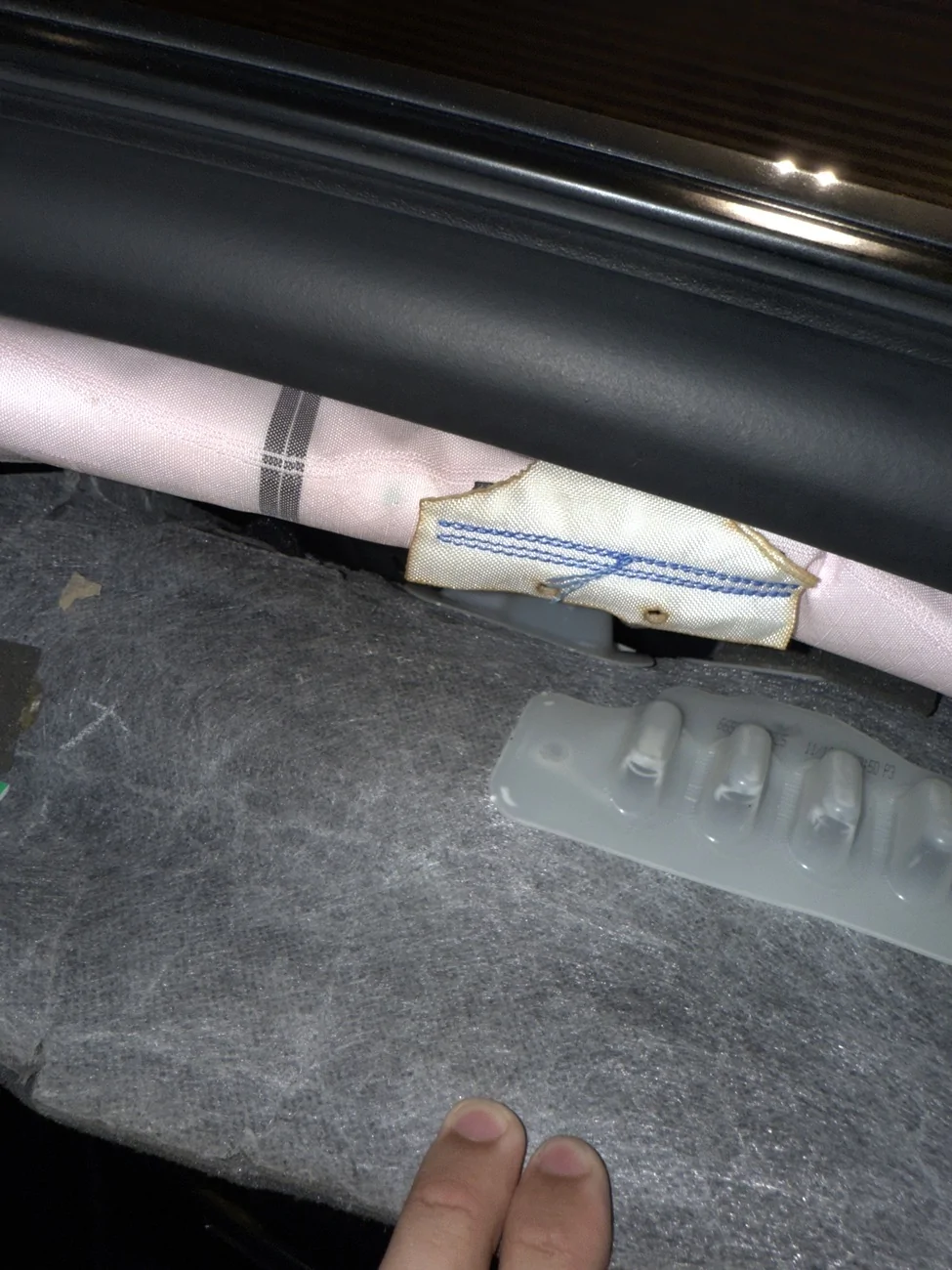

i was able to remove it, can you help me locate it with this photo?
you need to pull the headliner down on the left side. To do this, you need to remove the sun visor on the driver's side, the left pillar trim, the left central pillar trim. This way you can see the airbag mounts, the clips that attach these airbags to the car body. Seal them with electrical tape. On the headliner itself, there are plastic teeth that press the headliner to the roof. The weld fragment was under this plastic and rolled around when the car was moving.
and also what do you mean by "under" the plastic
S650 Mustang Rattle/Creaking above head drivers side IMG_0168
under these inserts. In my case, part of the weld that came off was under this plastic behind the airbag closer to the center of the car. The clips are on the other side of the airbags.
